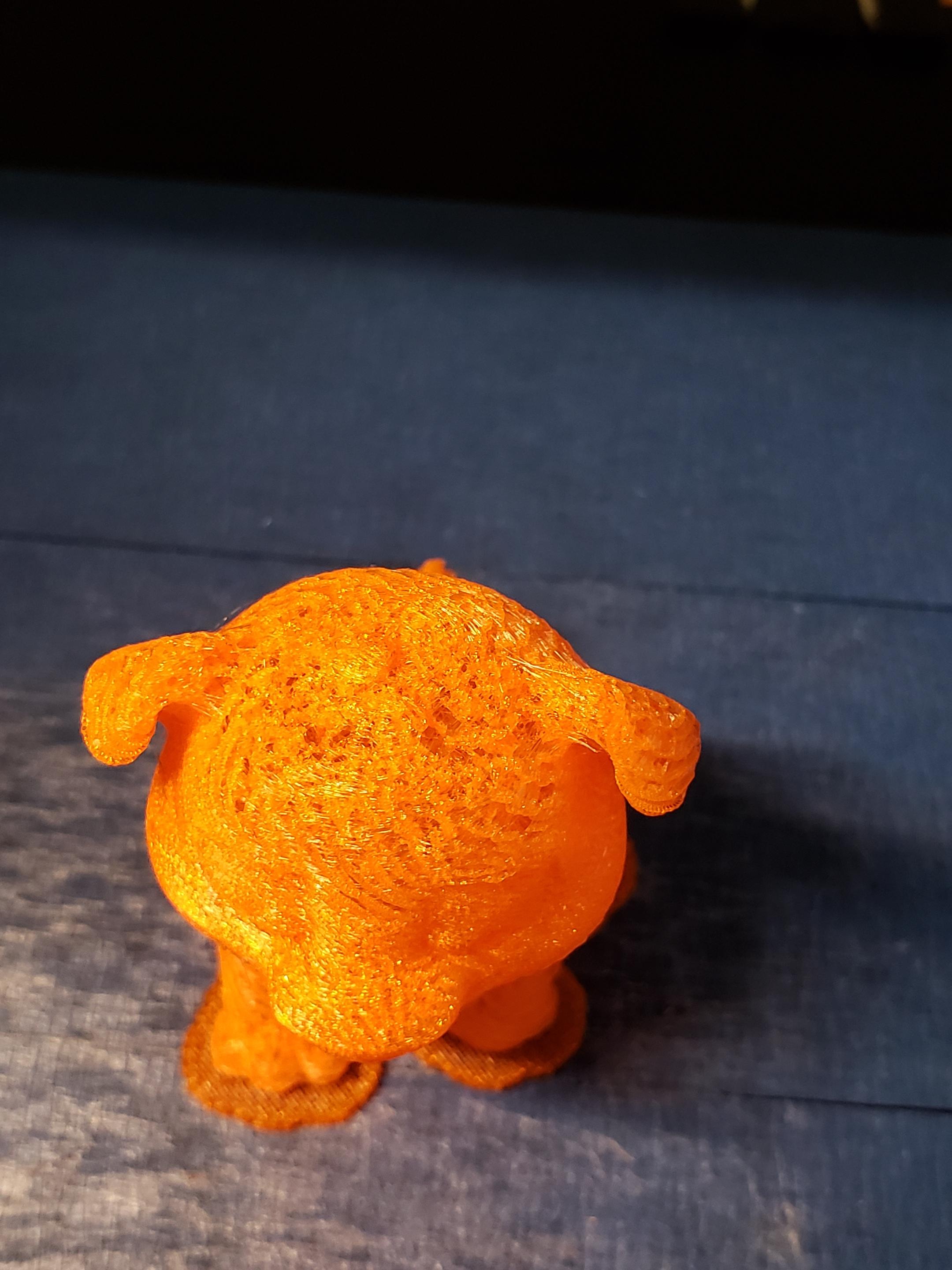

Hi everybody, I'm completely new to 3D printing. Bought my printer about 2 months ago, and able to print a couple of small pieces by downloading model. However been having problem lately. 1. 1st layer didn't stick, tried different tricks and kinda working but not quite as good .now the biggest problem is filament between layers look terrible. Can anybody tell me what could have cause this.

I would agree with Alvero, looks like you have a loose belt on one of your axis, only other thing I could think of quickly is that you may have a partial blockage in your hot end.
Is this kind of consistancy in the print all the way through or only on shell layers? Could be a slicing issue, you can eliminate that by going back to your origional sd card and try to print the dog. It's a longer print but will tell you pretty quickly if you have a mechanical defect or a slicing issue

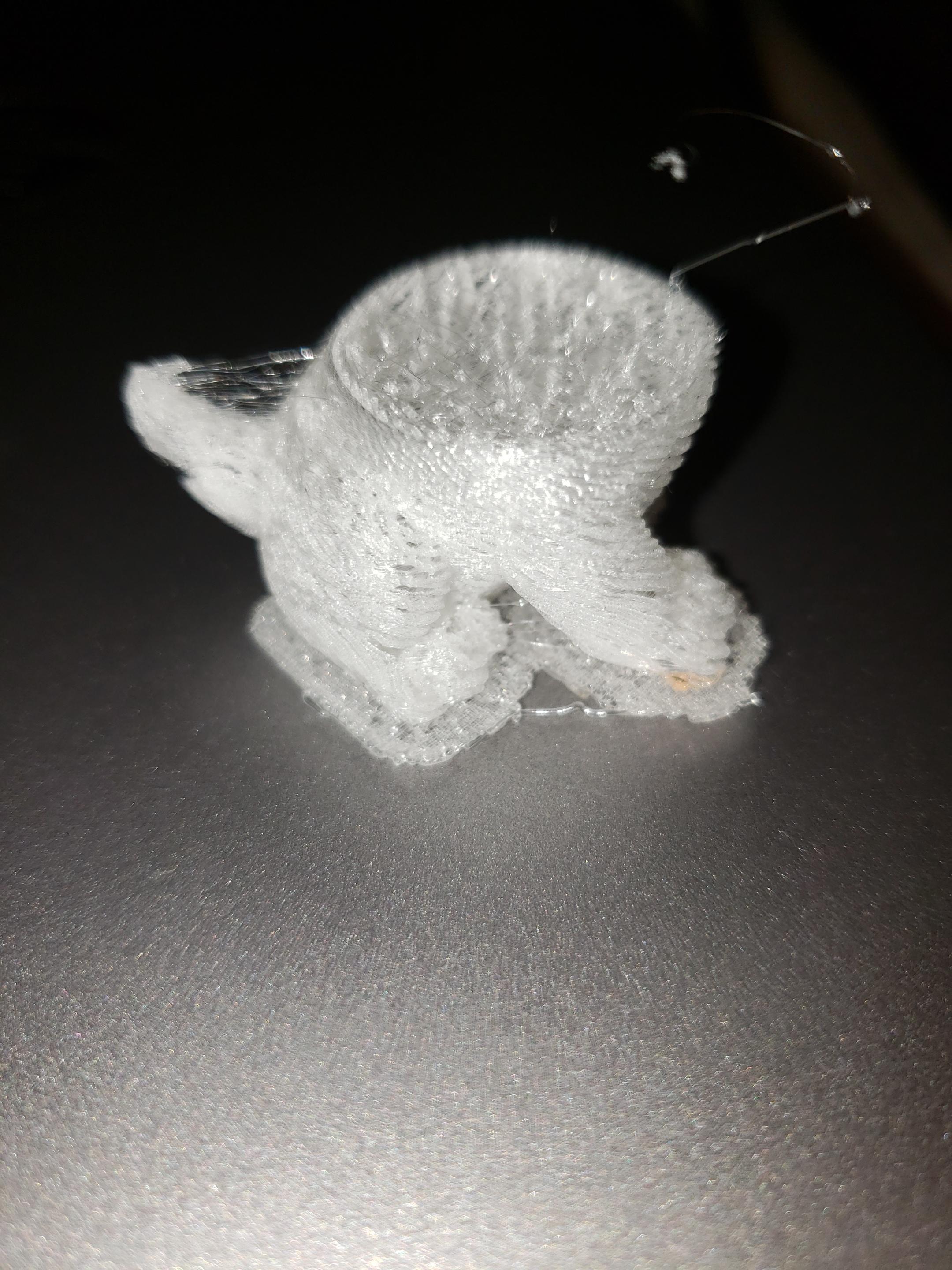

Just tried to print the dog from the file came with the printer. It was a disaster. Didn't even finish it
Is it possible the nozzle is damaged?

The dog is a good slice. You have mechanical issues with your printer,
Looks like it was sticking to the bed ok, at least for now you can rule it out.
Have a quick look over the belts, they need to be tight enough so that there is no chance of slipping. However not to tight to cause binding on the idlers. If you move the x axis all the way to the left, if you pickup the x belt gently it should deflect no more than 5 to 10 mm. Any more than that and it's too loose.
Going on the assumption here that your print right before the blue one was ok?
I'm still leaning toward a clogged nozzel though or your ptfe tubing has slipped in the fitting. If you heat up the nozzel maybe 230, let it stay warm for about a min, attempt to extrude 50mm of material through the nozzel, if your extruder motor starts clicking you for sure have a clogged nozzel.

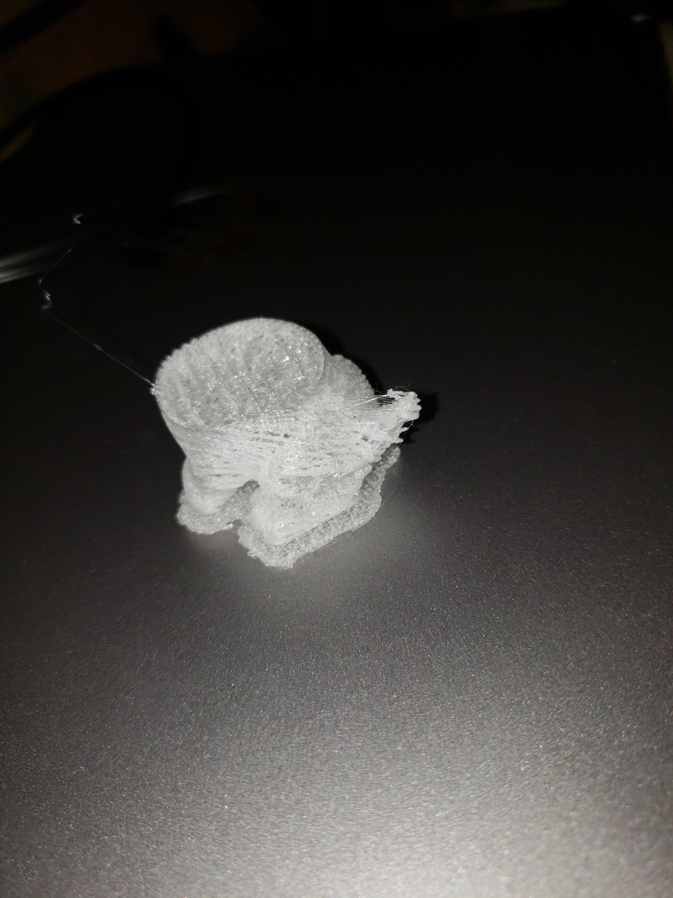

Was able to change the nozzle, and also raise the bed to be closer to nozzle. It looked like the 1st layer went on better. However when try to print the dog, still didn't turn out good. I guess one problem at a time
Ok, this really looks like z axis stepping issue to me. I'm not sure about your Ender 3 pro, but the z axis on most printers can have different values of twist. this looks like you are getting too much space between layers. either your software is set to too large a layer height for the nozzle diameter or the software is set up for z axis rod that has less height per rotation. the only other thing is the stringing and crooked layers could be due to to high temp on your hot end. what nozzle and layer height are you using?
Please also try and print a known model like a benchy to see if it comes out different.
Thx Mark. I believe my nozzle is 0.4mm and layer was set at 0.12 with all other models that i sliced. but this dog was printed from the file that came with the printer on the memory card. does it mean it could be the settings of the printer itself on top of slicer setting?

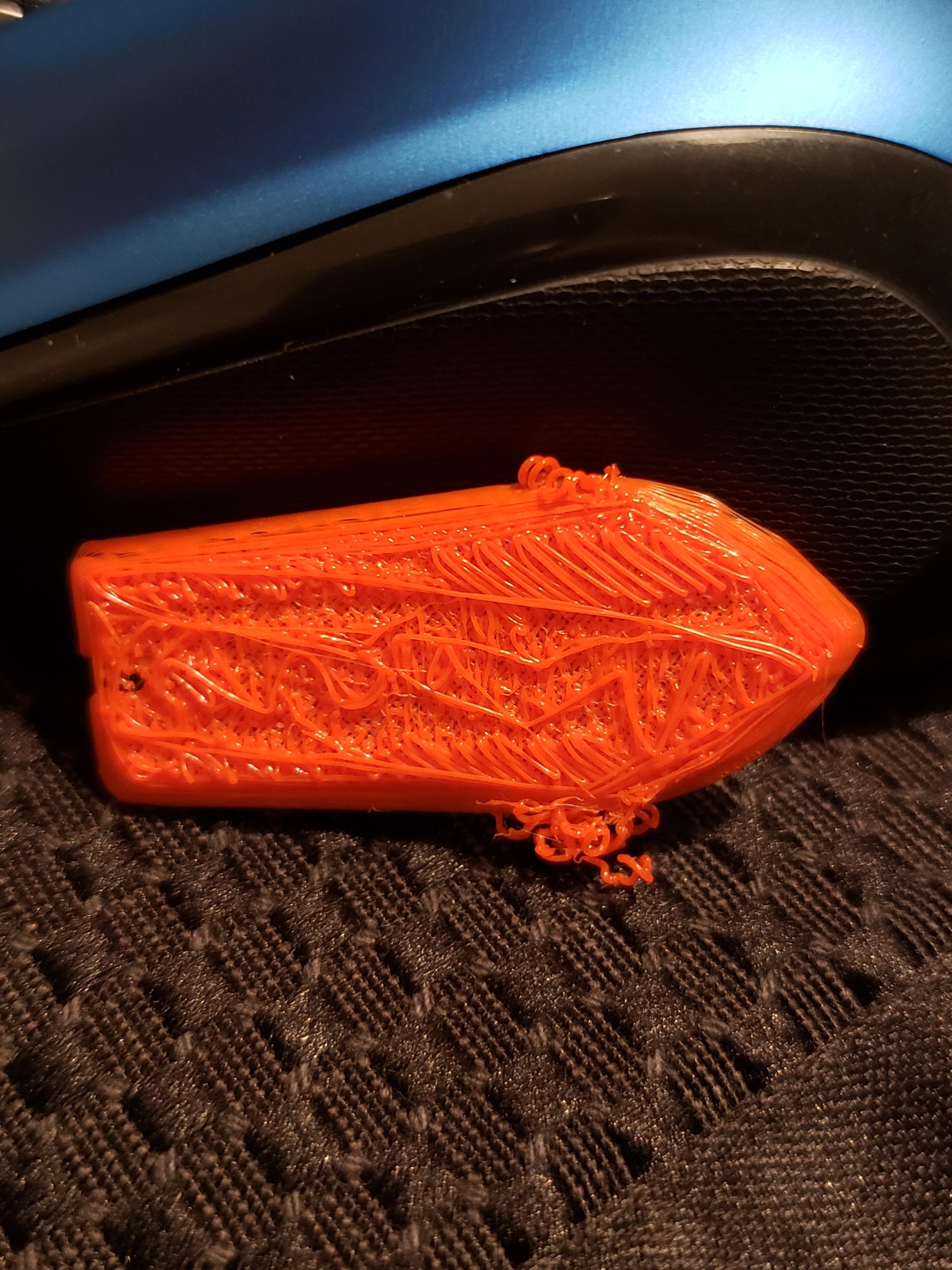

Failed. Looked like the raft went on very nice, but 1st layer on top of it didn't stick. My slicer gave it supports, none of the support sticks and also 1st layer of the boat looked like this after raft taken off
What seems like the problem?
