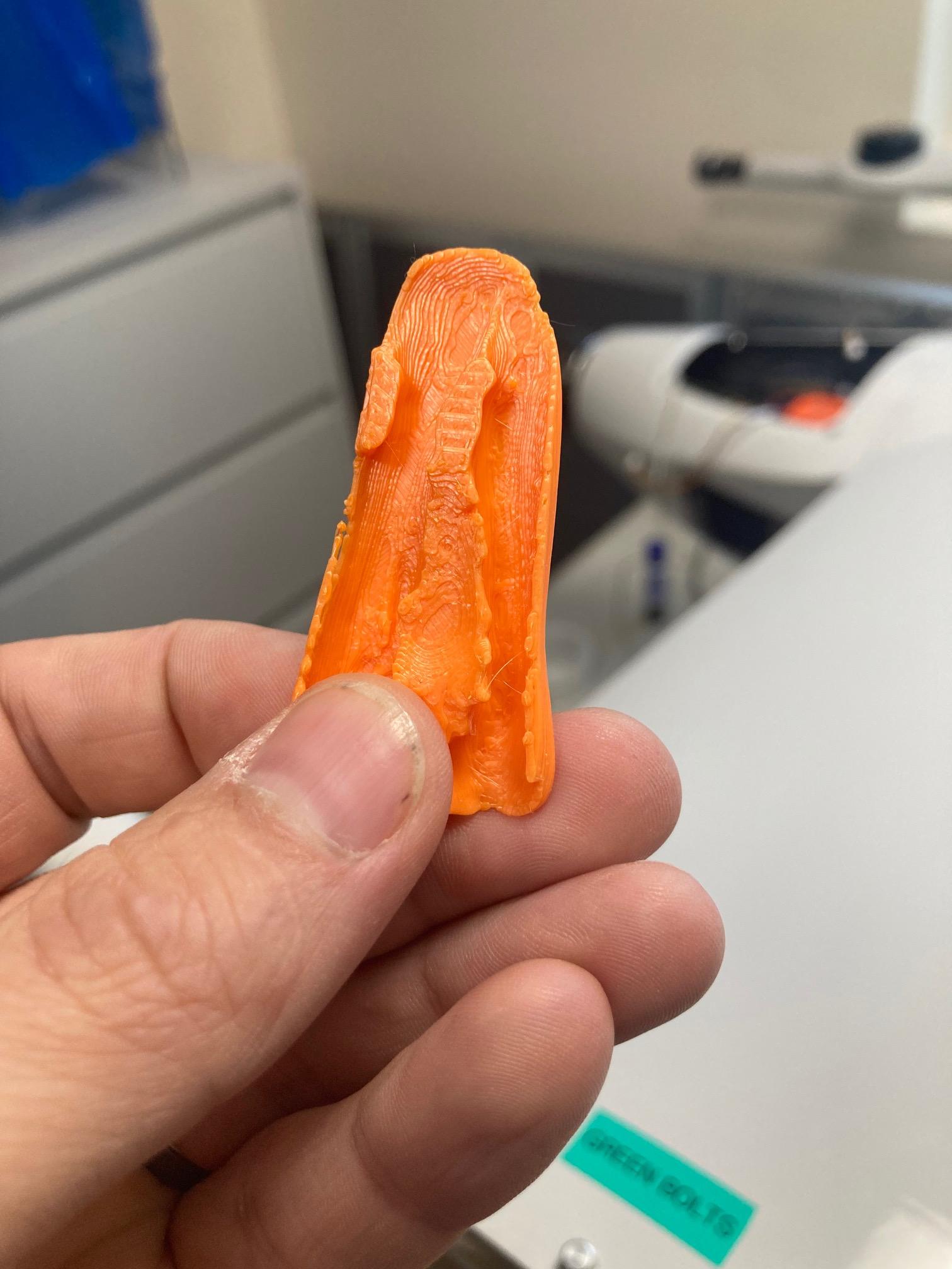

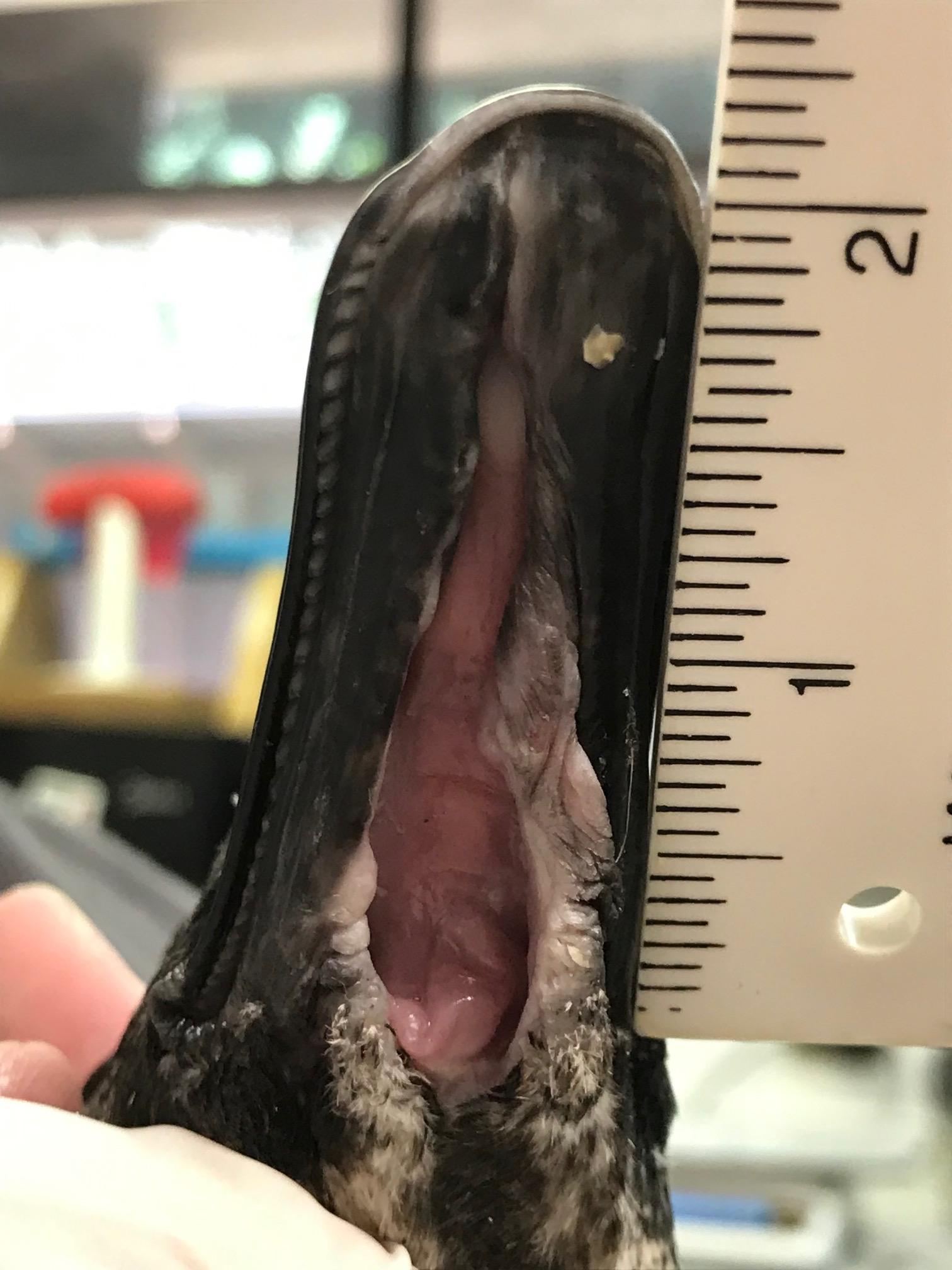

Like Jan said, it is better to use a program designed specifically to handle mesh. Take this with a grain of salt as my experience is limited. I was approached by a local wildlife shelter to see about 3D printing a prosthetic beak for a goose whose beak was torn out by a fishing hook.

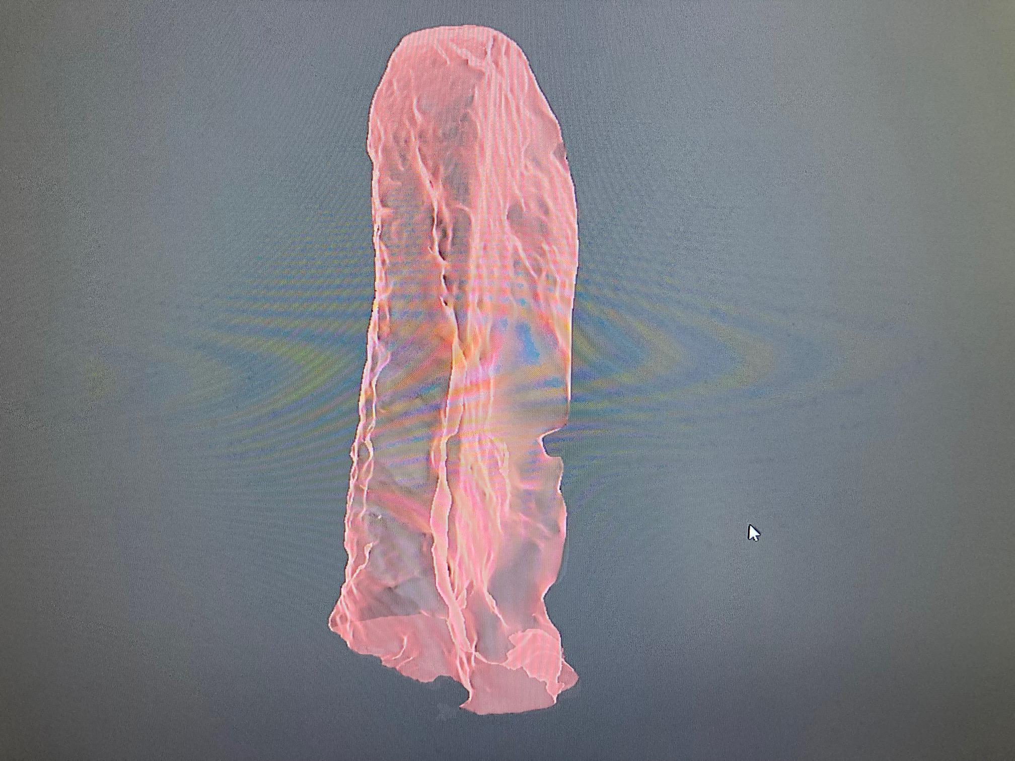

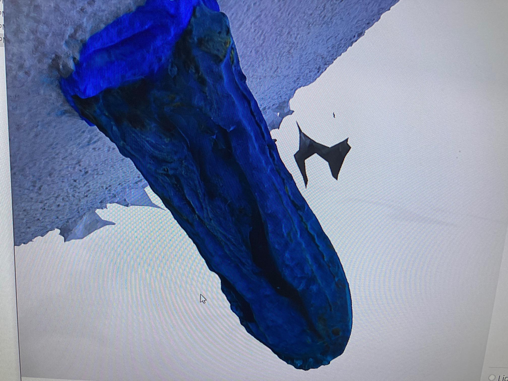

For scanning we used photogrammetry. All it took was some good lighting, a decent camera, and a way to move the object as needed while keeping a fixed distance. We then compiled it in a program like 3DF Zephyr. The result was actually better than expected and required minimal cleanup in MeshMixer.

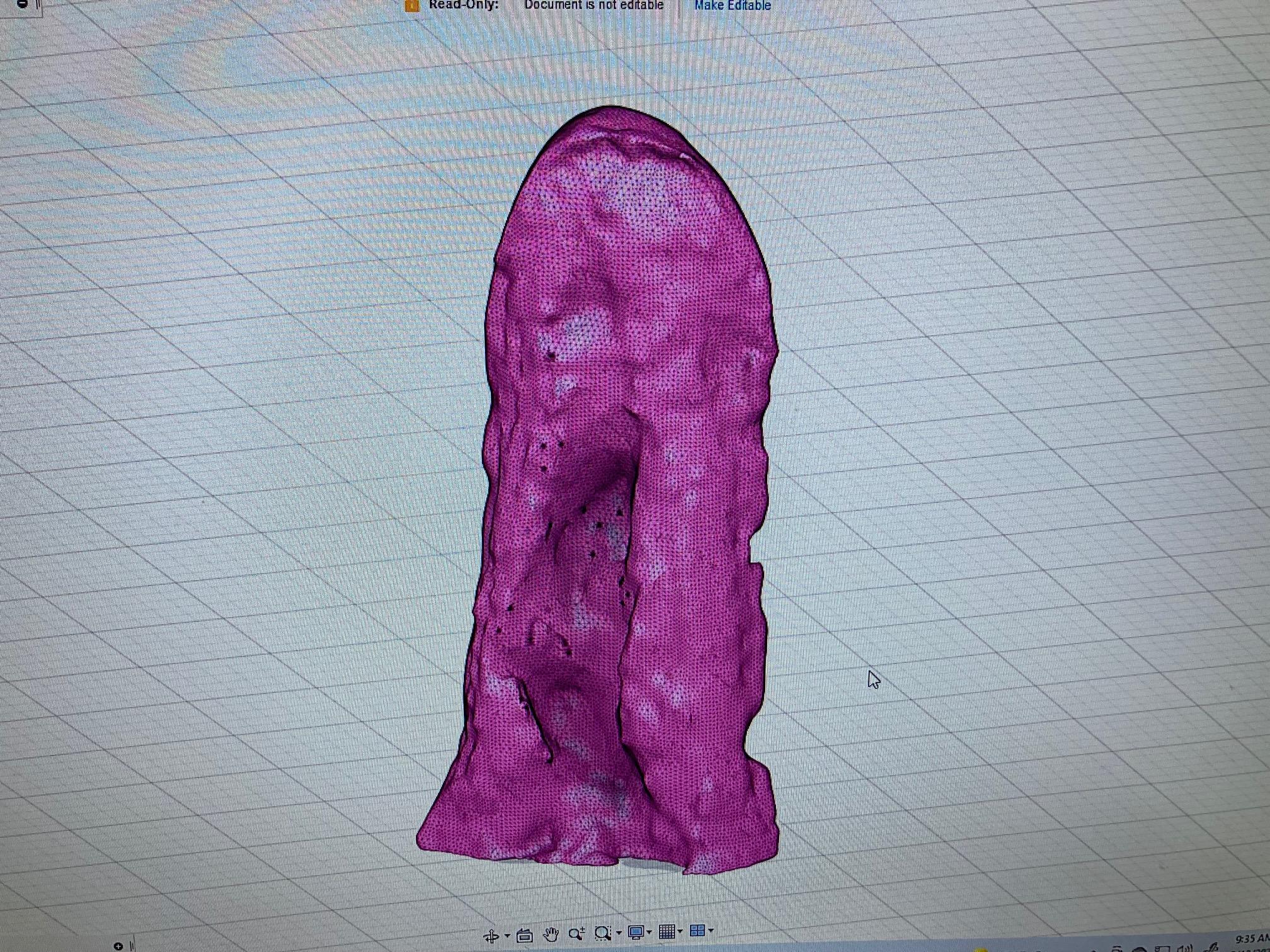

We were able to take the mesh and then create a tool with it in fusion to make a cut in the beak we sculpted. This was then printed. Ended up fitting perfectly.
great project Adam! I assume that you used direct conversion "mesh to solid" surface facets of triangular mesh are replaced by planar surfaces and stitched to solid. This is often OK for basic solid operations (hole, split, boolean). This functionality offers also FreeCAD - for free;-)

You are correct that I used the "convert mesh to solid". I also learned that I needed to drastically reduce the quantity of triangles I had in my mesh to make it workable. This turned out to be needed for the printing as well. A print that was too exact would fit less easily and cause oddities in the print.
