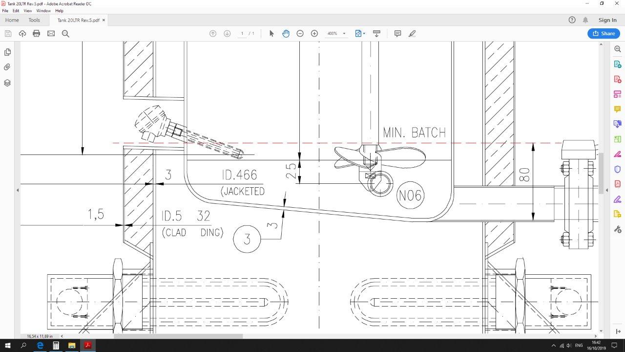

Can you help me with Autodesk inventor?

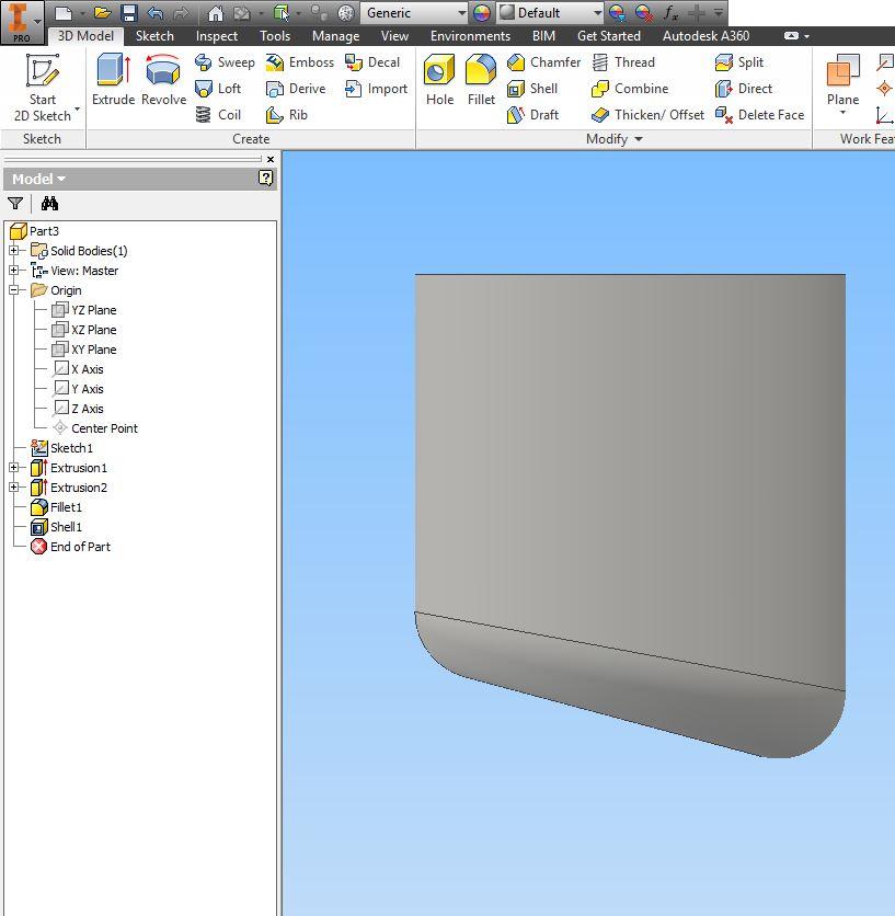

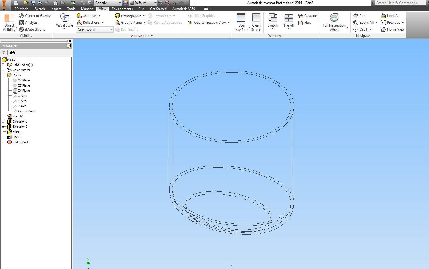

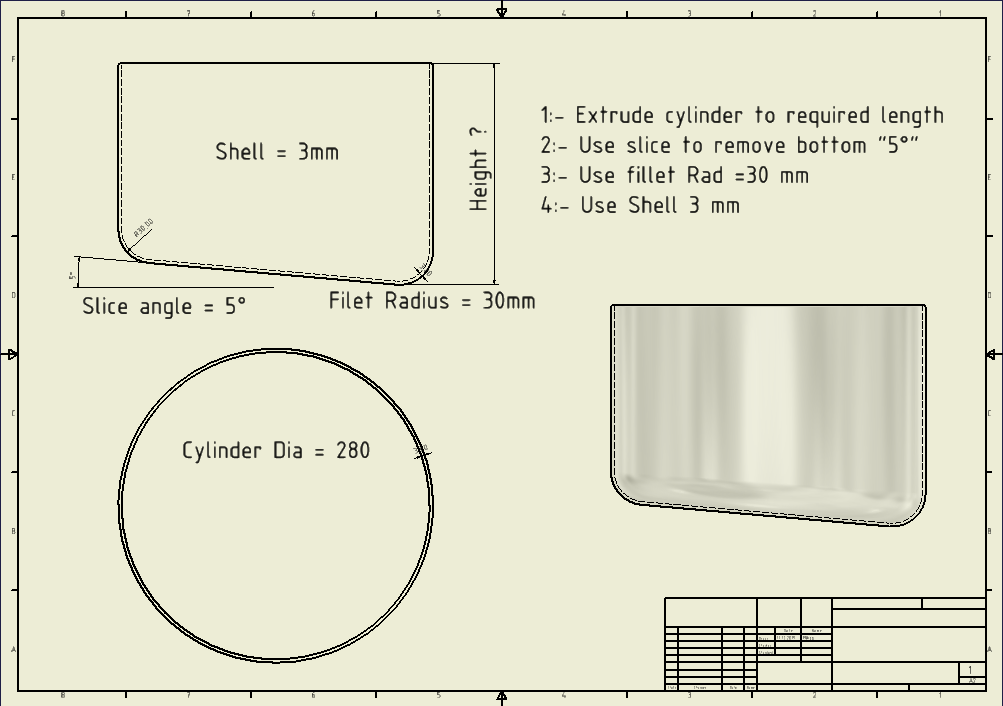

hi Mark thank you for your attention, that is the skecth
YES CYLINDER TYPE, tank you so much brother
wow...

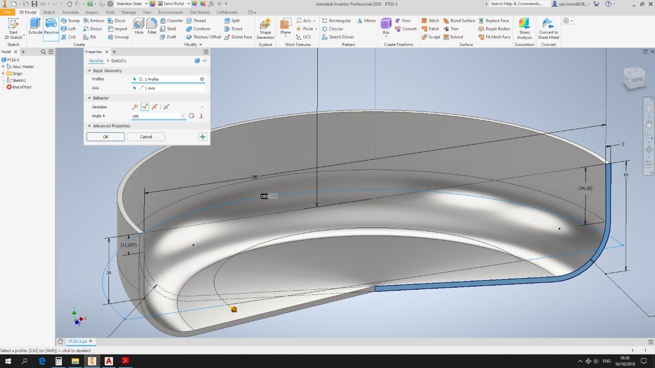

hi Alex thank you so much this is really my way out.
even though it can't be made flat pattern.
thank you so much, brother
I have made these in the past, the base is an elipse/oval, add your knuckle/radius allowance with a little extra say 6mm, then by hand you can knock over the radius using a pneumatic former or by hand with hammer and suitable stake. After forming the little extra can be trimmed by hand/lathe. Extremely work hardened item would require de stressing/normalising before welding to avoid cracks/failures. I see this is jacketed, have a look at these guys, https://www.omegathermoproducts.nl/en/ a good alternative to the usual. I used sketch and sweep method.

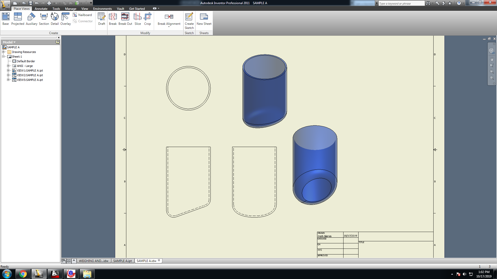

Excuse me, friends... i try to understand how made that drawing. but i dont find draw with angle??? :( :(
I´am sorry its easy to do but difficult to explain. Try to find maybe in YouTube how to use the Split command.
this is how you do the flat pattern (2) pieces.
