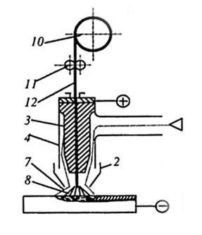

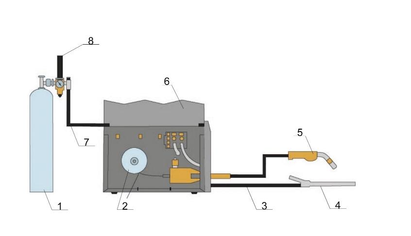

Semi-automatic pulsed electric arc welding with a consumable electrode in an inert argon gas environment.
Aluminum and its alloys have specific properties compared to steels, which make their welding process comparatively difficult. These properties include the following: tendency to pore formation; high thermal conductivity, high affinity for oxygen and formation of stable oxide Al2O3 in the form of a film covering the surface of parts; significant excess of the melting point of the oxide film (2050 Β°C) over the melting point of aluminum (660 Β°C); high coefficient of linear expansion; tendency to form hot and cold cracks; excess of the density of the oxide film over the density of the metal itself, reduction of the strength properties of the welded joint compared to the base metal; fluidity; sudden transition from solid to liquid state when heated; high absorption of hydrogen during welding. Aluminum is quite capricious in terms of welding, since it has an oxide film. The melting point of the oxide is 2050 Β°C. Therefore, in order to break it down with an electric arc, a high current is required. But the aluminum itself melts under the oxide after 600 Β°C. It turns out that with a high welding current: the liquid bath is scattered to the sides; it is difficult to control the arc; the number of undercuts and burns increases. If the current is reduced, it will not be possible to burn through the oxide film - all the filler metal will remain on the surface, and not fuse with the base metal. This will make the joint weak, not hermetic. Therefore, a MIG device is used that can automatically change the current during welding. Burn through the oxide at high current, and weld the base metal at low current. This mode is called pulsed. For welding aluminum alloy 6061 using the MIG method, a universal MM215 device is used. This welding machine operates with a welding current of 20 to 230 A, a voltage of 240 V and weighs about 29 kg. It is equipped with technology that simplifies setting up welding parameters. It also has a function for soft starting of welding. The welding process is carried out with a torch controlled manually by the welder. The ER4043 aluminum filler wire is fed automatically. Since aluminum is a fluid metal in molten form, the connection is made in the lower position. The most important process that occurs during arc burning in MIG is the transfer of the melting metal of the electrode wire to the weld pool. The nature of this process is influenced by such factors as the composition of the protective gas environment, current, arc voltage, material and diameter of the electrode wire. Depending on these conditions, the melting material passes into the weld pool in a short pulse. Through the filler wire-electrode, the optimal amount of alloying elements and deoxidizers enters the weld pool, which ensures an excellent connection. The alternating current mode allows you to automatically switch the polarity of the current during the welding cycle. As a result, at the beginning of the cycle, the oxide film is destroyed, and during the next cycle, deep and dense fusion of aluminum is achieved. Setting the polarity and balance of the current allows you to adjust the cleaning zone and the depth of penetration. The quality of the future weld depends on the preparation of the surface of the workpiece. Before work, each product is cleaned, even if no traces of oil, chips or other contaminants are visible on its surface. The oxide film is removed mechanically and chemically. The surface is cleaned mechanically, then the working surface of aluminum is treated with a solvent (acetone, gasoline, white spirit), after which the product is dried before the welding cycle. For the mechanical cleaning method, sandpaper and wire brushes are used. For the chemical method, alkaline solvents are used, followed by rinsing in hot and cold water and drying the workpiece. All welds are of the highest possible quality with full penetration. The weld completely encircles the perimeter of the pipe. After welding, welding beads are removed, sharp corners and edges are rounded off, all surfaces are ground. Usually, after welding, the properties near the weld are about 40% of the strength of the entire metal. Therefore, to give strength, the frame is subjected to heat treatment - tempering. After heat treatment, the frame is covered with a protective primer.
