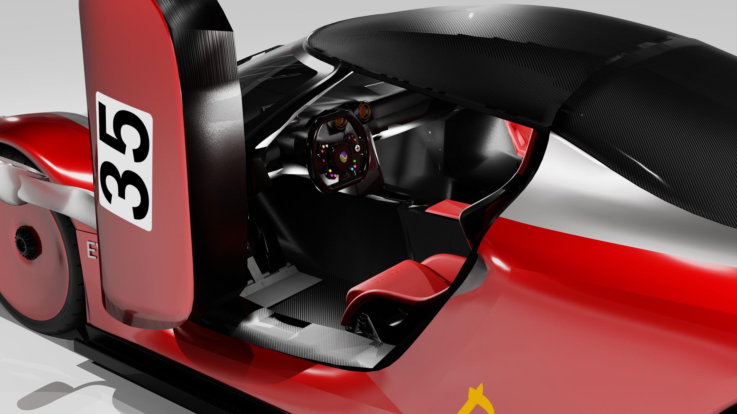

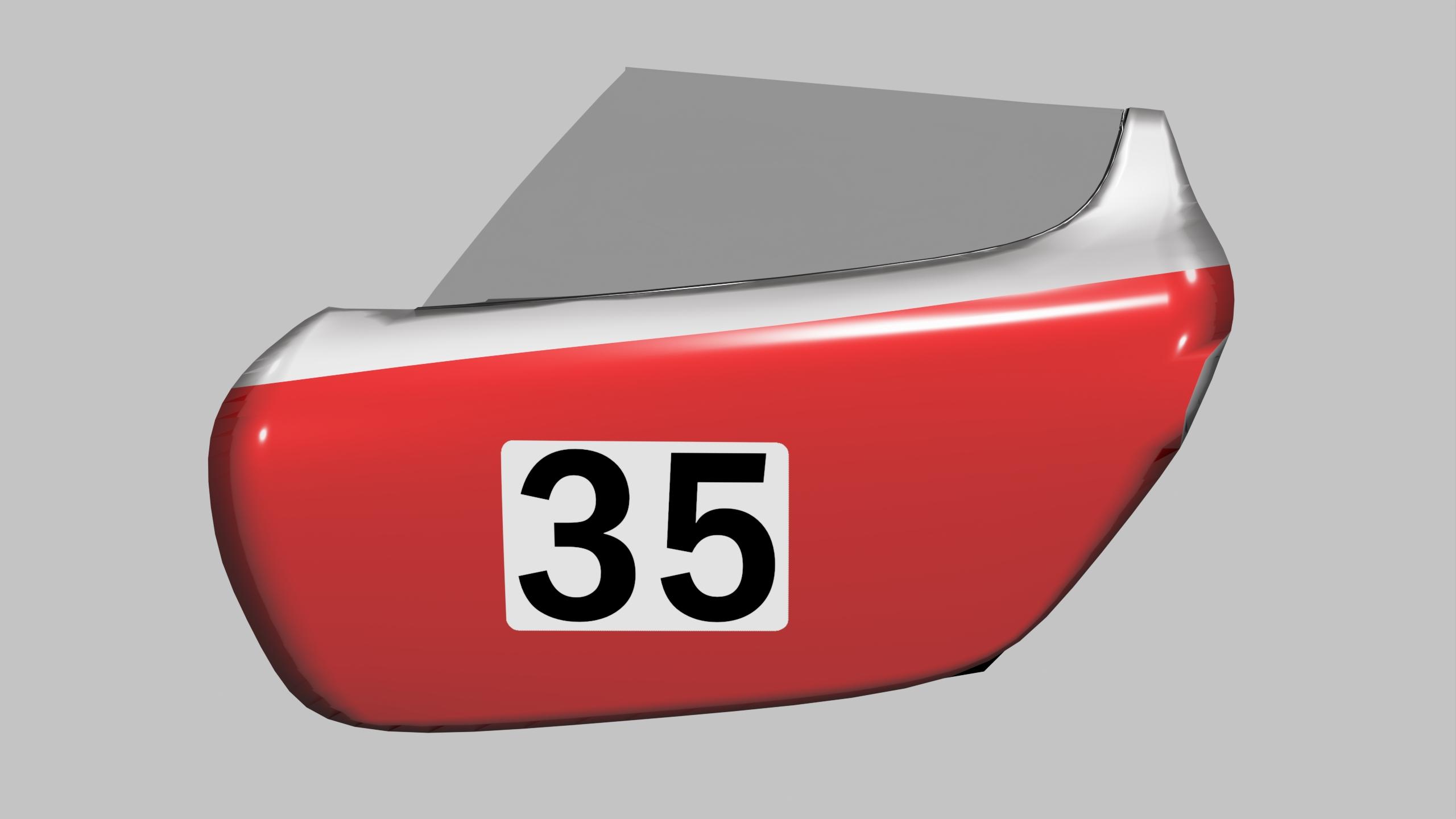

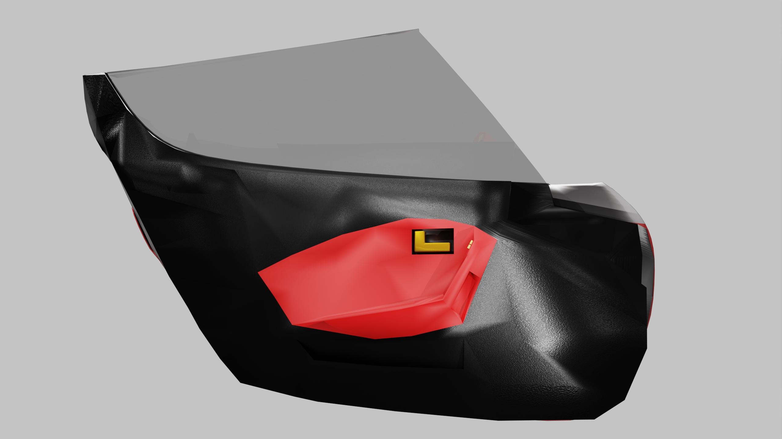

The car has a vertical lift door, also known as a "gull wing". It opens vertically upwards, forming an angle of about 90 degrees with the car body. This not only adds technological charm to the car, but also makes the car convenient to get into. An original mechanism is used to implement the vertical opening of the door. To ensure safety and prevent accidental lowering of the door, a special locking mechanism is installed in it. This mechanism is activated in the vertical position of the door. The door is also equipped with a door opening limiter. The door hinges on which the door is suspended allow you to adjust their position relative to the monocoque openings. The door is made with one lowering glass controlled by an electric drive. The door window is safe, polished, made of three layers. It is installed in the door with rubber seals. The car is exposed to air flow not only from the front, but also from the sides. The rounded window not only helps mix air flows in the vicinity of the windshield, but also allows the air flow washing the sides of the body to move the point of flow breakdown closer to the rear of the car. The outer door handle is aerodynamic and is located inside the end face. The door is made of carbon fiber.
