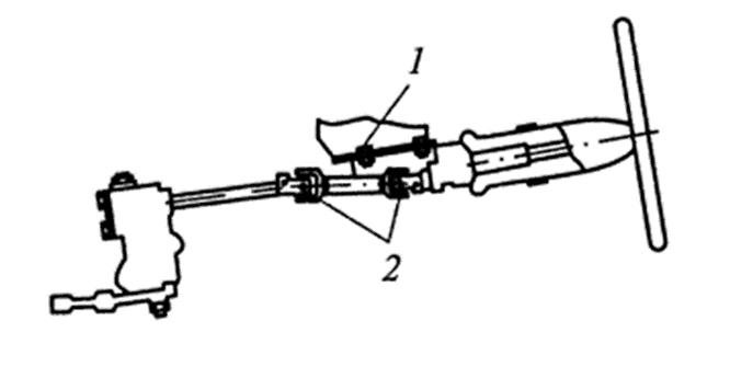

The steering shaft consists of three parts: 1- bracket; 2- cardan joint.

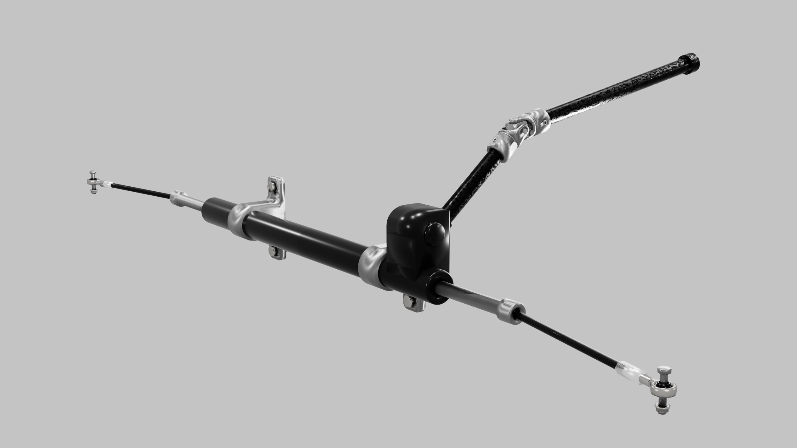

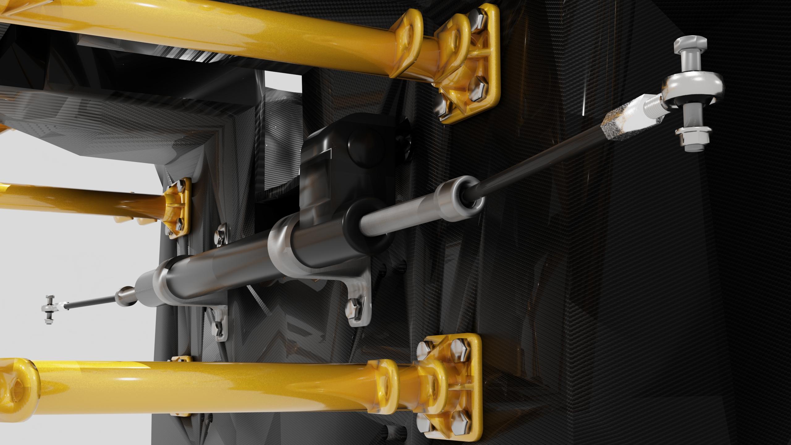

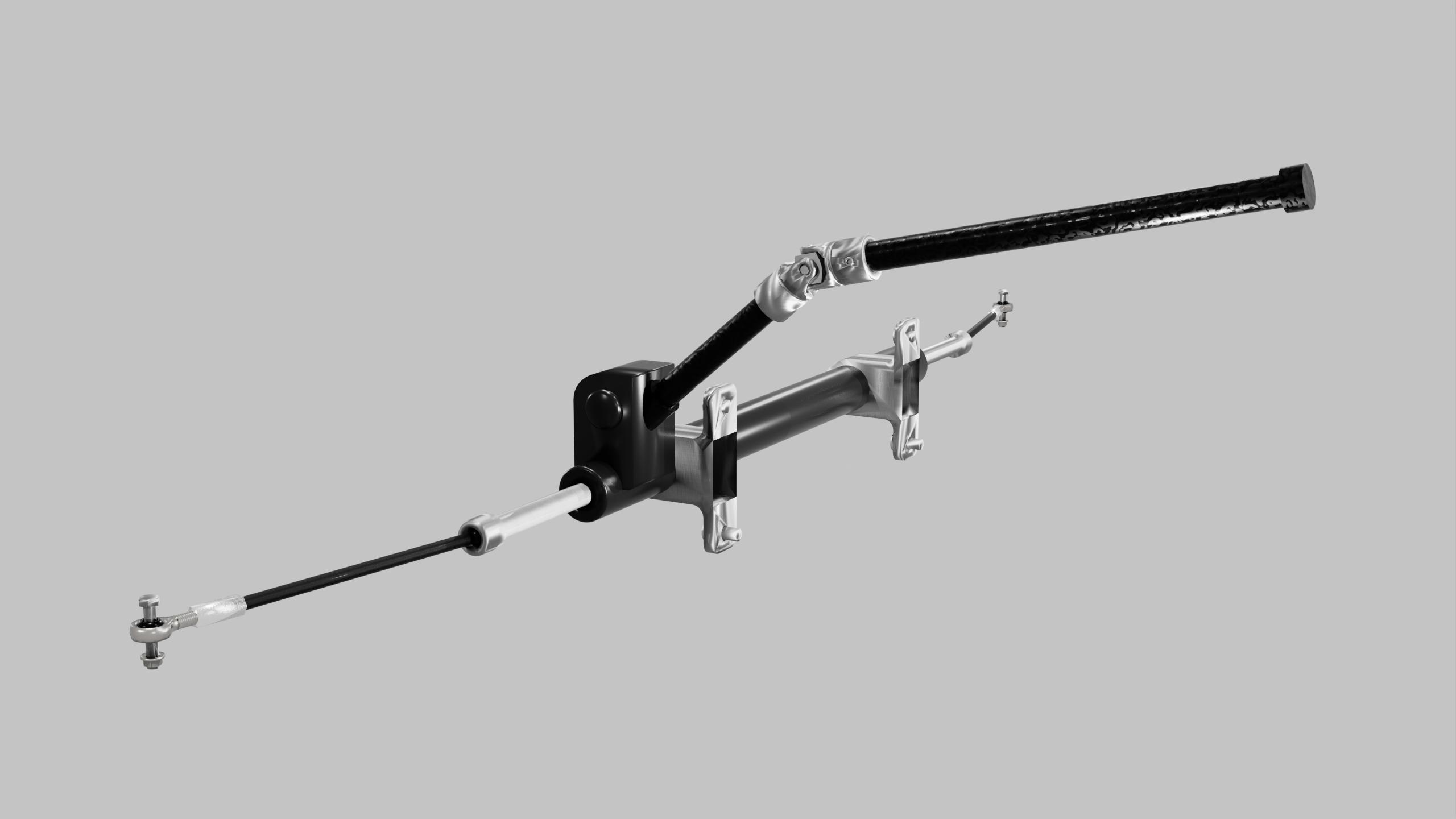

The car uses a rack and pinion steering mechanism. The steering gear ratio is 20.4. The steering gear includes a steering wheel, a steering shaft and a steering pair (rack and pinion), consisting of a pinion and a toothed rack. The steering wheel through an intermediate shaft providing safety of the steering wheel, is mounted on the splines of the upper end of the steering shaft, which rests on a radial ball bearing mounted on a bracket tube. The steering shaft together with the steering column, consisting of two parts, is attached to the monocoque of the car using a bracket. The lower end of the steering shaft through an elastic coupling with a tie bolt is connected to the splined shank of the drive pinion, which is installed in the aluminum housing of the steering gear on roller and ball bearings. The pinion is in engagement with the toothed rack, pressed against the pinion through a stop made of sintered materials by a spring, pressed by a nut. This ensures a gap-free engagement of the drive pinion and the toothed rack, along the entire length of their stroke. The rack rests on one end on the stop, and the other end is installed in a split plastic bushing, which is fixed in the steering gear housing with special protrusions and sealed with rubber rings. The rack is limited on one side by a special ring pressed onto it, and on the other side - by the bushing of the rubber-metal hinge of the left steering rod, which rest against the steering knuckle lever.

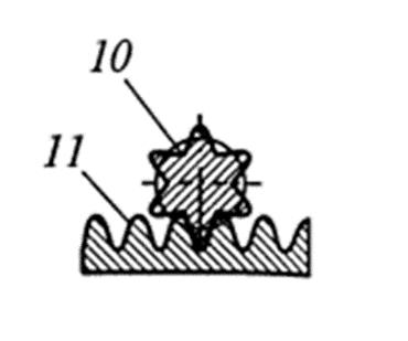

Rack and pinion steering mechanism: 1-pinion, 2-rack.
