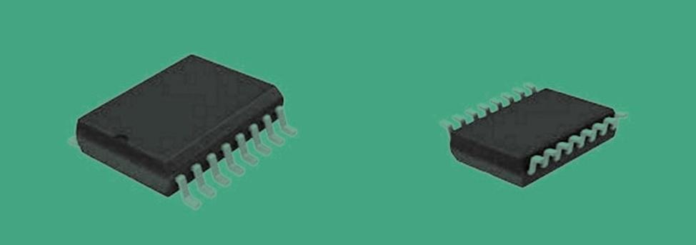

Inside the module with buttons there is a printed circuit board with shift registers. Signals from the buttons on the steering wheel are transmitted through the 74HC165 shift registers installed on the printed circuit board in the steering wheel. The shift register is used to increase the number of microcontroller inputs, to determine the presses among a large number of buttons. The car's computer receives serial digital signals from the 74HC165 shift registers. The 74HC165 microcircuit converts a parallel input signal into a serial output. It allows you to increase the number of digital inputs of the microcontroller. The chip converts the incoming parallel signal on 8 pins (Dx) into an output serial signal on 1 pin (Q7). The transmission is synchronous. An additional pin (CP) is used for the clock. Also, a separate pin controls the data register (PL), which allows you to "load" a parallel signal for serial reading from 8 outputs at a time. Thus, from three pins of the microcontroller, 8 digital inputs are obtained. A cascade is performed from the 74HC165 registers, connecting one after another, and thus from the same 3 incoming lines 16, 24, 32, etc. digital inputs are obtained.
Shift register 74HC165

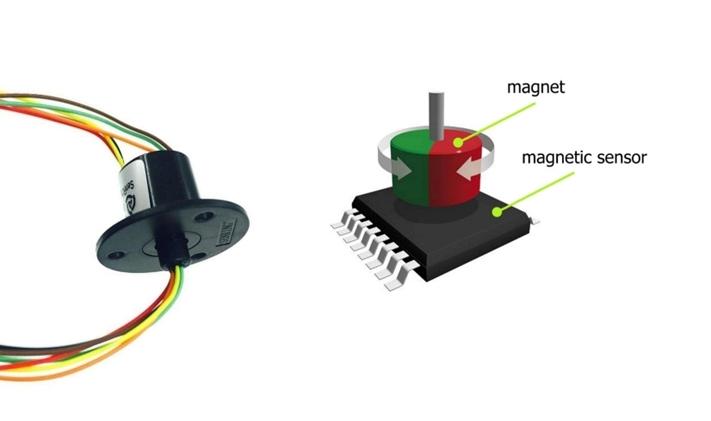

The peculiarity of the steering control is that it uses a magnetic sensor to determine the angle of rotation. With the help of this sensor, a signal is sent to the microcomputer to control the rotation frequency of the electric motors depending on the angle of rotation. The magnetic sensor, installed in the fixed part of the instrument panel body, determines the position of the steering wheel with an accuracy of 0.06 degrees. The advantage of using a magnetic sensor is its small size, contactless operation, high accuracy, and long service life.
Rotating connector and magnetic sensor
Scheme of operation of magnetic sensor
