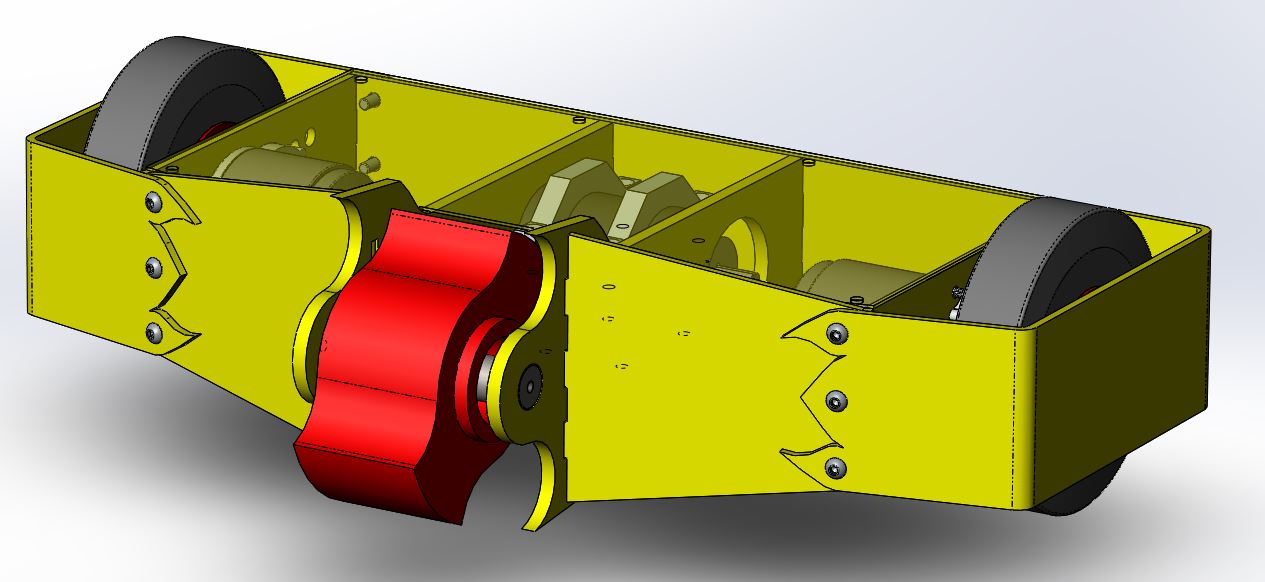

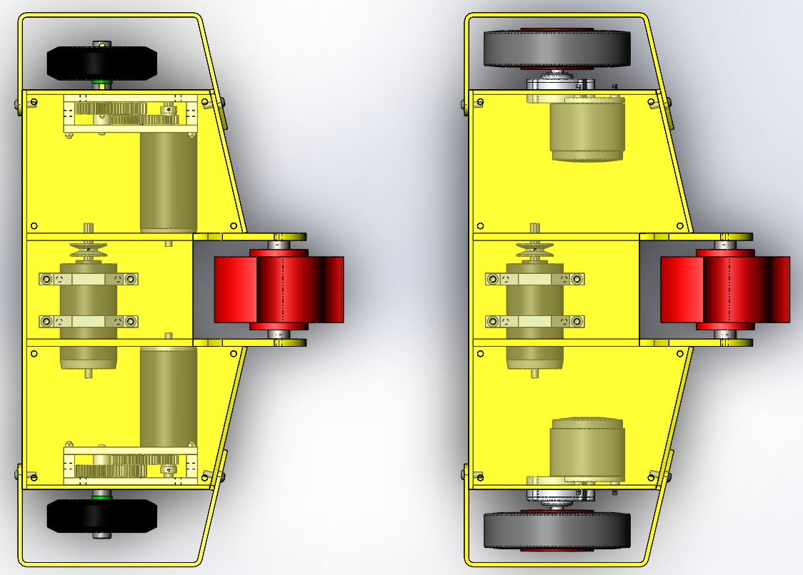

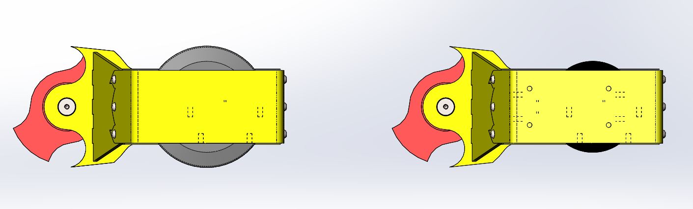

My middleweight concept. Idea is either my existing ebike motor set w/ 8"trolley wheels or my custom ampflow reducer set w/ 6" colson may fit. It's symmetrical so it's invertible and functional either top or belly up. Some conerns though;
-Is the body proportion just fine? I want it to gyrodance that's why I thought of making it wide and short.
-It's prone for the doing "the thing" on all sides
Share your thoughts :)
