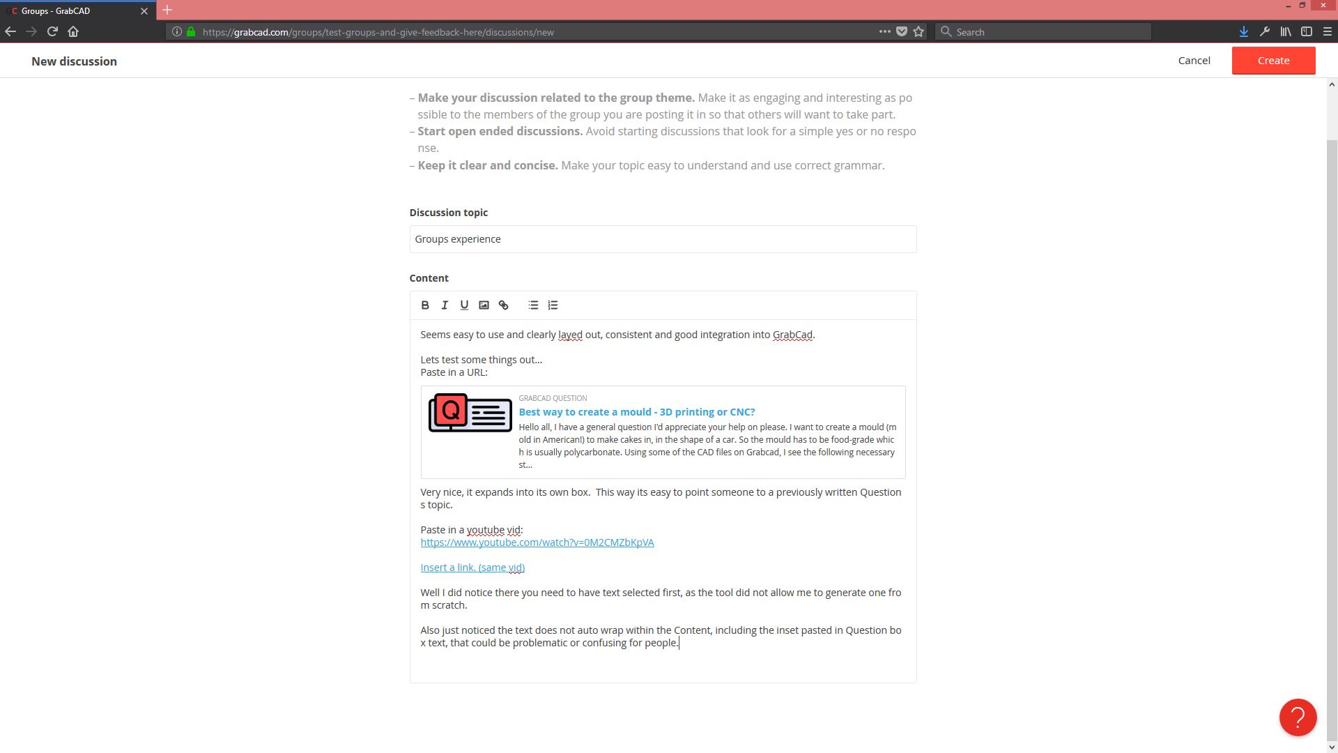

Seems easy to use and clearly layed out, consistent and good integration into GrabCad.
Lets test some things out...
Paste in a URL:
Very nice, it expands into its own box. This way its easy to point someone to a previously written Questions topic.
Paste in a youtube vid:
https://www.youtube.com/watch?v=0M2CMZbKpVA
Well I did notice there you need to have text selected first, as the tool did not allow me to generate one from scratch.

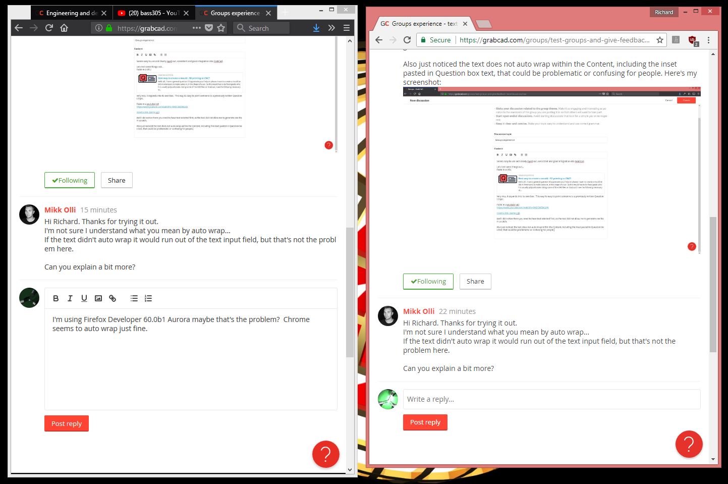

Also just noticed the text does not auto wrap within the Content, including the inset pasted in Question box text, that could be problematic or confusing for people. Here's my screenshot:
Hi Richard. Thanks for trying it out.
I'm not sure I understand what you mean by auto wrap...
If the text didn't auto wrap it would run out of the text input field, but that's not the problem here.
Can you explain a bit more?
I'm using Firefox Developer 60.0b1 Aurora maybe that's the problem? Chrome seems to auto wrap text (shift whole words across lines of text to avoid cutting them in half) just fine. Will have to see if there are settings.
.discussion__content {
word-break:break-all;
word-break:break-word;
margin-bottom:16px
Maybe here in line 6396 you have word-break:break-word; instead of word-wrap:break-word;
That could be a typo in the CSS stylesheet.
