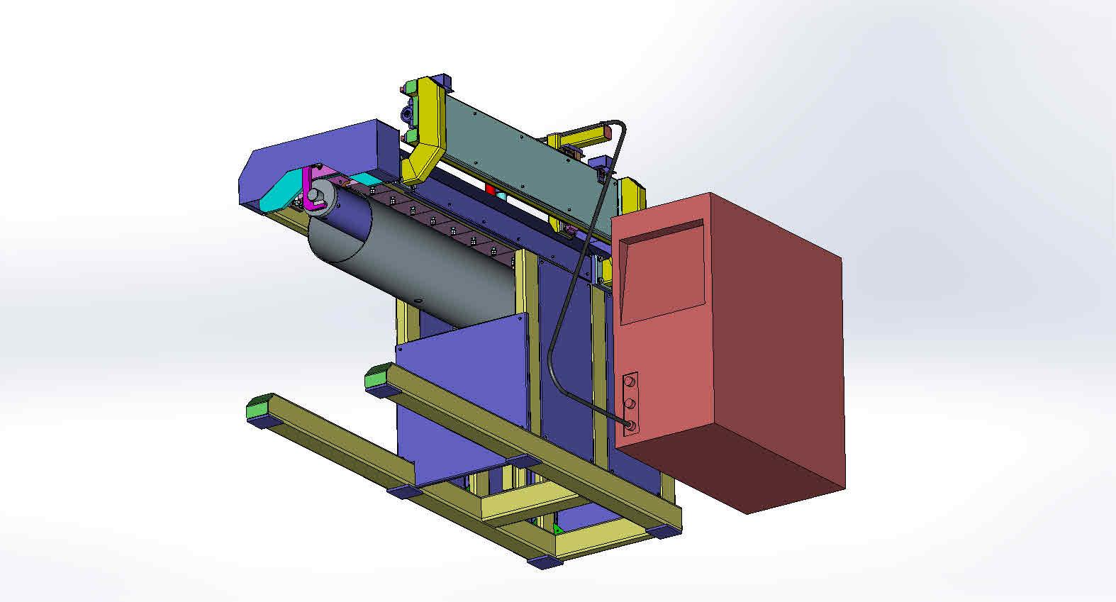

Long seam welding contains a wrlding bench having series of clamping jaw, which is a critical part of it...
I want to know how the clamp activated, one i have seen on jetline site shows the large inflation tube applies force on the clamp to grip the sheet, however i would appreciate if any design reference available....
A simple foot switch can open and close the clamps
Do you have any referance regarding what sort of pneumatic clamps would be used for it, diameter of pipe will be 600 mm and thickness will be 6 to 10 mm.
How long is the pipe?
I will have to check on off the shelf clamps. We can develop a clamp design
Pipe length will be 2 metre
I have attached an image showing working of longseam welding machine, the interesting part is point no 4, do you have any specific details regarding it...
