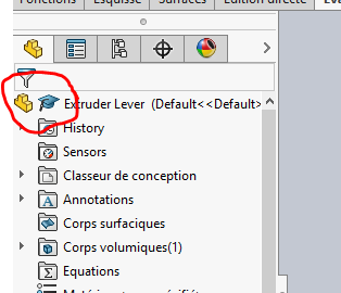

hi guys
i have a little problem i wanna delete the hat in the top
hoow can i remove it ?
thanks

This is a training version file. Just draw in the commercial version.
This means that this model is for educational use only; made in an educational version.
You'll have to remodel it yourself...
There is a tool which can change an educational part to a commercial part. I've never seen the tool, but I believe it resides at SOLIDWORKS HQ.
It is likely a flag in the raw file data, but I'm sure there is some added complexity involved since the slightest change to the raw data file results in checksum errors. This is even worse since they went to a compressed/encrypted file format back in 2016 or so.
So yes. SOLIDWORKS, or a Value Added Reseller may be able to convert an educational license part to a commercial version.
There is nothing wrong with the icon though. It just causes a pop-up window on opening.
Found this as well.
and how ?
thnks fr replying
the model opens normally there is no probleme but i wanna use a part of it i my project thats why i should remove it
