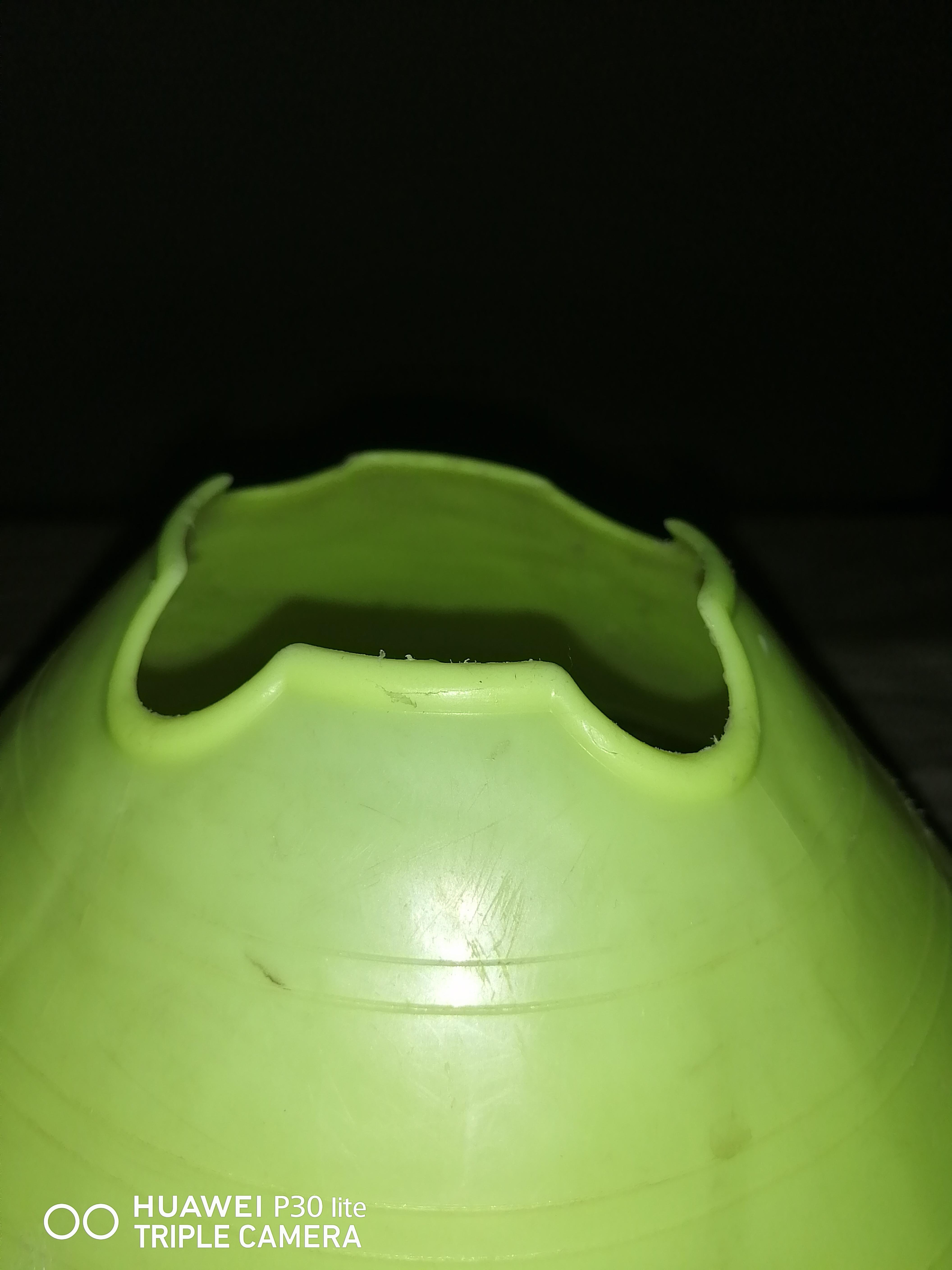

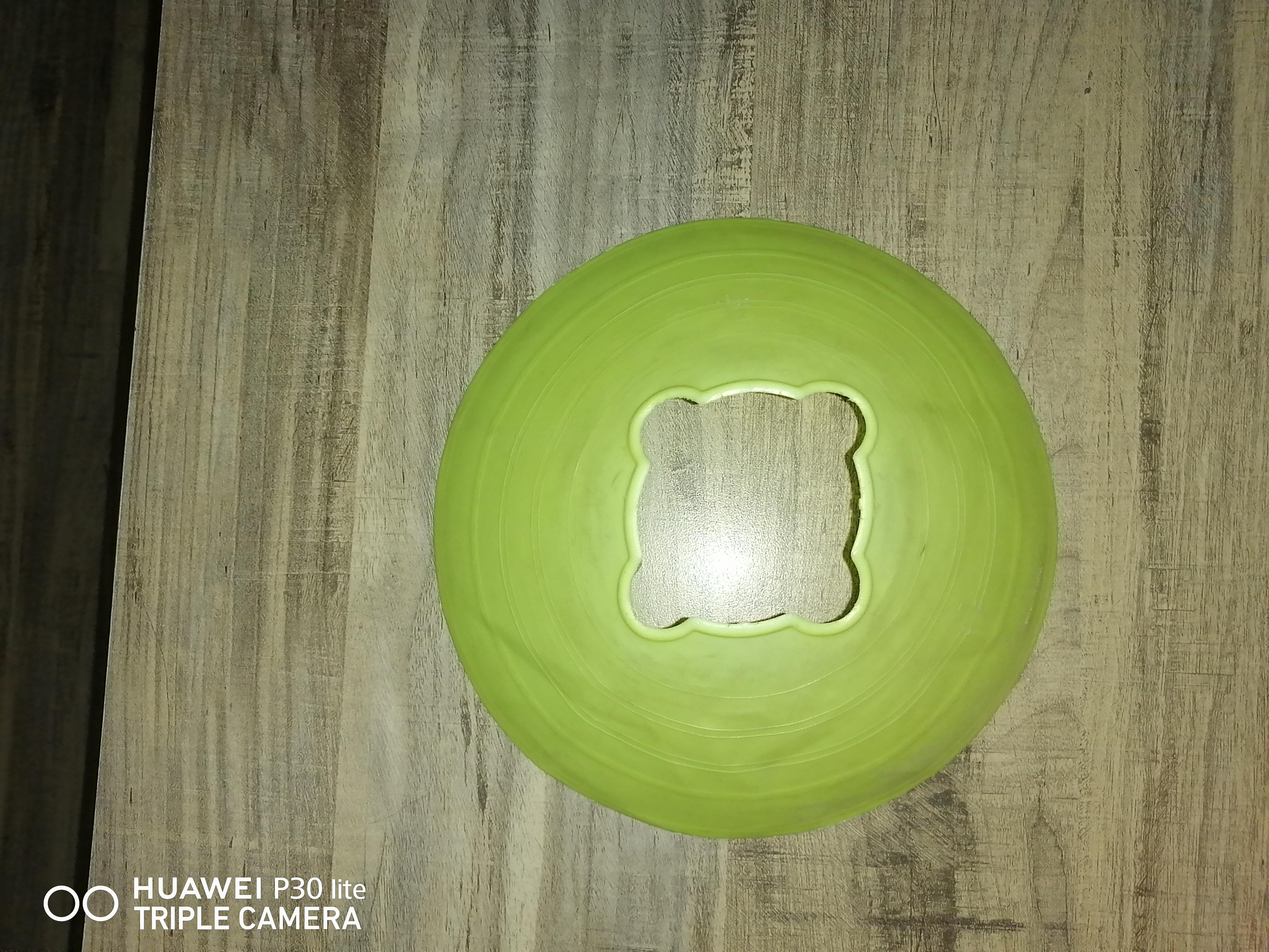

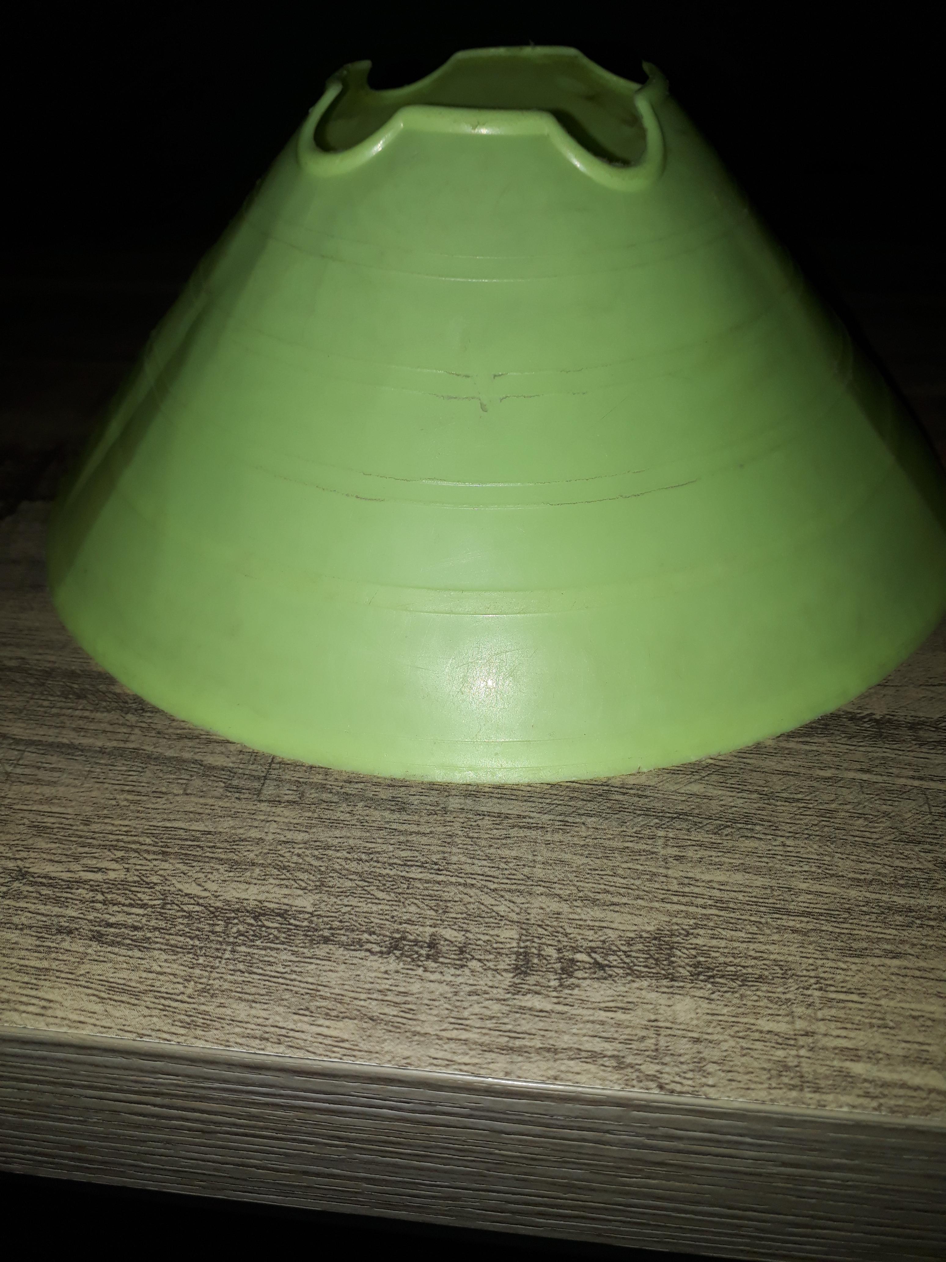

Hi, who can help me? I need to draw this piece in solidworks 2013
I can make the cone and everything that could be done in revolution but I don't know how to make that prismatic shape of this cone

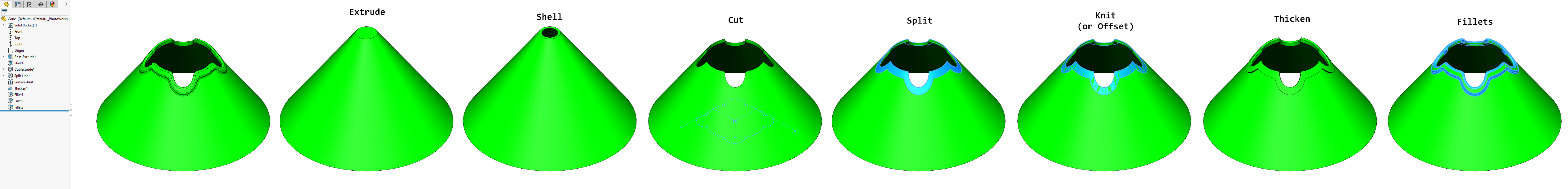

I had to guess at dimensions, but I think it looks OK.
I started with a drafted extrusion due to a dislike for revolved features. But either starting point will work.
Save the attached image and open it outside of the browser window, it should then be large enough to read.
