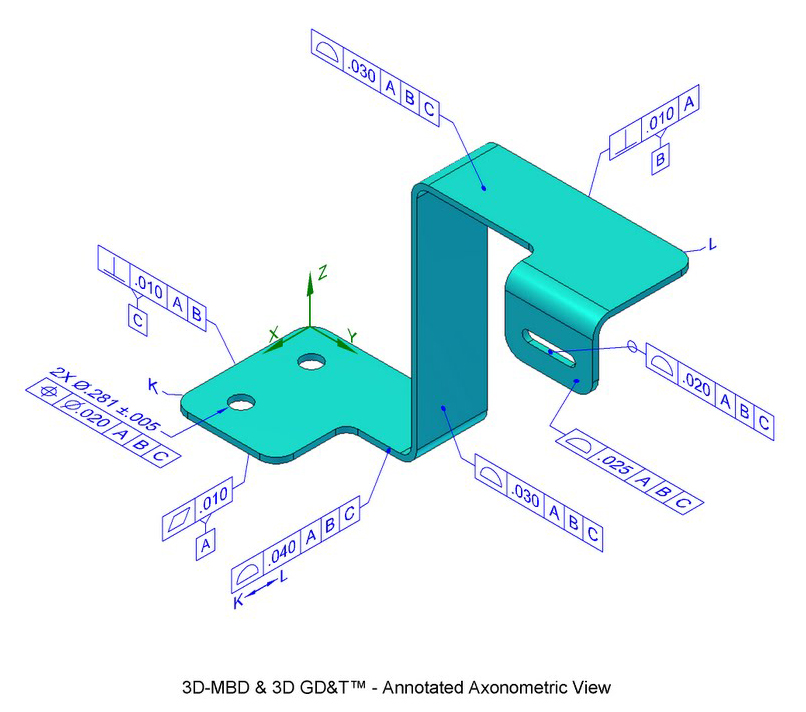

I don't know that they're going away so much as things are evolving more towards a model-based approach. ASME Y14.41 (model-based definitions) covers a lot of the requirements in that regard, though it is in constant revision as the standard evolves.
I've always felt that... if you're machining from a model, inspecting from a model and carrying all the pertinent data in the model, then a 'print', be it digital or paper, just becomes a document people not involved in those processes would have need for.
In the model-based approach, the GD&T is still carried within the modeling environment and is still necessary. All of our in-house stuff carries PMI (Product Manufacturing Information) per Y14.41, but that's just us. The mother ship doesn't use it at all yet, but then, we're a lot leaner, with fewer hoops and barrels to jump through.
Typical example: primary-secondary-tertiary established, be it casting or finished part... some form that can only be described as a spline curve on a surface out somewhere in space. Why on earth would anyone want to define that with anything but with a profile feature control in relation to A/B/C? Yes I see attempts to drive dimensions to construction data all the time, as if that will somehow be useful to anyone. :)

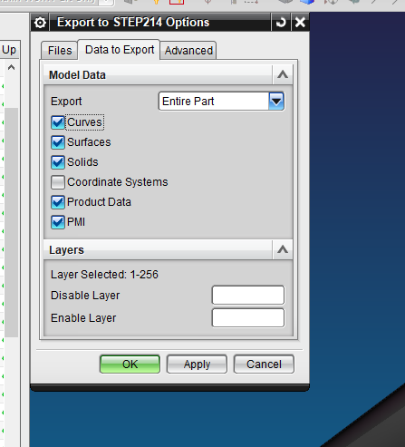

I'll have to experiment if the annotation view carries over to a step file but I see your point.
Yeah, check your step export settings. There's usually an option to include the PMI, or whatever your flavor of software may call it.
