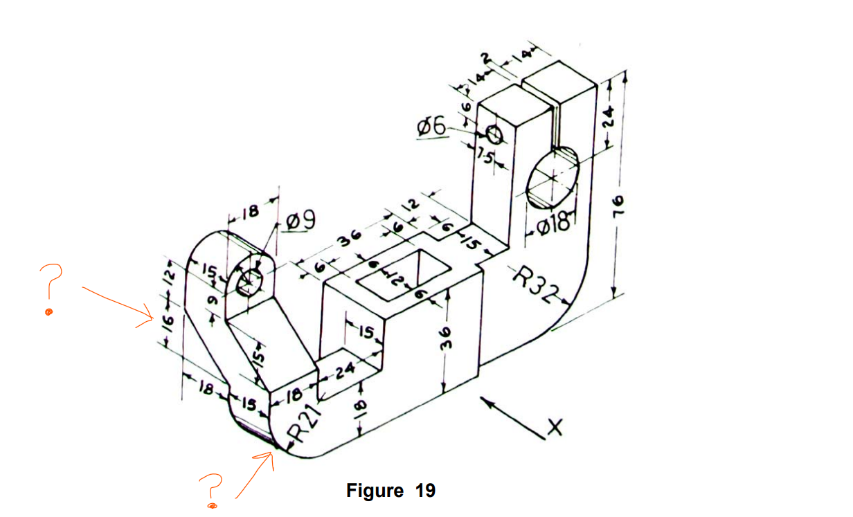

I need help with this 3d drawing in AutoCAD
I didn't know how to draw that arc like not sure what tool to use, and also, I wanna know that distance from where to where exactly.
it seems like it needs more views to draw this object properly, what do you think guys?
You'll want to use the isocircle command under ellipse for the filets. But yes, that drawing looks like it's missing some critical dimensions on that end.
