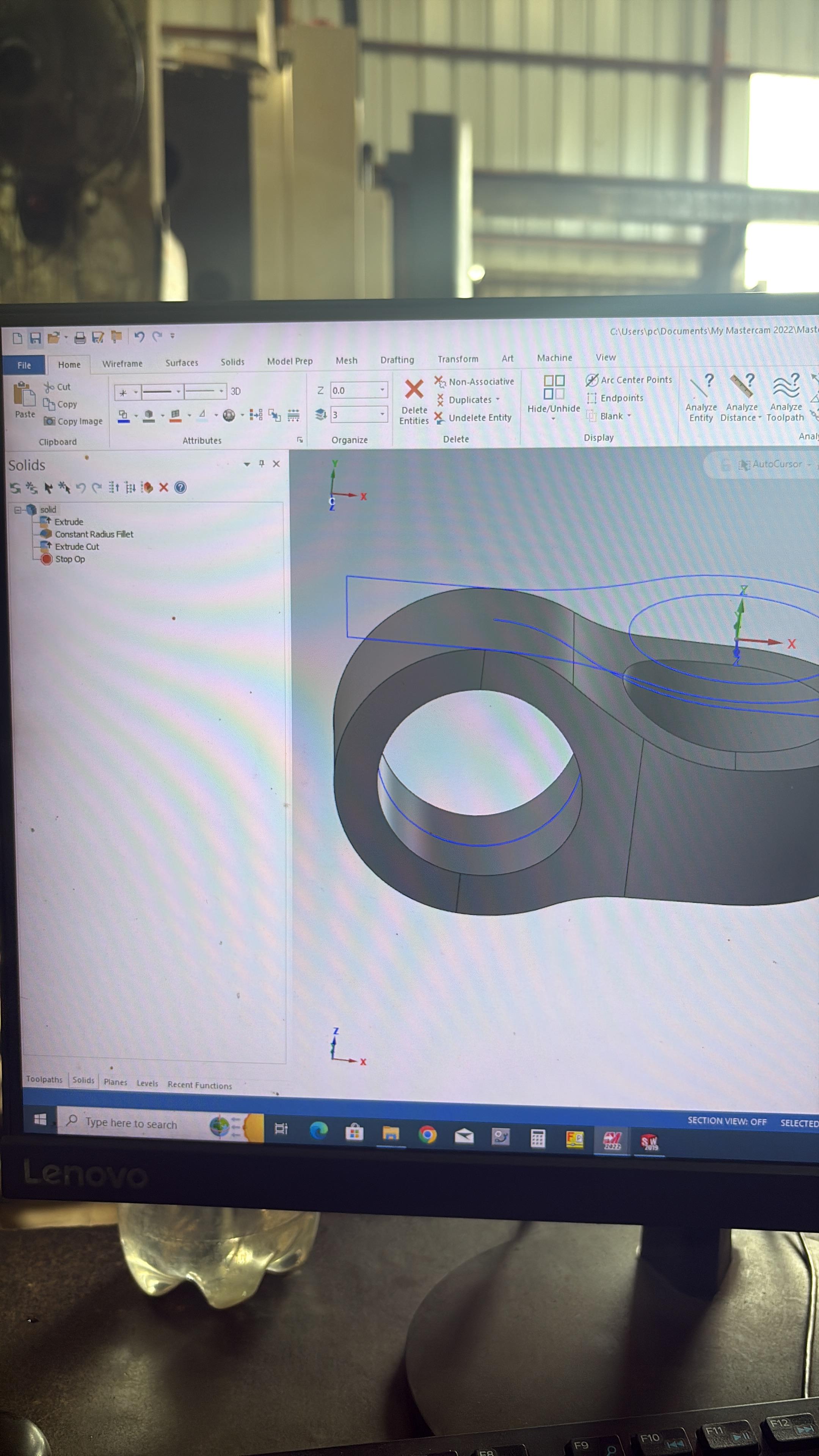

For something a little harder. Instead of the corner radius, run a 1mm diameter groove about 1.5mm from the outside edge, all the way around on the two outside surfaces.
Took 8 features but could easily be trimmed to 7.
I have not managed to reduce the number of operations for the original challenge. Whereas, for Bob's proposal, I have only added two operations (5 in total).
When I saw https://grabcad.com/capricornio-1's solution with only 5 steps, I also saw 'The Light©' :-)
It only strikes me that your tree has 1 solid but also 1 surface. Maybe we don't adopt exactly the same solution!
You know that I love surfaces :-)
It is all in the power of the mind:
When you think that you know that a solution is possible, you find it, even though you may have 'Seen the Light®', in the process :-)
With a change more in form than in substance... I can also say that I did it in "3 operations".
I had used a path that, for some reason, was not embedded in the groove operation. Now I changed it to a 3D sketch and it is embedded, with which it "appears" one less operation than before...
Actually, for "the same price" we can add the fillet radius that we removed earlier...
CATIA V5 with 3 features plus extracted curve. (green Pad, blue Pocket, red Groove)
