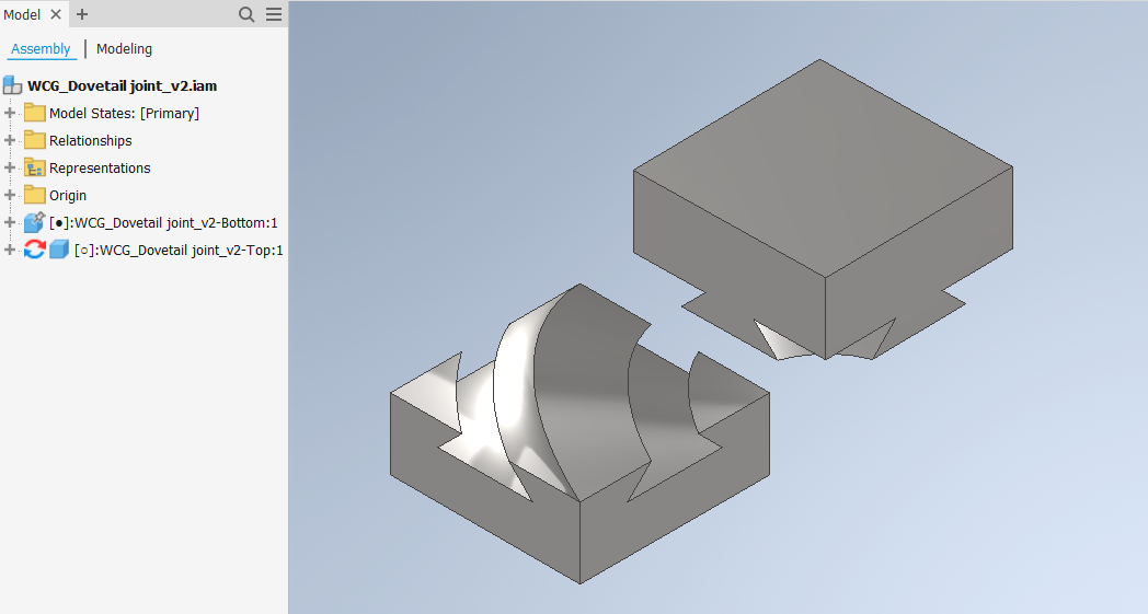

It’s easy to just make a straight diagonal cut. It becomes a little more interesting if the cuts pivot around an offset axis.
But what if the offset axis isn’t vertical.
or maybe make it horizontal below the part
I found a new trick with Inventor doing all of this: sketches for revolutions do not have to be coplaner with the revolution axis.
Apparently in SolidWorks they must be (or at least I did not find a way to make a revolution surface from non -coplanares sketch).
In fact, to achieve the forms that you showed, with horizontal and inclined axis, I must resort to a loft with a guide curve generated around said axis.
However, what I could do are two "Sweeps" using non -coplanar sketches as sections and a circle as a journey, generated from the inclined axis:
I could not choose both sketches simultaneously as sections for the Sweep, nor a curve that composes them (accepts composite curves as paths, but apparently not as sections).
PD: in case it really solidworks cannot make revolutions from non -coplanar sketch ... the "Sweep + Circular route" provides equivalent functionality, although somewhat uncomfortable.
I could not choose two sketches for one revolution. It’s two separate revolutions merged together.
You guys have taken this to a whole new level. It took me a while to figure out what the coplaner-problem is.
I managed to do the split with a surface made in one revolution, of a planar sketch constructed with the help of a 3d-sketch.
Interestingly, the geometry breaks down at some angle and/or radius...!
The straight lines of the dove joint are no longer straight.
I tried that same method to begin with. None of the straight lines are actually straight if the axis is at any angle. They are not simple arcs. I think they are either a section of parabola or an ellipse depending upon the angle.
Oh, so you think that it is only this method that has issues? Must look into it; it is far from obvious what is going on?!?
Using the sketches on the faces forces the revolved profiles to have a straight line intersection on the face of the block which is what we're after. But the revolved surface forms something like a paraboloid because the straight lines are on sketches (planes) that are not coplanar with the axis.
Conversely , if straight sections that are coplanar with the axis are used as in your method then the surfaces are a simple conical shape. Because the block faces (planes) are not coplanar with the cone axis, the intersection always forms something like parabola. I say like a parabola but it could also be an ellipse or hyperbola. it all depends upon the relative positions of the axis and block faces.
It sounds rather convoluted but it breaks down into simple geometry.
If you rotate a straight segment around an axis contained in its same plane, you will generate cylindrical or conical surfaces.
On the other hand, if the segment is in a plane that does not contain the axis and, moreover, is not parallel or perpendicular to the axis, then you will obtain hyperbolic surfaces.
Some cases are tricky and appear to look like conical surfaces.
But if you exaggerate the steepness of the segment (as in the following figures) you will find that the surface is hyperbolic. If you cut it with a plane that contains the axis, you can see the curve perfectly, but if you see it in the plane of the generating segment, it is a straight line.
