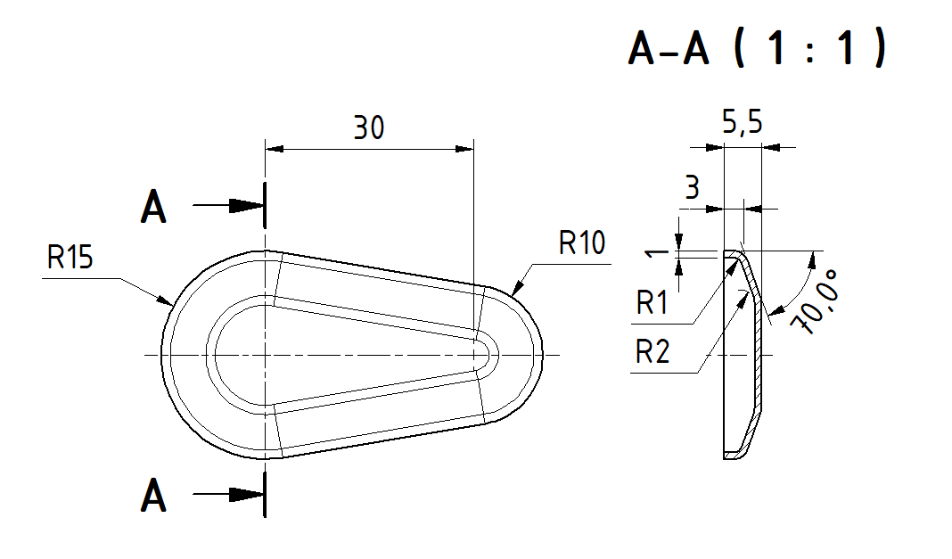

Found this small model of a gearbox housing. I challenge you to create this model with as less as possible functions. I did not get it in one.

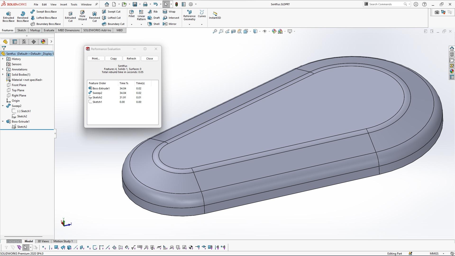

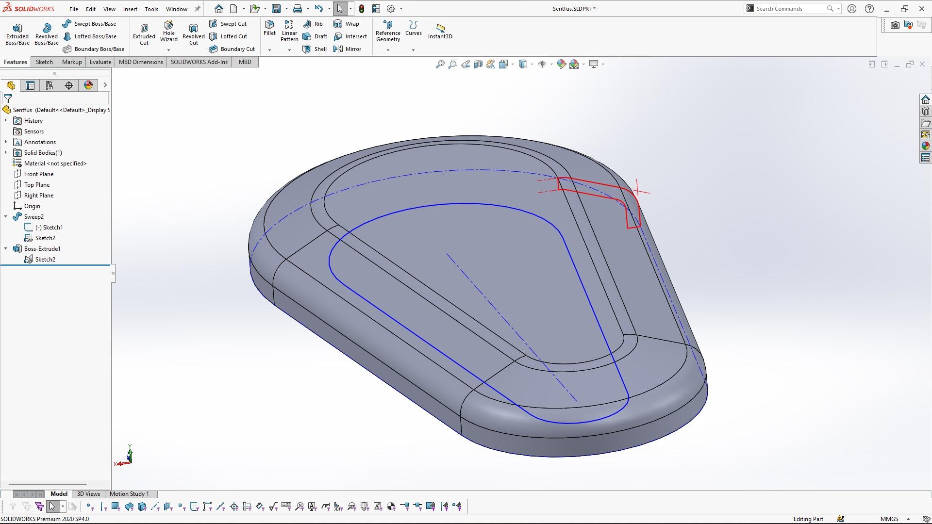

In SolidWorks I had to make two sketches and two operations (one sweep and one extrusion). I can't think of anything better.

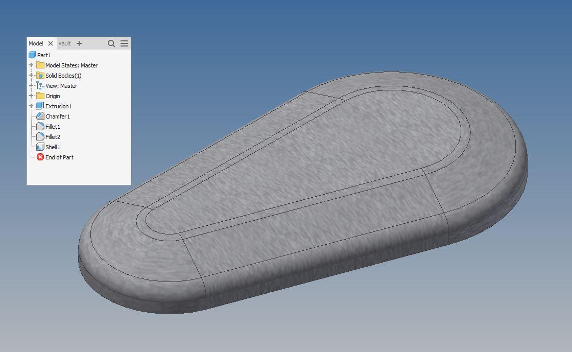

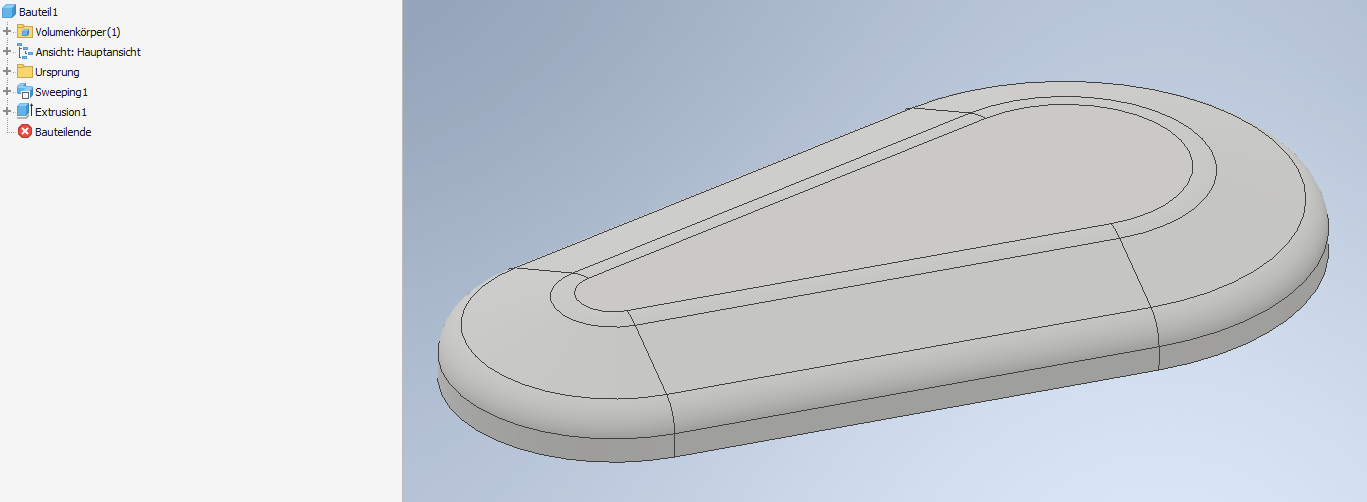

Using a sweep and then an extrude is the obvious, if not the only, way to do this with the least number of features. So, I decided to take a different approach. How many features does it take if you can't use a sweep? I did it with 5 features.
