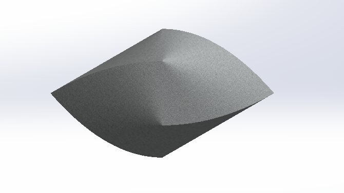

Sphericons are mathematical toys that roll on a plane in a funny way. Let's try to build a simple sphericon - hexacon.
Its name is derived from the word hexagon implying the hexagonal shape of its middle cross section. Like other sphericons , with cross section edges number that has an odd factor, while rolling on a plane, its maximum height remains constant. The hexacon’s surface circumscribes a regular octahedron.
The challenge is to build solid 3d model of hexacon with as less as possible features (I used 5 features).

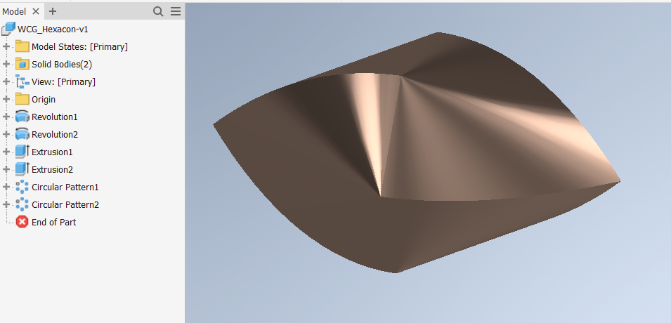

This one was tough for me to figure out. Took 6 different attempts. Should have watched the video first.
Inventor. 4 features.

Good idea to use a second circular array, I like it!

The model starts with a simple revolution of a triangle to form a cone shape. Using surfaces would be the most difficult method. It really is easy to produce with any CAD system once you understand the geometry.
Watch the video in the original post.
After reading your method, I realized that it is so simple and learned something new, thank you

After watching the video, I made a Tetracon just for fun:

This challenge has turned me into a "polycon addict". Here's one of the polycon shapes I came up with. I used the same steps as in the video, but with a different shape instead of the side of a polygon.
of a polygon:
Little different version. I might have to actually print this one to see if it works
