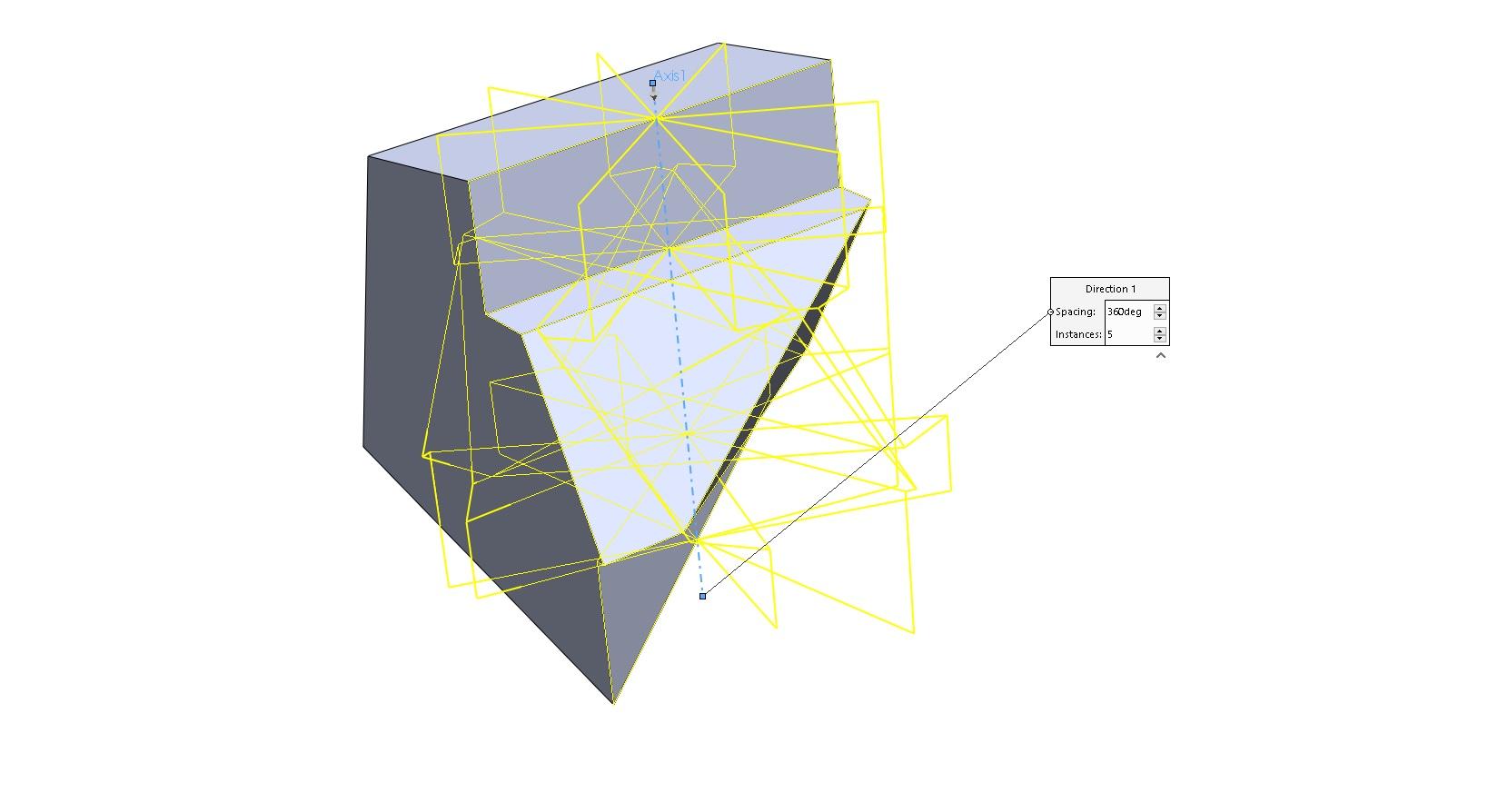

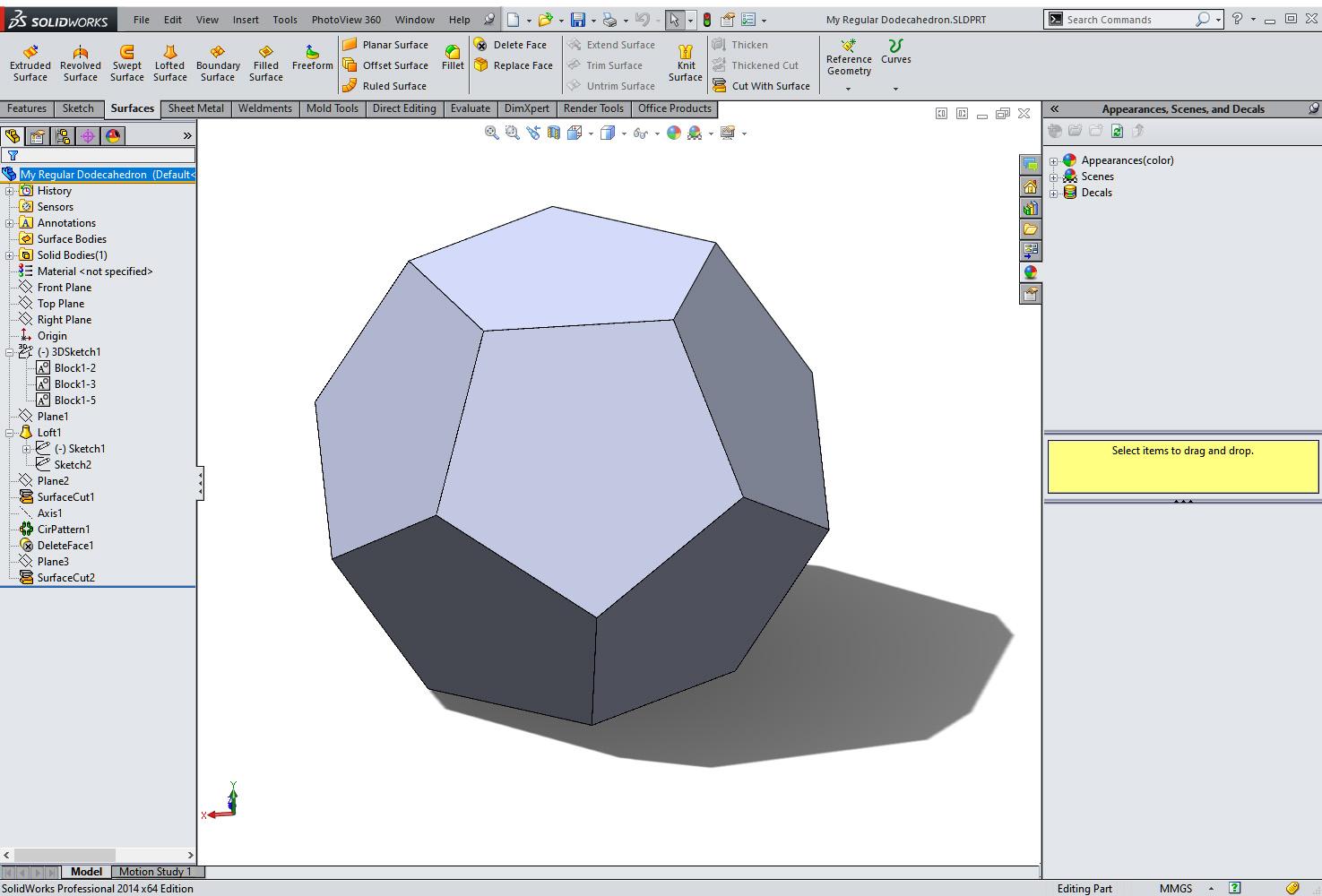

I invite you to use 3D software to create a regular dodecahedron. Ensure that each face is an equilateral regular pentagon, and that the angles formed at each vertex are equal.
I usually do this by assembling surfaces, but this time I used planes, two planer sketches, a 3d-Sketch, blocks, two surface cuts, a circular pattern and a delete face. Fun & Games :-)
https://grabcad.com/tutorials/construction-of-a-dodecahedron

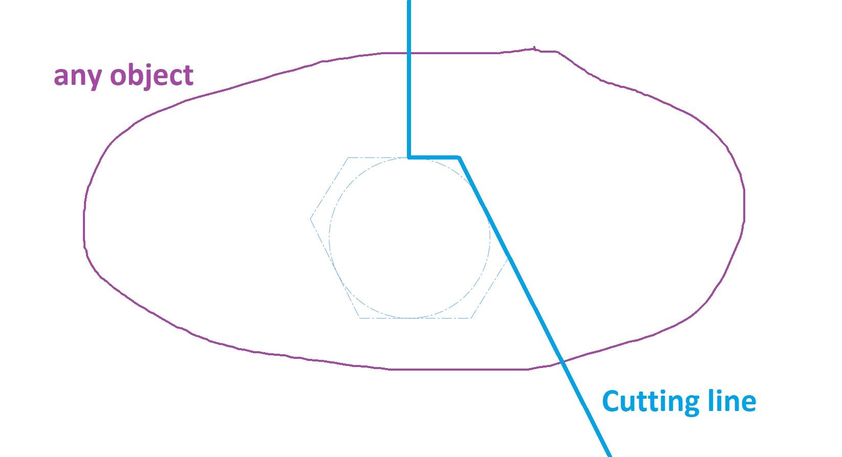

Simply as an exercise in "thinking of alternative ways" to achieve the same objective, I share this idea applicable to "any starting object":

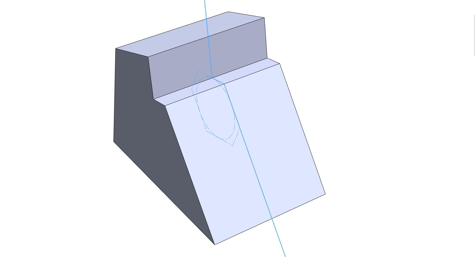

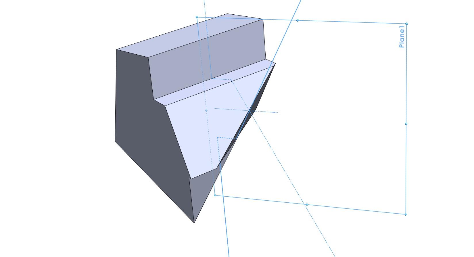

1) Make a cut in the frontal plane
2) Make the same cut, mirrored vertically, on an inclined plane
3) Make a circular array
Sometimes it is convenient to mould and other times to sculpt...

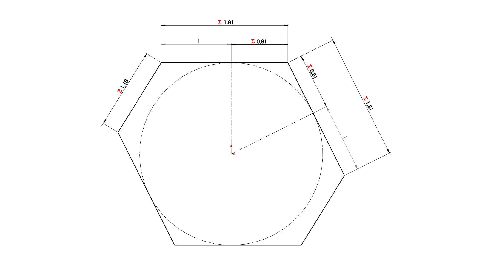

Can you please enlighten us, as to how you created the initial irregular hexagon(!) that you used for your cuts, without constructing the dodecahedron first ;-)

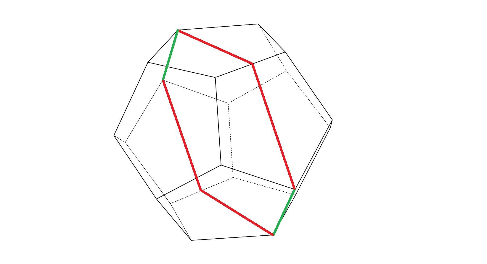

Hi Steen,
I made some observations about the final object:
1) Recognize the lengths of the sides of that irregular polygon. There are four long segments (in red) and two short segments (in green) whose lengths are related to each other in a regular pentagon:
2) Draw an irregular polygon with four long and two short segments, knowing that:
a) Each pair of segments are parallel to each other.
b) The long segments are tangent to a circle that passes through the center of each pentagon.
Note 1: the two short segments are automatically positioned based on the four long ones that are located according to a) and b).
Note 2: the radius of the circle inscribed in the long segments (which is that of a sphere that touches four pentagonal faces) arises automatically from lines perpendicular to the waypoints marked on said segments.

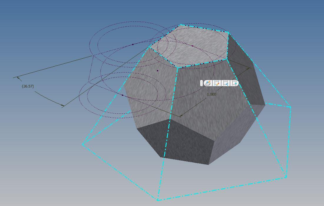

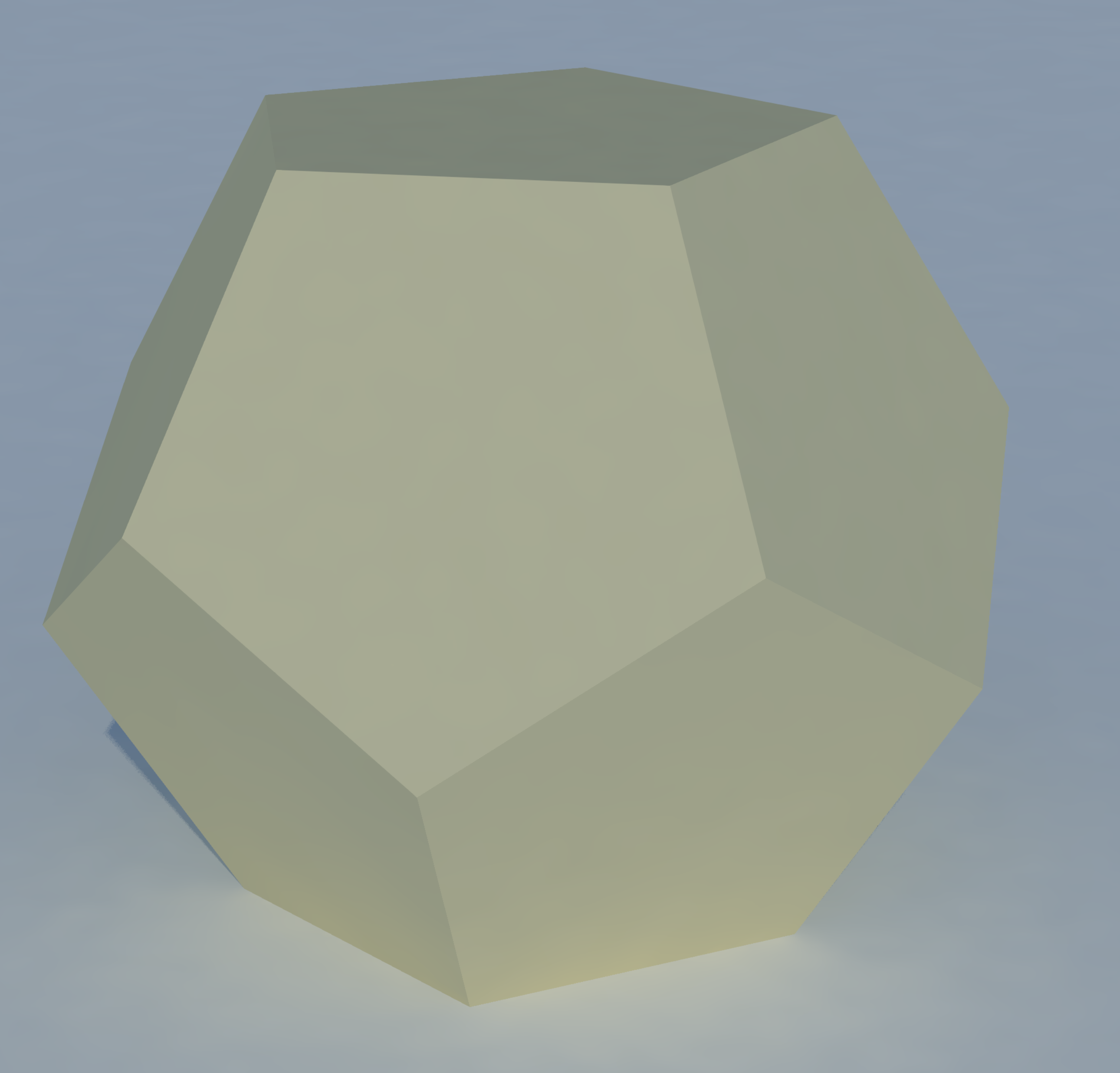

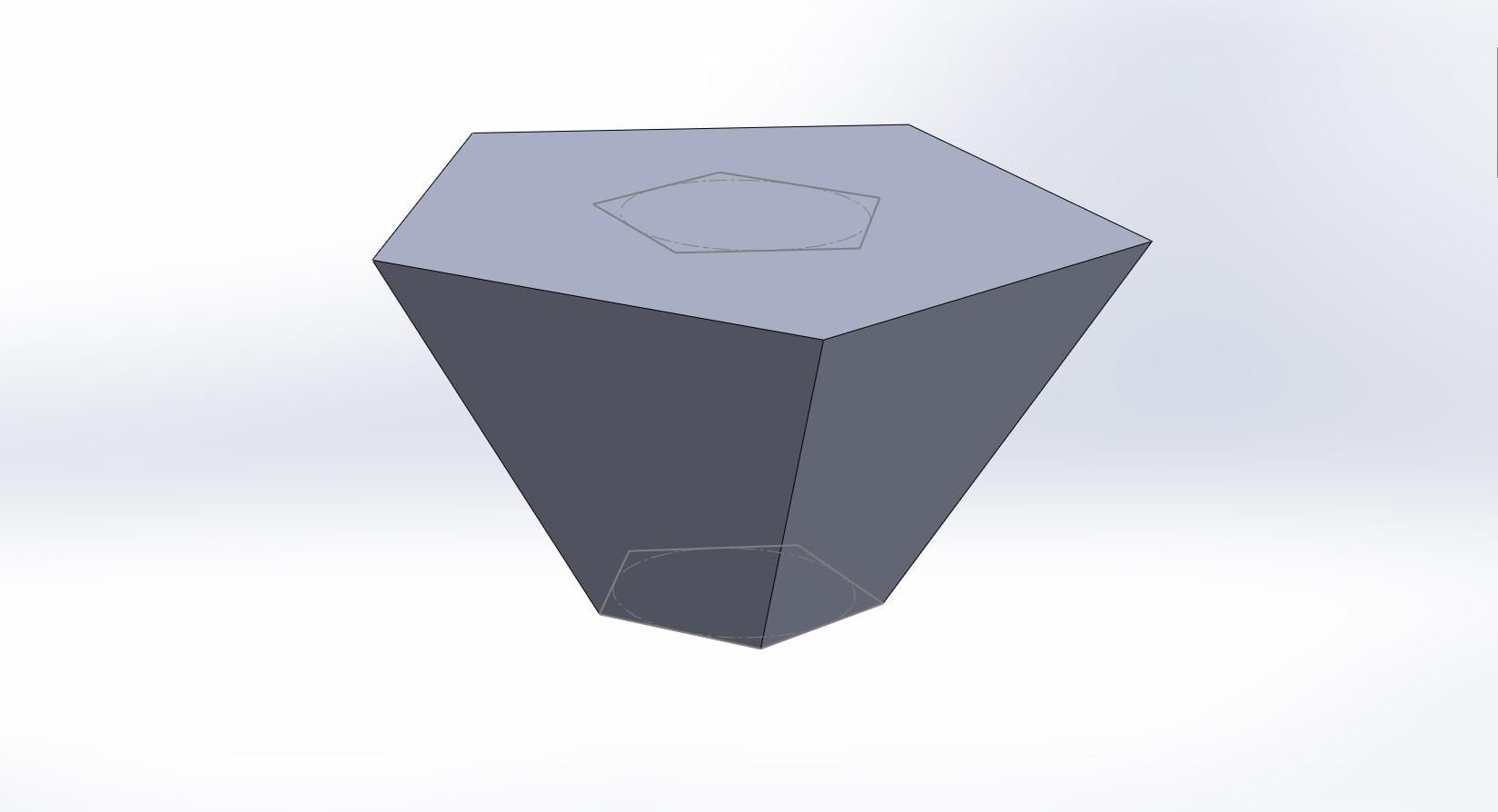

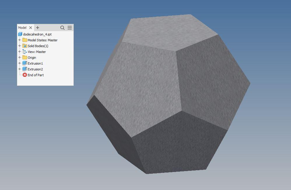

Had a dream about this over the weekend. Figured out how to do it by just extruding two simple pentagons. The key was letting the CAD system calculate the extrusion taper angle. The geometry is quite similar to what Marcelo did.
Inventor. 2 features

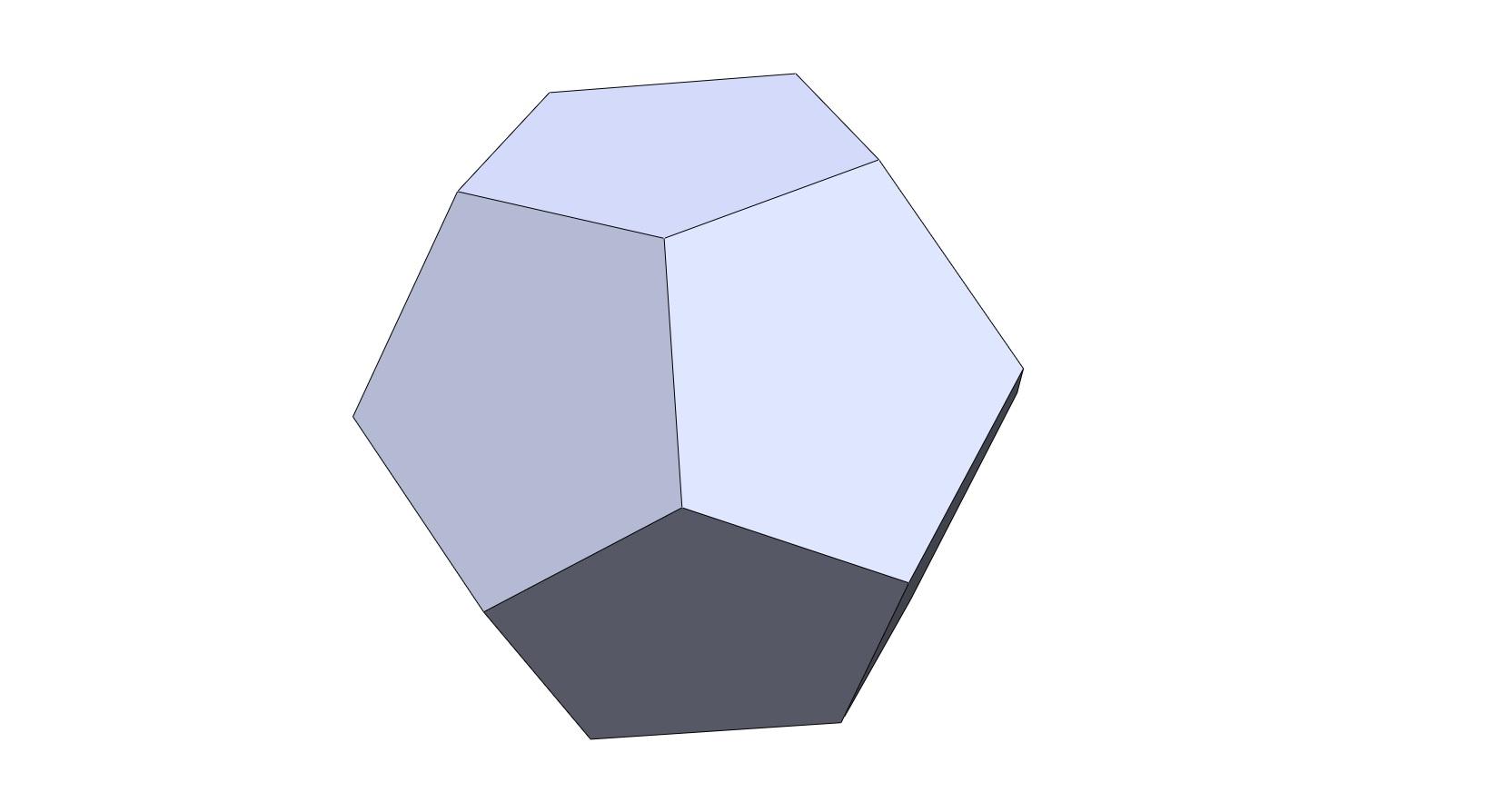

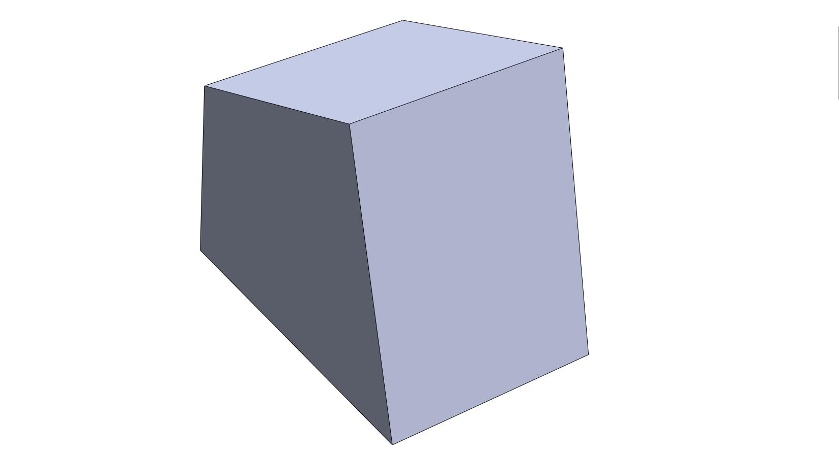

I'm not sure if it's the same as what Bob thought. But it is possible to extrude a pentagon with an angle, up to a specific height:
and then draw another pentagon on the top face and make an extrusion with cut, also at an angle, and voila!
Learning to design is learning to think!
That’s it! Although instead of a cut it’s easier to just use the intersection of the two extrusions.
It's true! Only (in Solidworks) you would have to do an extra operation to intersect the extruded solids. That's why I opted for the cut. Perhaps Steen knows if it is possible to do it by intersection in two operations.

Hello gents,
As far as I know, there are only the two options in Solidworks: 1) Extrude to correct height and cut-extrude with 'Flip side to cut' = two features, or 2) two extrusions and a boolean combine 'common' = three features.
