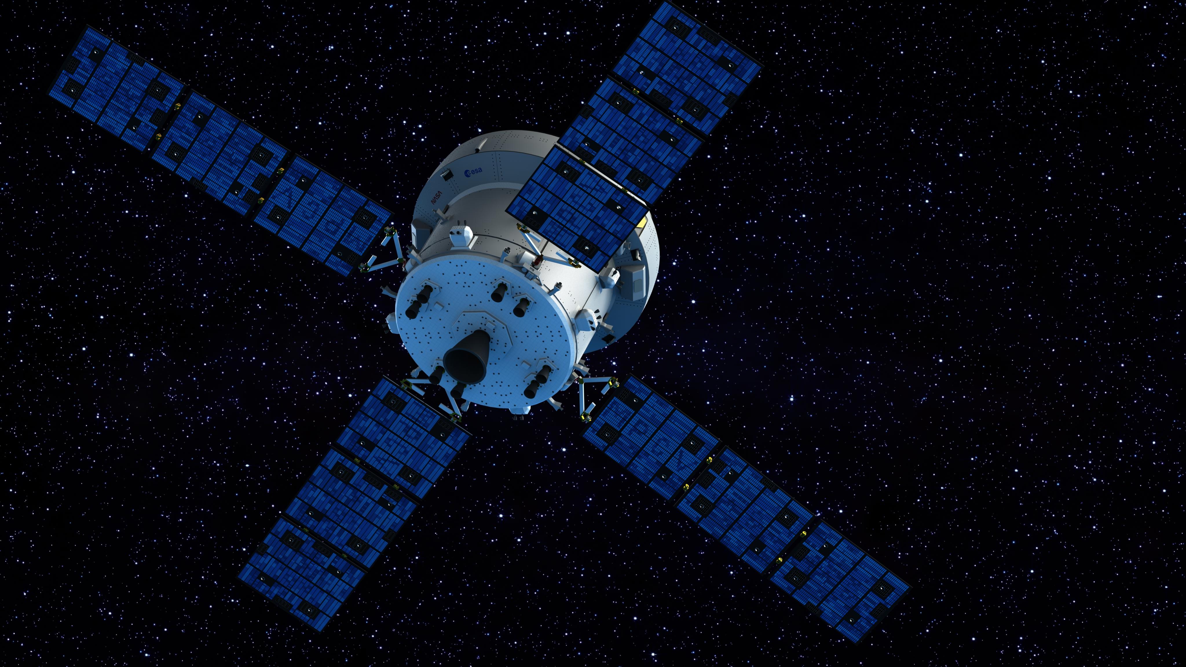

I'm working on an Orion Spacecraft Service Module and I've got to the bit where the Solar Panels need to open out, together. Each Panel starts with a Y-Frame which folds down with 3 concertinaed Panels attached.
I need the first panel to unfold out as the Y frame rotates down, then a second panel and third rotate out in sync until they are fully extended when the Y frame is at 90 degrees (but carries onto 120 if need be in the fully extended position). See the couple of pics ?
Then this needs "I guess" a Symmetric Mate, so the whole system operates on any of the 4 sides where the panels are connected ?

I can get 3 sets of panels moving in sync, but the last set of panel starts to hit a problem, wanting to break other mates when i apply the symmetry mate for the the middle panel.
I've put together a simplified set of parts and assembly if could look at at find an maybe find an elegant solution. Much appreciated. πŸ‘ I hope the angles at which i have left the panels ,explains enough how it unfolds. Would appreciate if you could figure out what i'm doing wrong, or simply find a solution I can reverse engineer.
I've included a picture of the actual model too ... just for reference.

At long last ... got the symmetric mates to work, just as I was about put a video together ... so thanks for offers to help. I’ve put another request out for help with motion capture this time. Hope to get some more help there πŸ˜€πŸ‘
Got there in the end ... thanks again for your support
