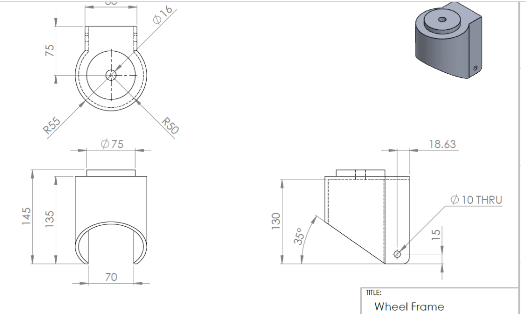

Can any one explained how to do a wheel frame
pls can any one help me

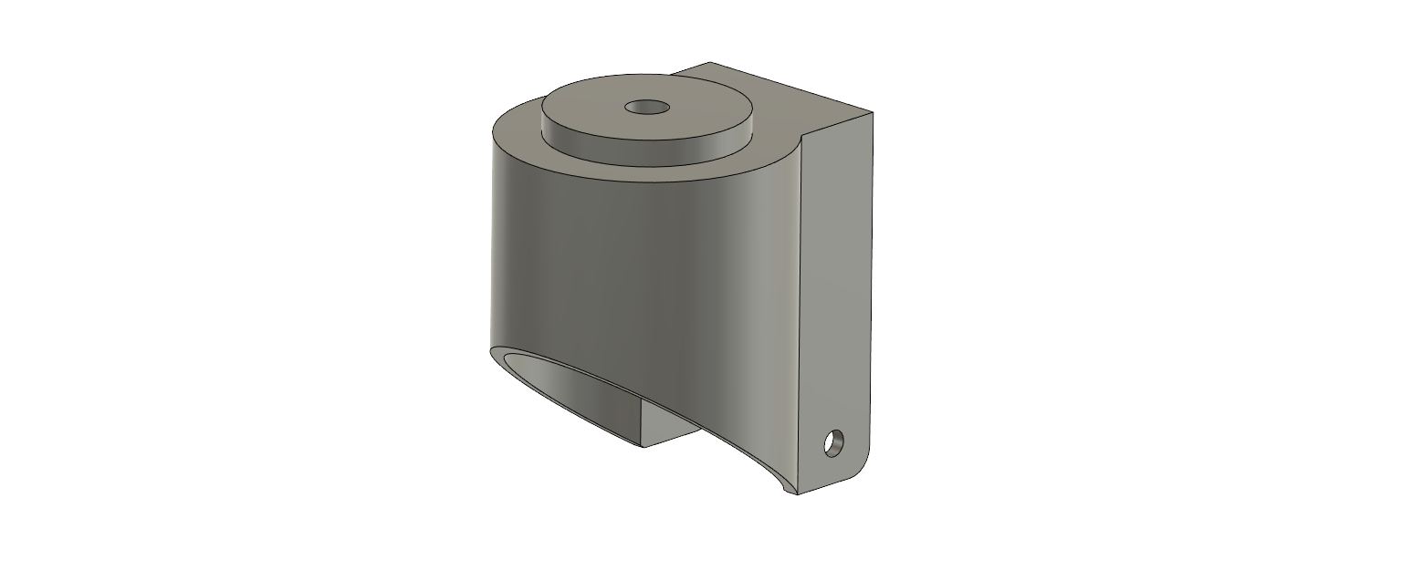

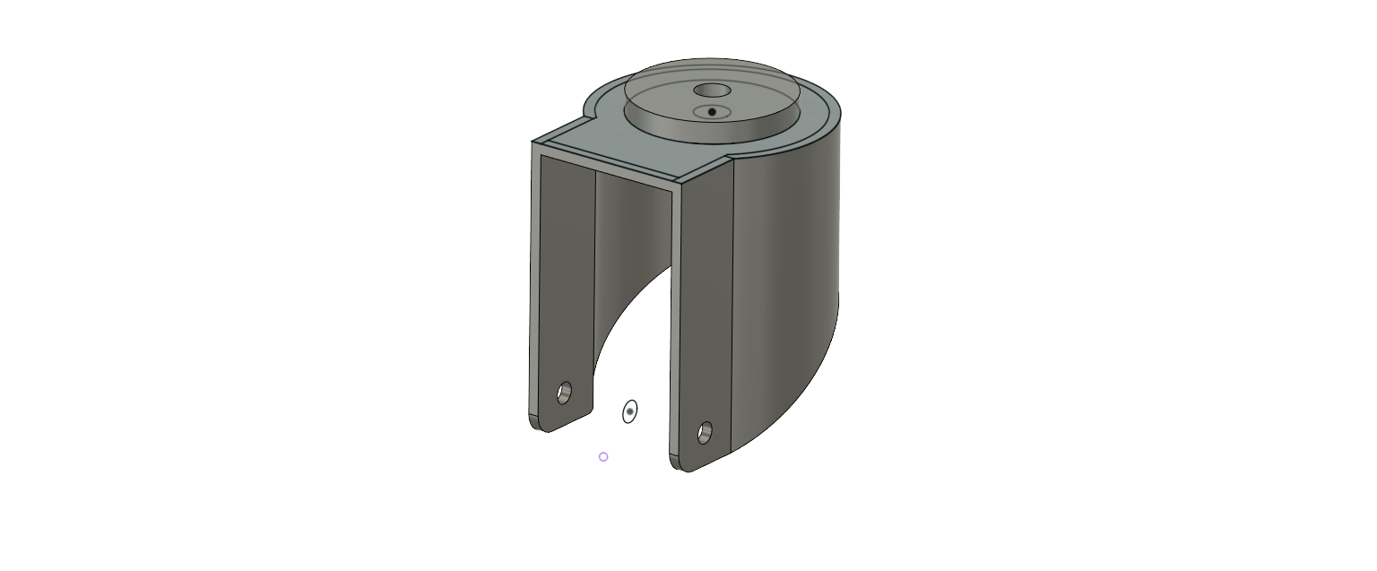

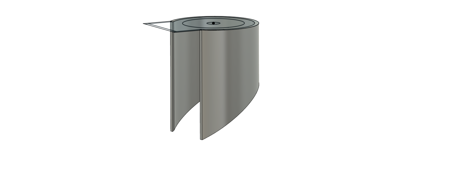

Alternative way with only 2 sketches.
Main Body Sketch.
Draft Angle by only extruding the circle.
Top and side walls and boss extrusion.
2nd sketch for holes with symmetric cut. fillet added to solid.
Final part.

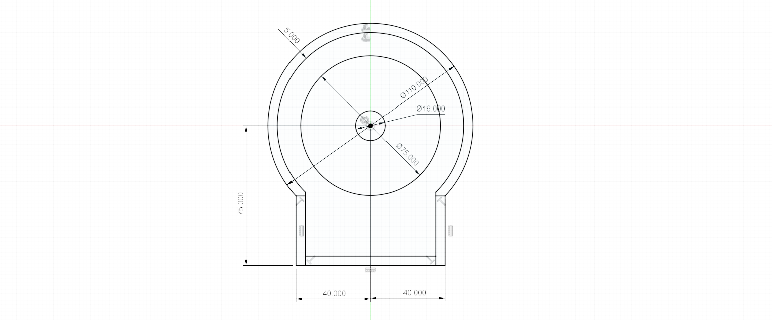

Hi!

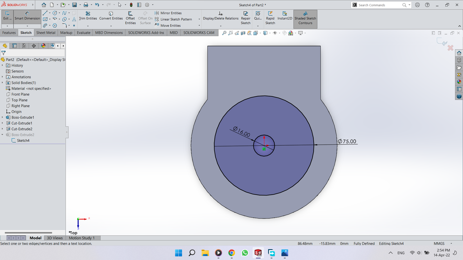

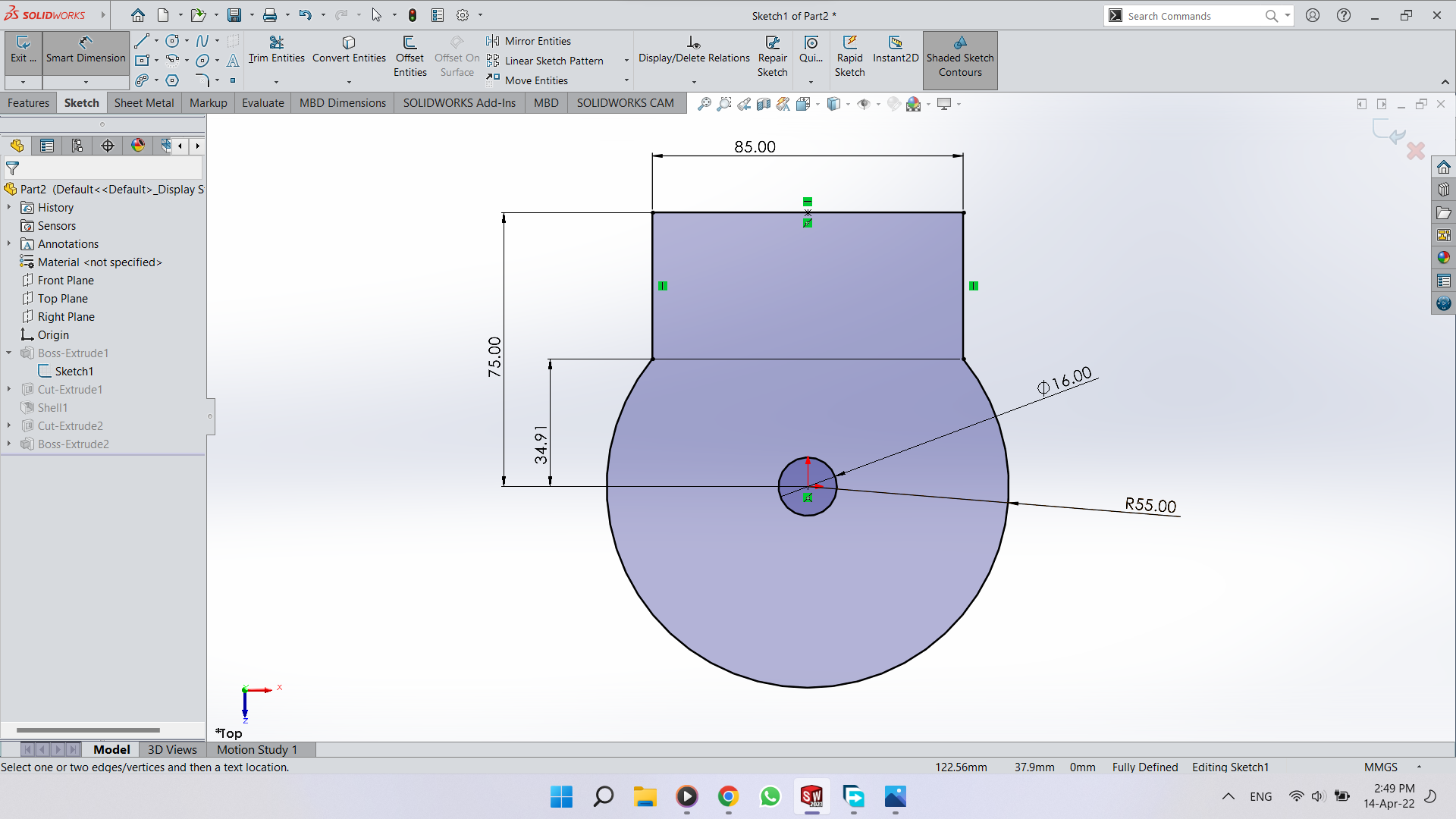

First of all, I select the top plane and draw concentric circles with a diameter of 16mm and another with a radius of 55 mm, with a distance of 75mm from the center of the circles, I draw a horizontal line 85mm. (Photo No. 1)

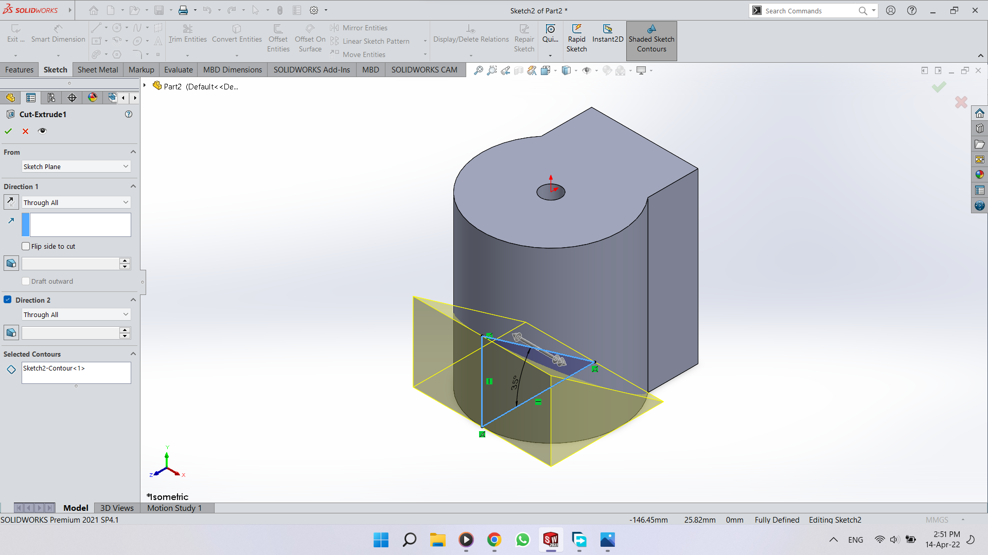

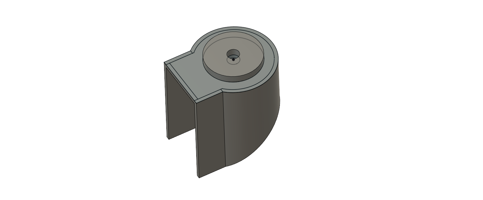

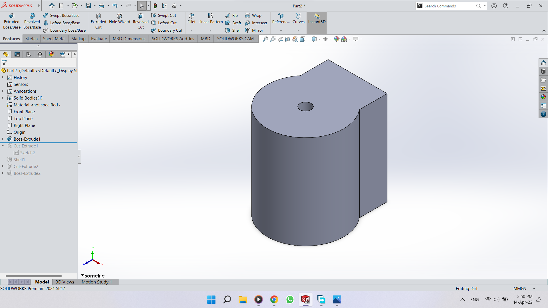

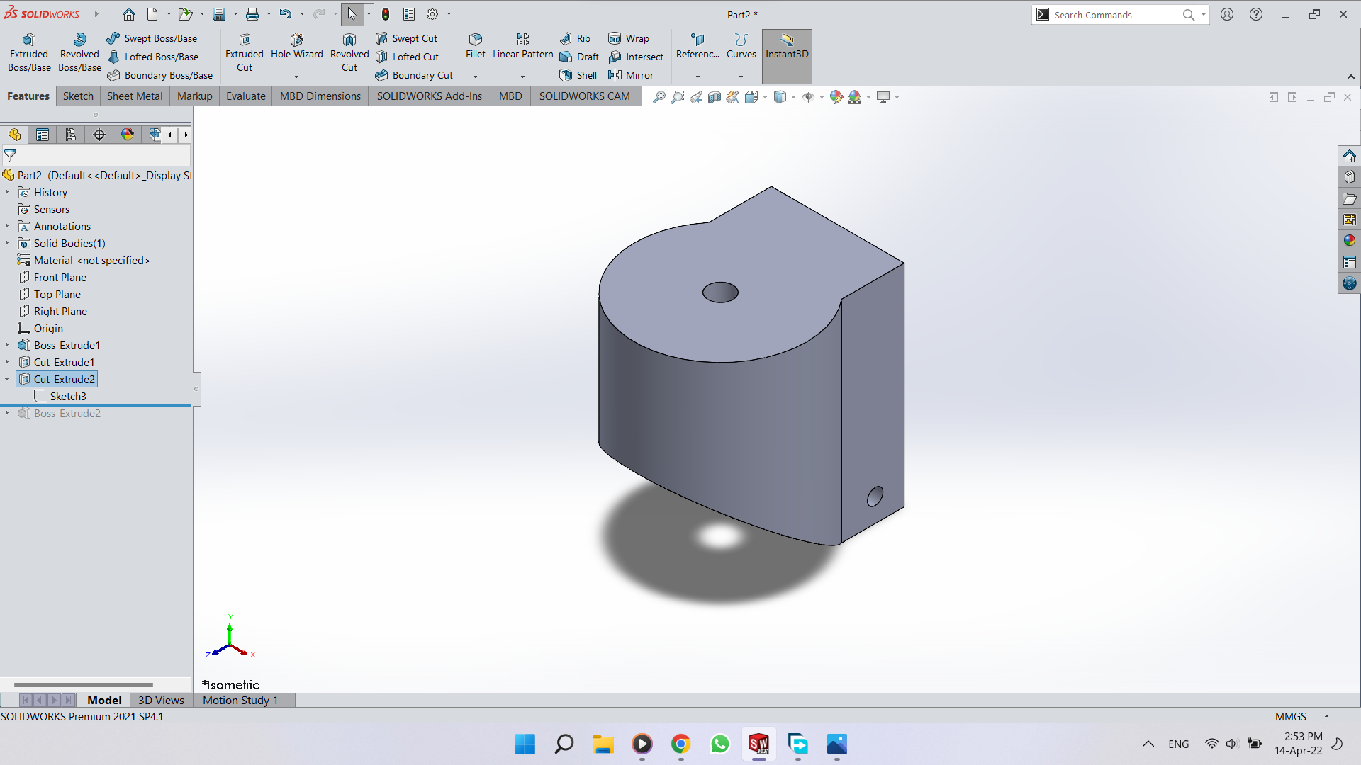

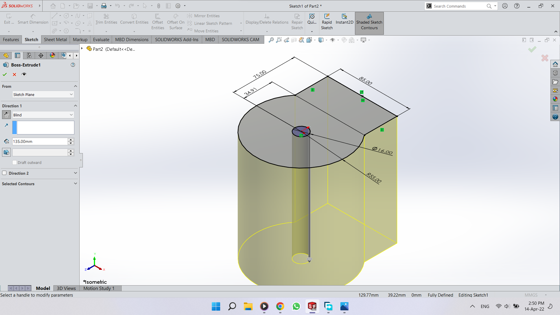

I extrude the sketch 135 mm (photo number 2). Result (Photo No. 3)

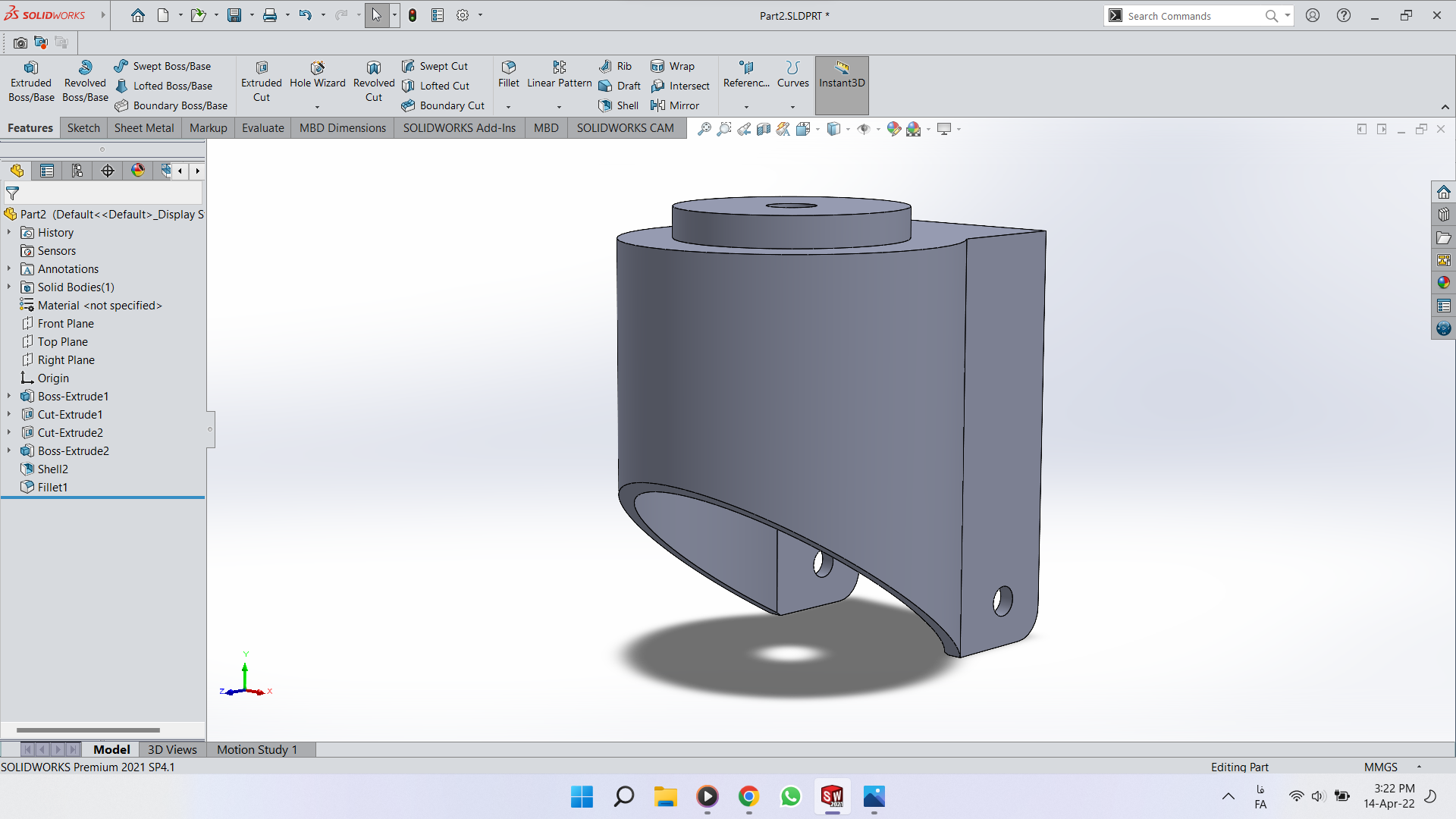

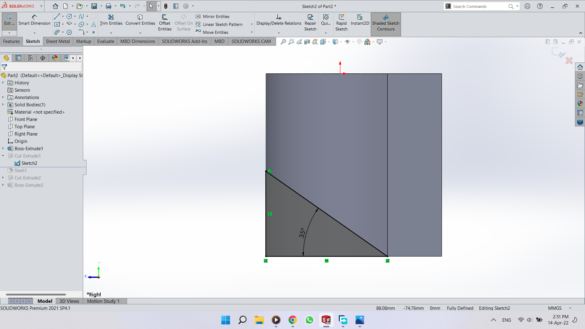

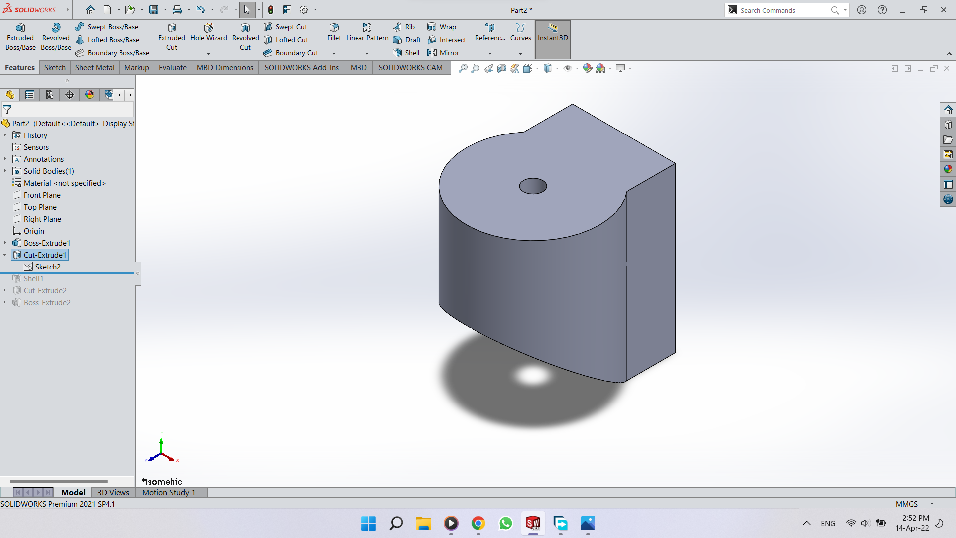

Step 2: I select the right plane and draw the new sketch according to the given angle. (Photo No. 4) and then cut-extrude (Photo No. 5). Result (Photo No. 6)

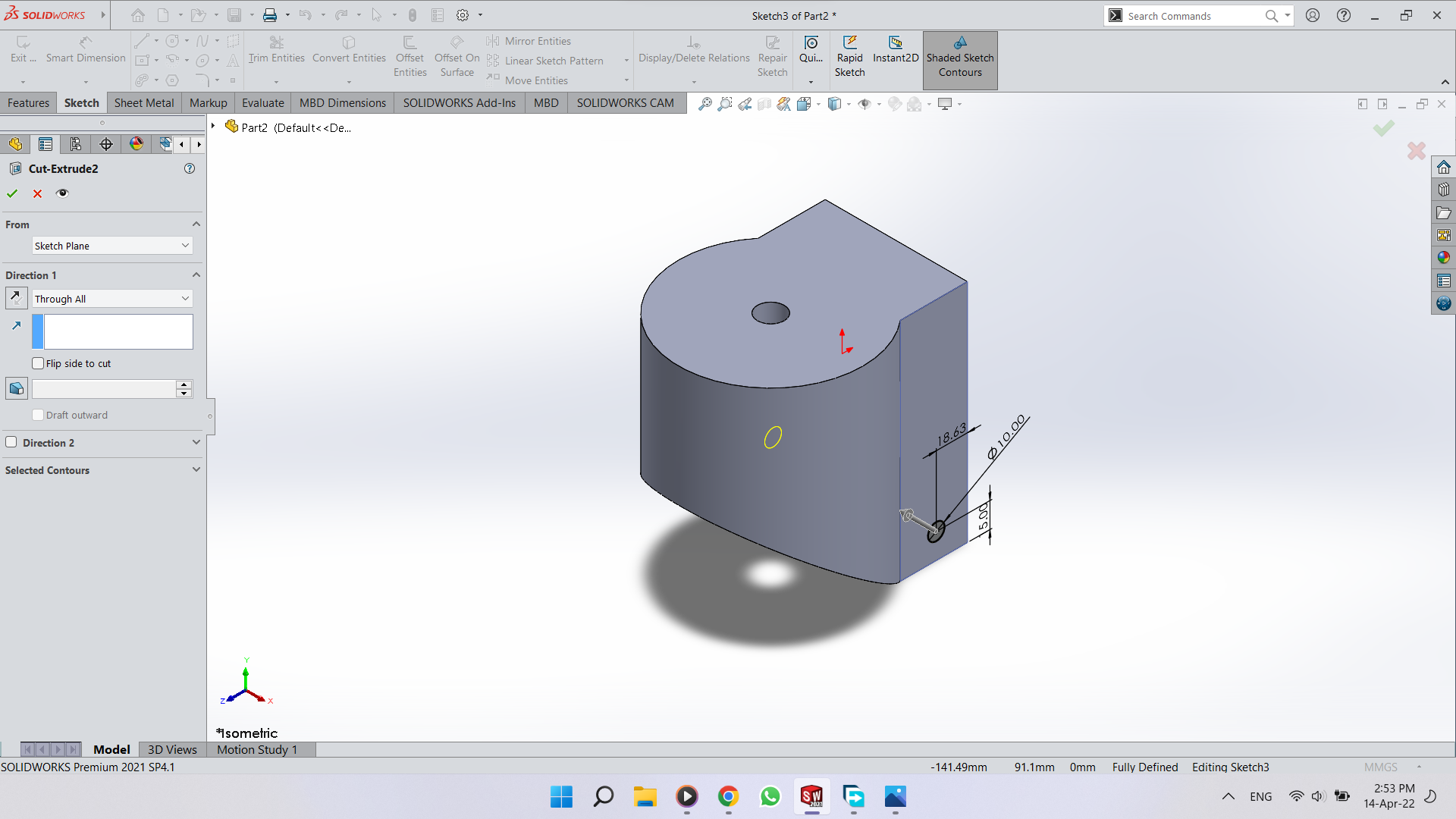

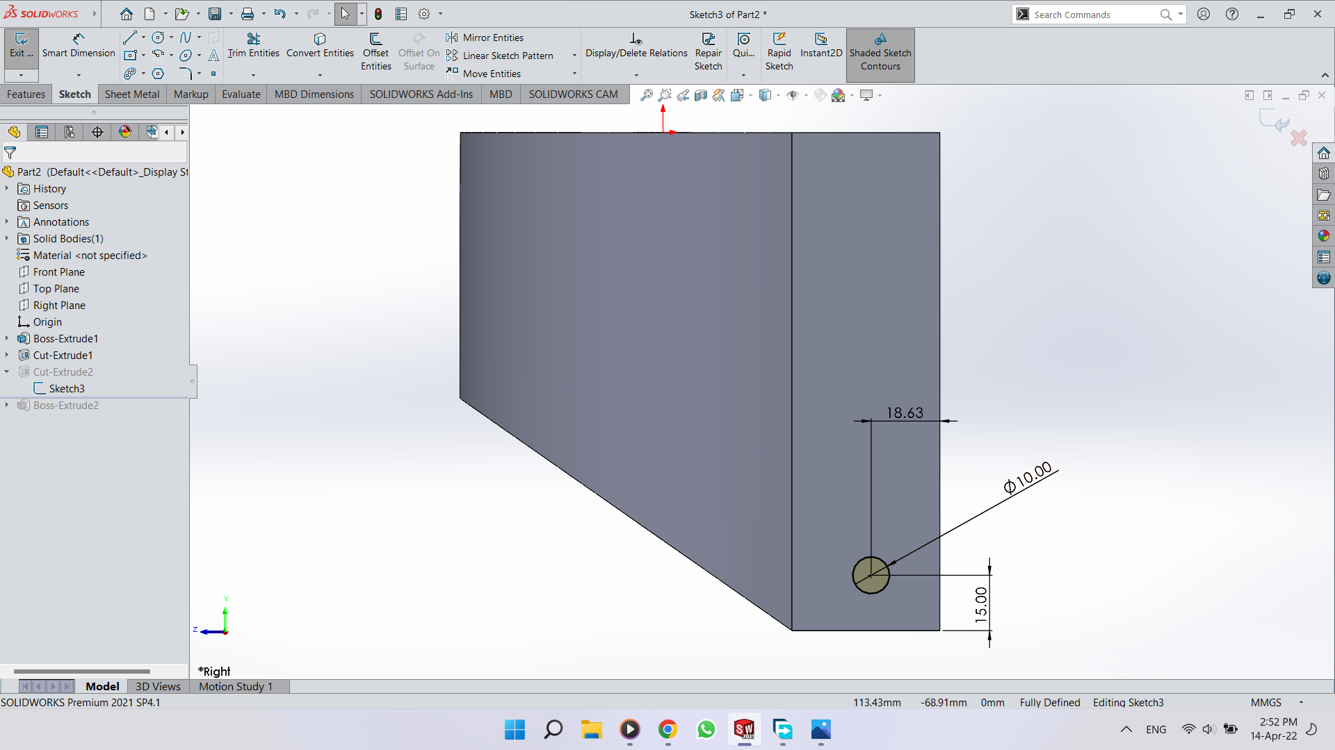

Step 3: I consider the right side of the model as a sketch plane and draw a circle with a diameter of 10mm. (Photo No. 7) and cut-extrude again (Photo No. 8).

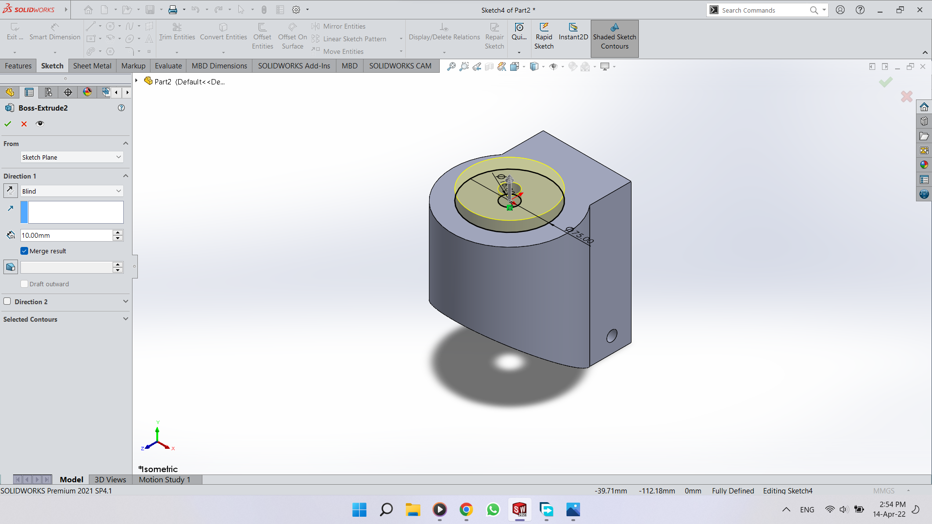

Step 4: I go to the top of the model and draw a circle with a diameter of 75 mm and another with a diameter of 16 mm that is concentric with the other circles (photo No. 10) and extrude to 10 mm (photo No. 11). Result (photo No. 12)

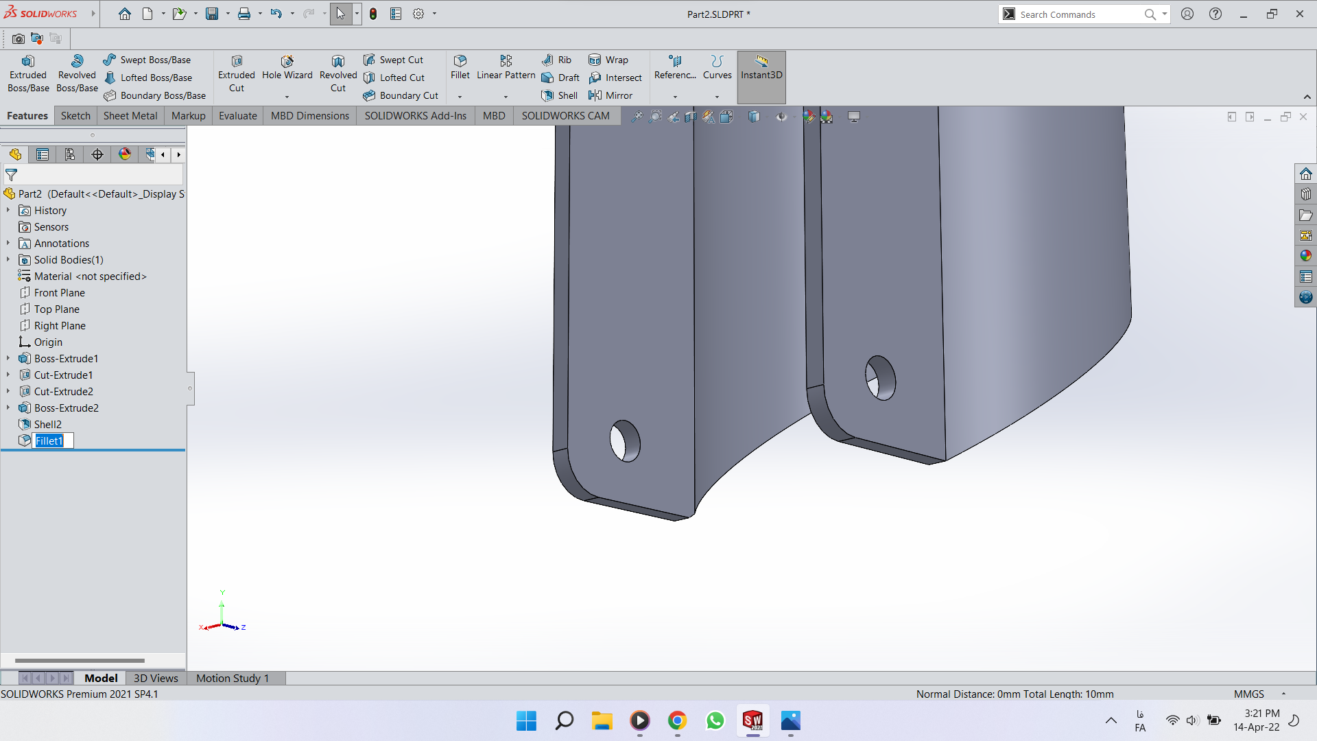

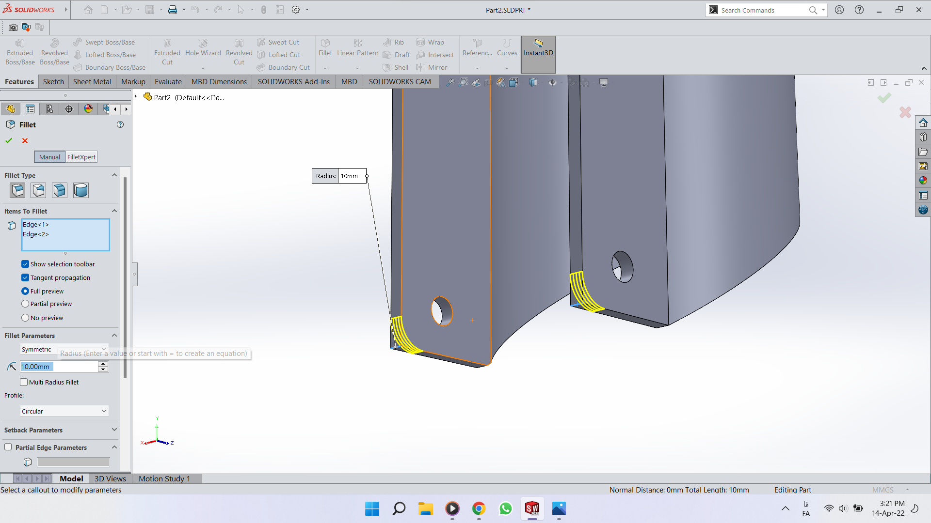

At the final step, "Fillet" with a radius of 10mm for the two corners of the model. (Photo No. 15). Result (Photo No. 16)
Design completed (Photo No. 17)
