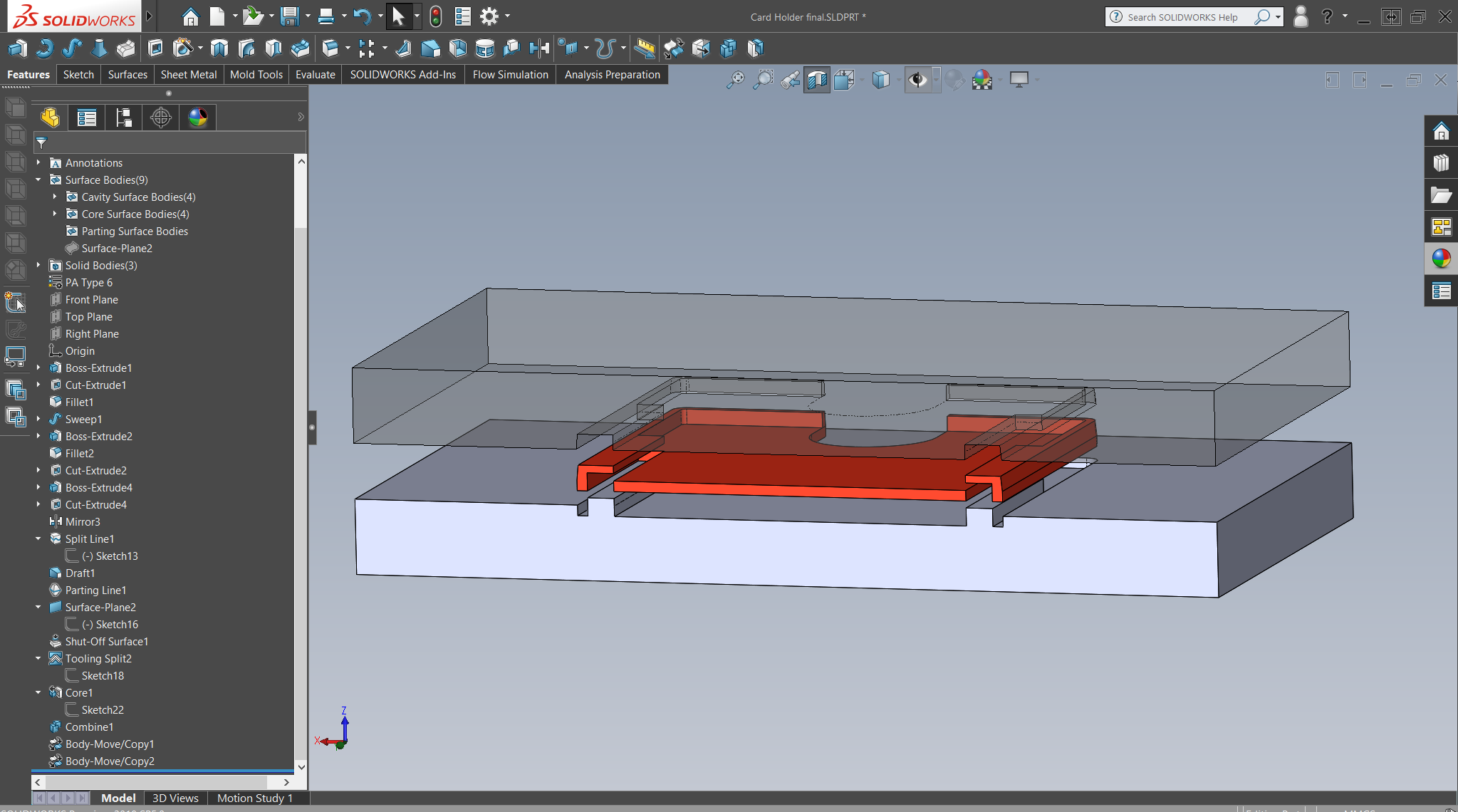

Can anyone please make core and cavity for the part below. Please its urgent.
The part is an ID card Holder

One approach is to ignore the trapped plastic until after the tooling split, and then use 'split' and 'combine' features, or more properly, the 'core' feature to get the steel to the proper side of the tool, however, there is still the issue of some zero draft surfaces and zero shutoff angle for the cores that form the overhanging tabs.
