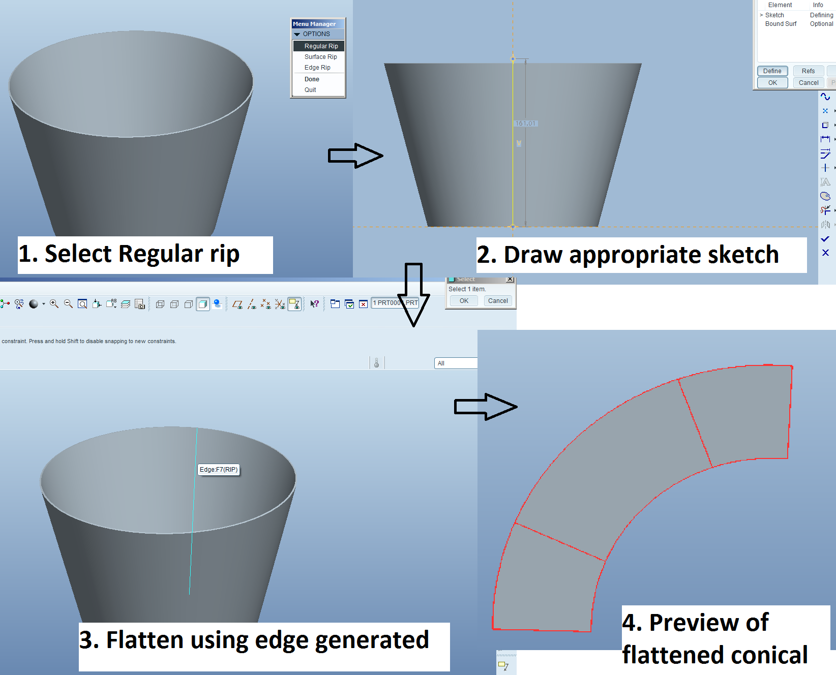

Can we rip a conical sheet in Pro/E? If so, how?

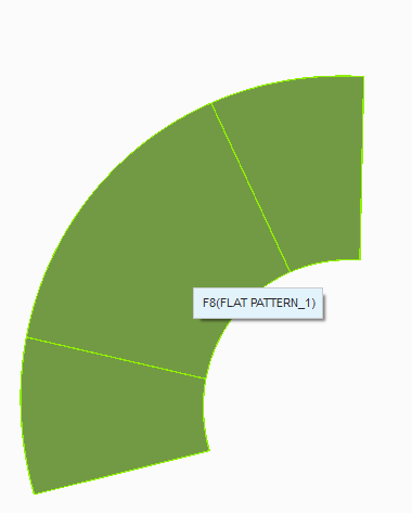

You can rip the conical sheet with help of sketched rip feature.
in_creo.png in_creo.png in_pro_e.png in_pro_e.png flattened_sheet_after_rip.png flattened_sheet_after_rip.png
