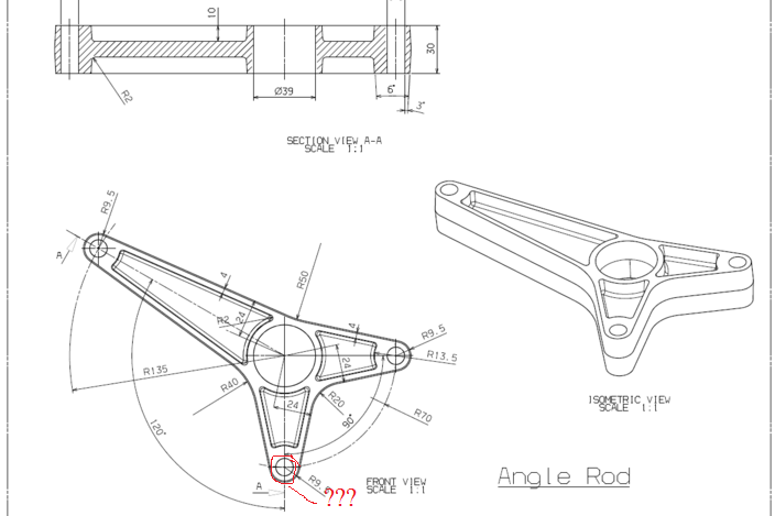

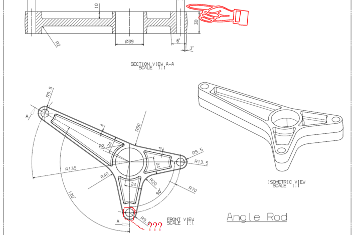

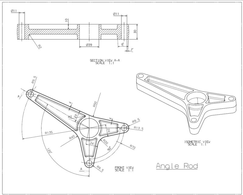

Diameter Dimension hasibul shovon 27 Mar, 2019 06:04 AM Can't find the circular dimension in the pic. Help me please. dia.png 4 Answers hasibul shovon Answered on 27 Mar, 2019 02:22 PM I just have drawn it and then measured that its dia is 13. CadCloud medium.SLDPRT Adam Snow Answered on 27 Mar, 2019 10:56 AM 11 large.png CadCloud Answered on 27 Mar, 2019 07:09 AM Have you got the complete drawing ? Because the Diameters are on the Cut view at the top original1.png hasibul shovon Answered on 27 Mar, 2019 01:13 PM Thank u very much everyone. I got the dimension. its 13
