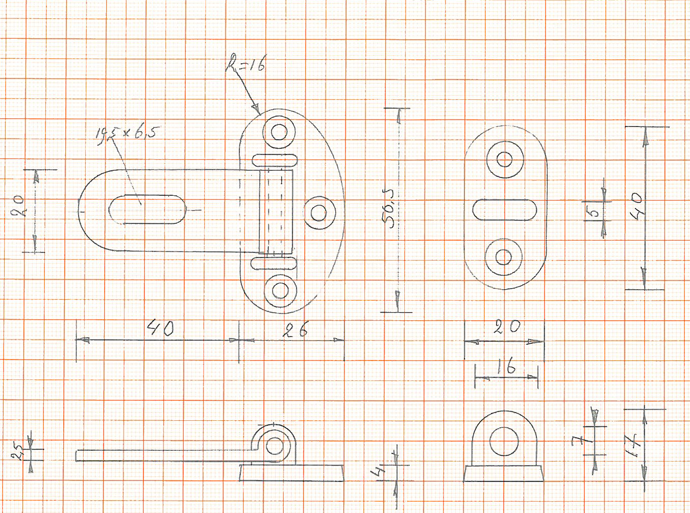

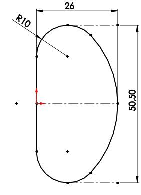

Draw a box hasp Ravindu Dickwella 27 May, 2020 07:10 AM Can anyone help me to draw the following box hasp? 2233.png Accepted answer SolidTweaks Answered on 27 May, 2020 10:20 AM To me it appears to be a mistake. R10 makes more sense here. R16 will make the fillet larger than the width(26mm) 123-16.jpg 123.jpg 0 Other answers
