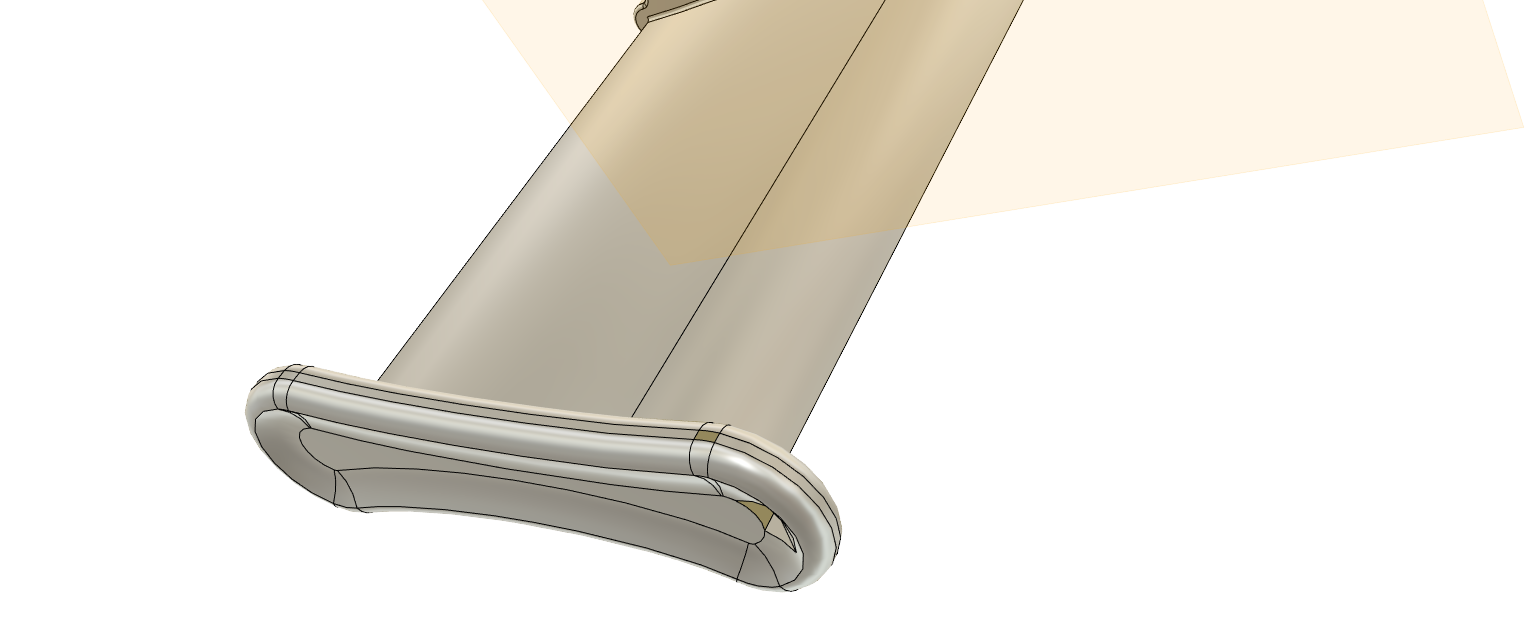

Extrude Cut- Autodesk Inventor 2022 shaun dickson 26 Feb, 2022 08:26 PM I am trying to Extrude cut a profile out of a wing end-plate for a sports car. the first side worked fine. but 'cut' is no longer an option when on the other side. I am new to Inventor, so not sure whats gone wrong. Any help would be welcomed! Z33 mk1 wing.ipt Accepted answer Carlos J. Veloso Answered on 27 Feb, 2022 01:52 PM Do what I did, create a plane on the center of the model and mirror using it. Z33 mk1 wing Left.png 0 Other answer
