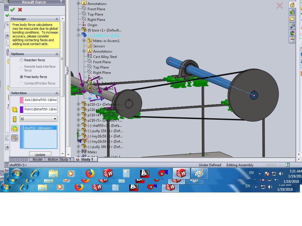

hi everyone ,
i have two pulleys which are connected through belt , the diameters are 150 mm and 300 m
the question is that when i apply torque 10 n-m on 150 pulley i should get torque 20 n-m on the center line of the 300 pulley " or i think though " but the torque is reduced ?
can any one tell me why that , and the right way to get that resultant torque is by using solidworks simulation , or solidworks motion analysis
