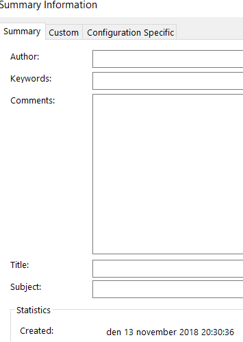

How can I change the creadted date in solidworks? Mansoor 9 Sep, 2020 03:23 PM Hi Hi how can i change the creation date of a file downloaded from here. Capture.PNG 1 Answer Yahya T Khedr Answered on 9 Sep, 2020 04:45 PM You can't change the date/time of creating the file. You also can't change/remove the designer's name. All you can do is just make another copy (Save As) and it'll be with your details.
