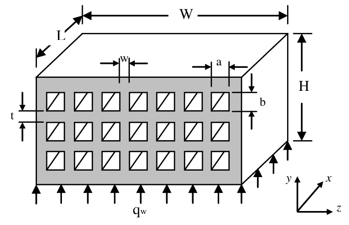

How can I draw this multilayer heat sink using solidworks?
I am wondering if you can help me drawing this multilayer heat sink. Many thanks in Advance
2 Answers
Step 1- Create an 'Extruded Boss/Base' feature of the rectangular block defined by the L,W,H dimensions
Step 2- Make an 'Extruded Cut' feature for the opening defined by the a,b dimensions
Step 3- Create a 'Linear Pattern' feature to pattern the extruded cut from step 2 in the y and z directions. a+w = the z direction pattern increment, and b+t = the y direction pattern increment.
