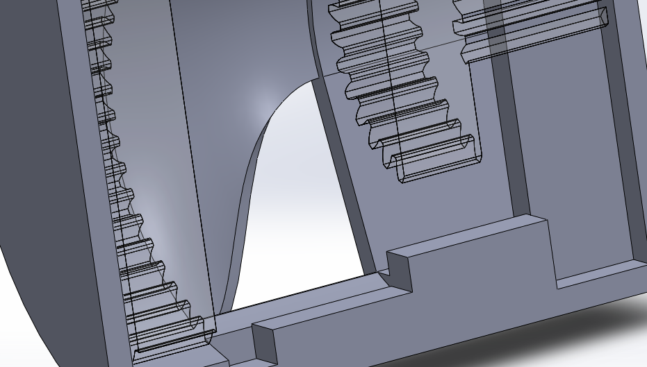

How can I fill a complex gap on a body?
Hello all, I somehow created a gap on a body which will be a case and I do not know how to fill it. Thank you all in advance for your helps :)
2 Answers
Try using the 'boundary bass/bose' or 'boundary surface' plus 'thicken' feature.
Roll back the feature tree until the feature which made the hole is found. Examine the sketch(s) used to create the feature. Examine the settings of the feature. Decide if it is possible to repair the feature, or if another method to create the desired geometry will give a better result.
