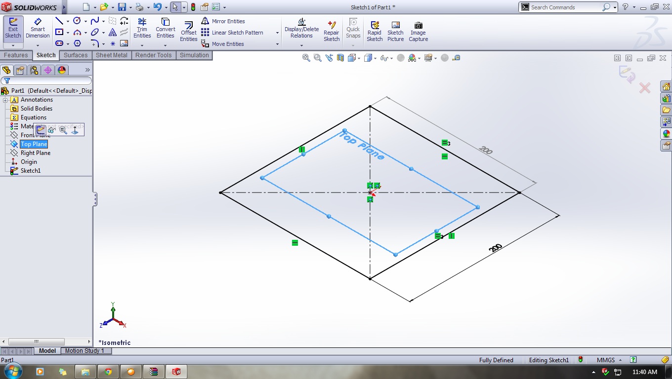

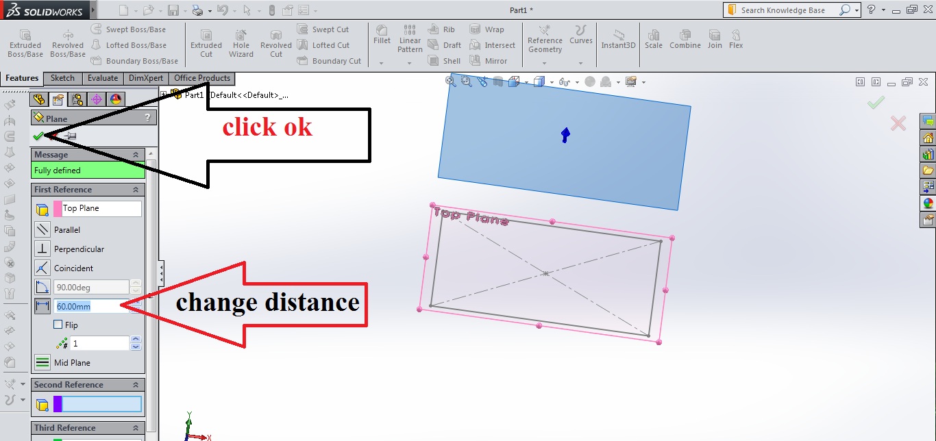

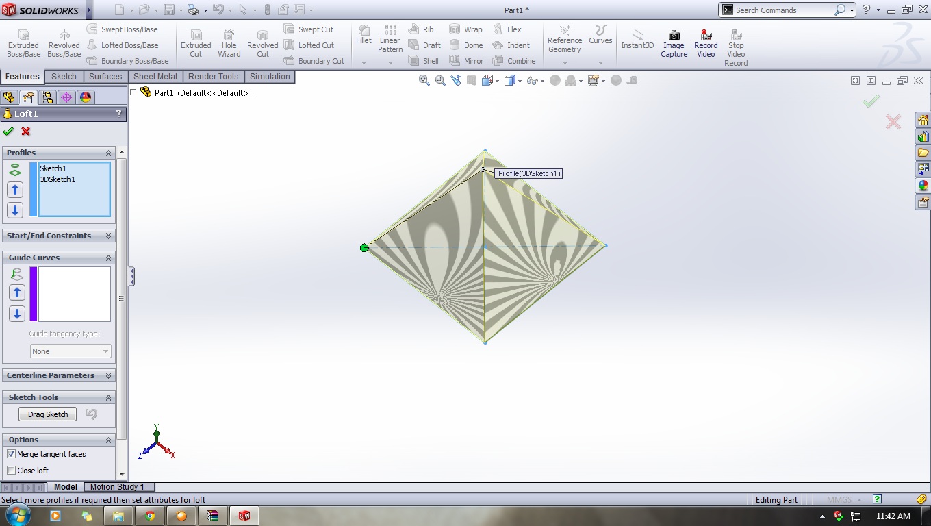

On the front plane, sketch a central rectangle, close sketch, open a new plan 100 mm above, open a new sketch and put a point in the midle of origem, close skecth and do a loft. Done.
4 side pyramid can be created using a rectangle and a point in 4 steps as below...
