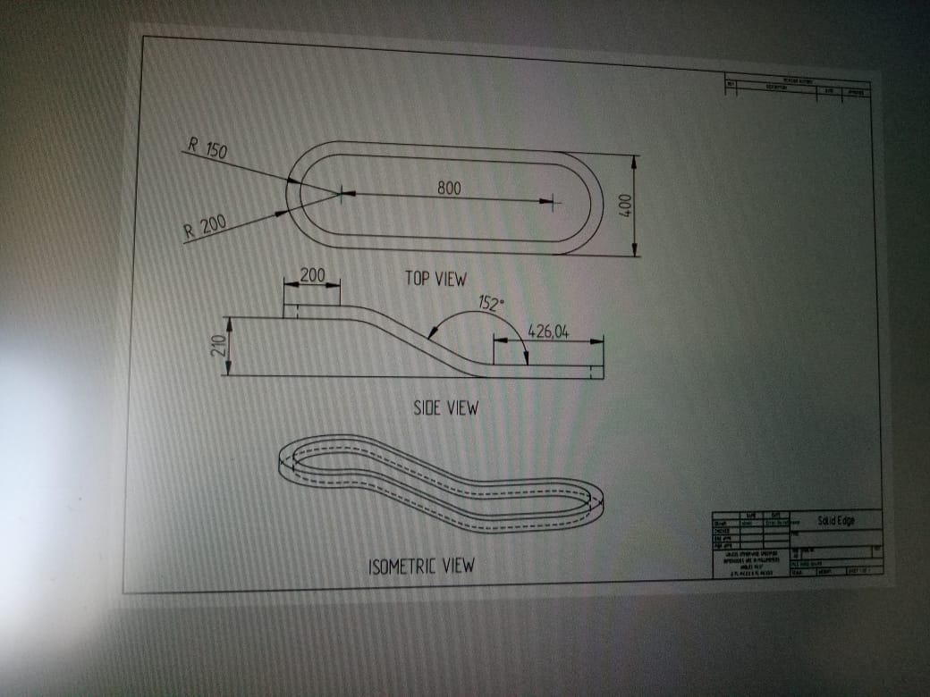

Hi friends, I need to build a belt driven turn table conveyor. Please suggest.

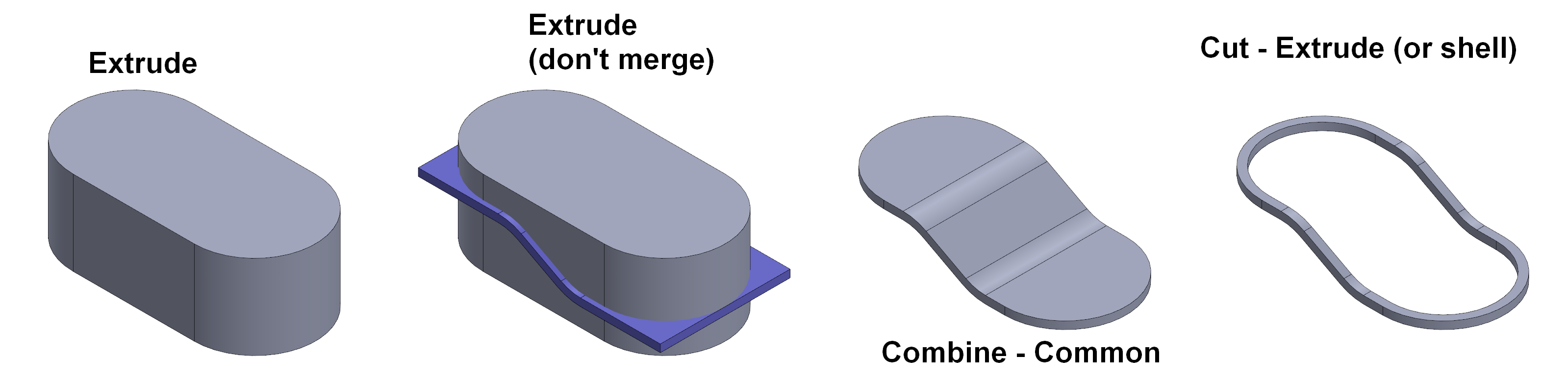

As Robert suggests, there are multiple ways to make this part. No way is really better than another, but they make use of different features.

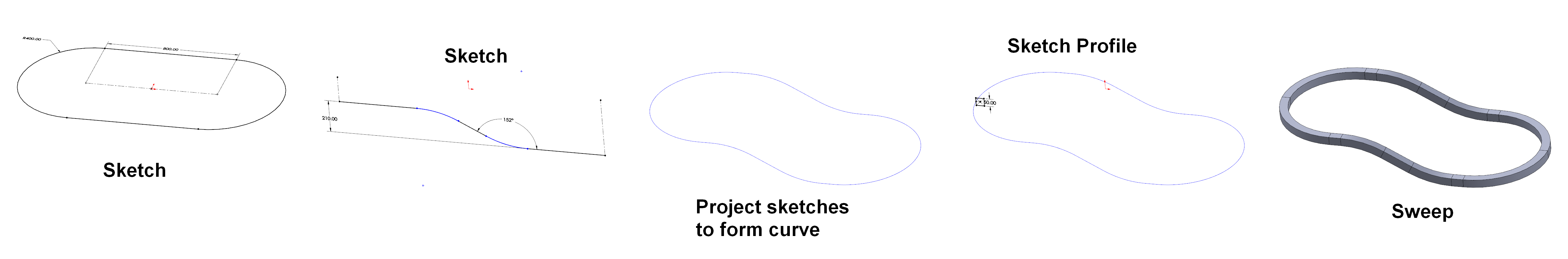

I'd also make it with a Sweep feature. But doing so is likely the more complex way.
The "drawing" provided does not seem to give enough information, I just left some of the sketches under defined.
Image attached with the steps.
A second image is attached showing an alternative construction method.
