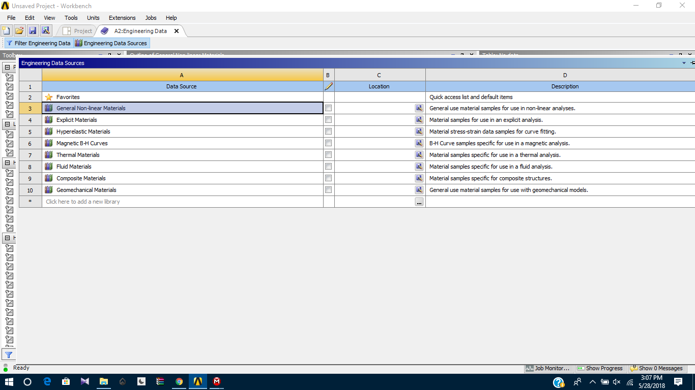

How do I get back the General Material Row? GHANSHYAM DHAMAT 28 May, 2018 09:40 AM I deleted the General Material row in Engineering data Sources in Ansys 18.0. Screenshot (49).png 1 Answer Ananth Narayan Answered on 29 May, 2018 05:14 AM Here is the solution: 1. Goto view and try these following > Reset workspace > Reset window layout This will reset all layout and you can able to see the all windows that you want to
