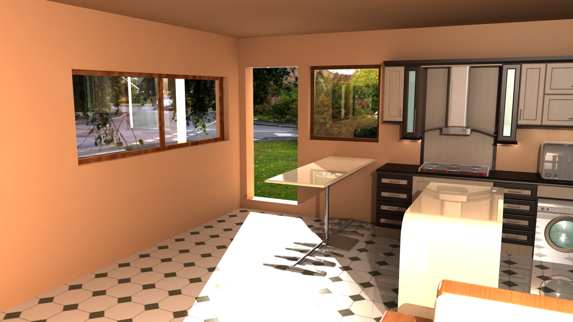

Can anyone help me, i am a student and i need these renders done for a presentation. I keep getting these issitating spots or (pixelated) renders. I added a point light to the area aswell as a point light outside the door and adjusted the lighting to the way i wanted it but the image quality is very poor and i have my final render settings on Max and my caustic settings are also maxed. Please can Anyone help.

i fixed the problem. For some reason it was the radius of the lights that created the problem. I was playing around and i set my light radius to 0 again and it seemed to work. Thank you for all the answers. The render i attached shows the end results which arent perfect in terms of lighting but i still have to play aroung to get the lighting right again afteri changed the setting =]
