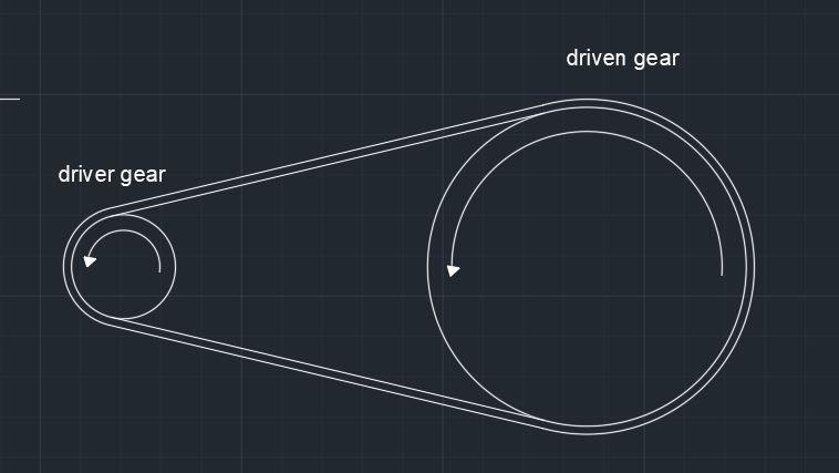

How do you increase the speed of the driven gear without making the drive gear larger?
we know the principle with gearing, ''To increase the speed of the output the driver gear is larger than the driven gear. (This will increase the speed of the output but decrease the “torque”.)
Now I have this setup. (See photo) How do you ensure that the speed of the driven gear increases without having to make the driver gear larger?
(The two gears must turn in the same direction)
3 Answer
Given the components you have shown: If you want it to turn faster without increasing the diameter of the drive gear then the only solution is to make the driven gear smaller
