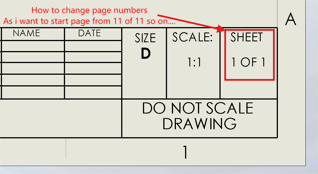

As I am working on a drawing where I need to prepare 40 sheets, but due to a heavy model, I decided to make 10 sheets in one 2D drawing. When I create a new sheet for the next 10 sheets, the page number starts from "SHEET 1 of 1...". However, I need it to start from page 11, 12, and so on. Could someone suggest a method to change the page numbers as I want, or should I do it manually? Please suggest.

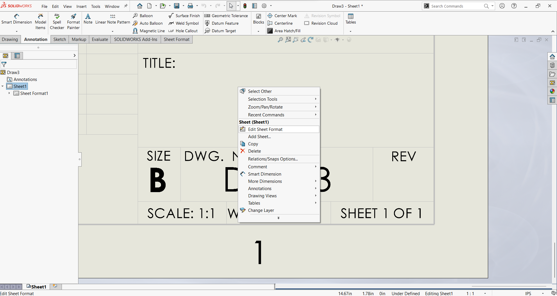

1) RIGHT CLICK ON THE SHEET AND CLICK ON SHEET FORMAT OPTION

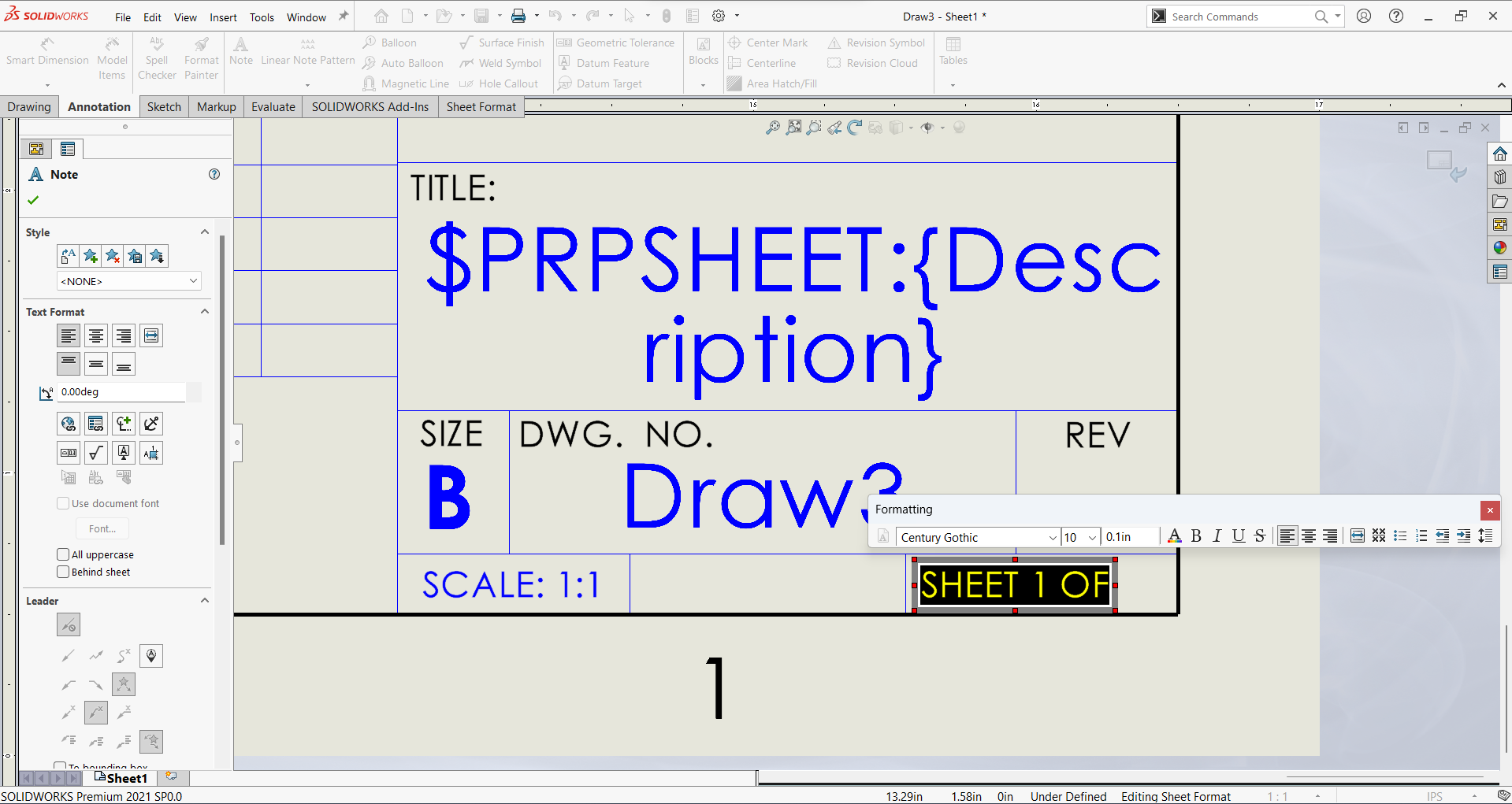

2) THEN EDIT TEXT AS SHOWN IN IMAGE AND CREATE NEW TEXT BOX FOR LAST NUMBER IN (SHEET 1 OF 1) TEXT.

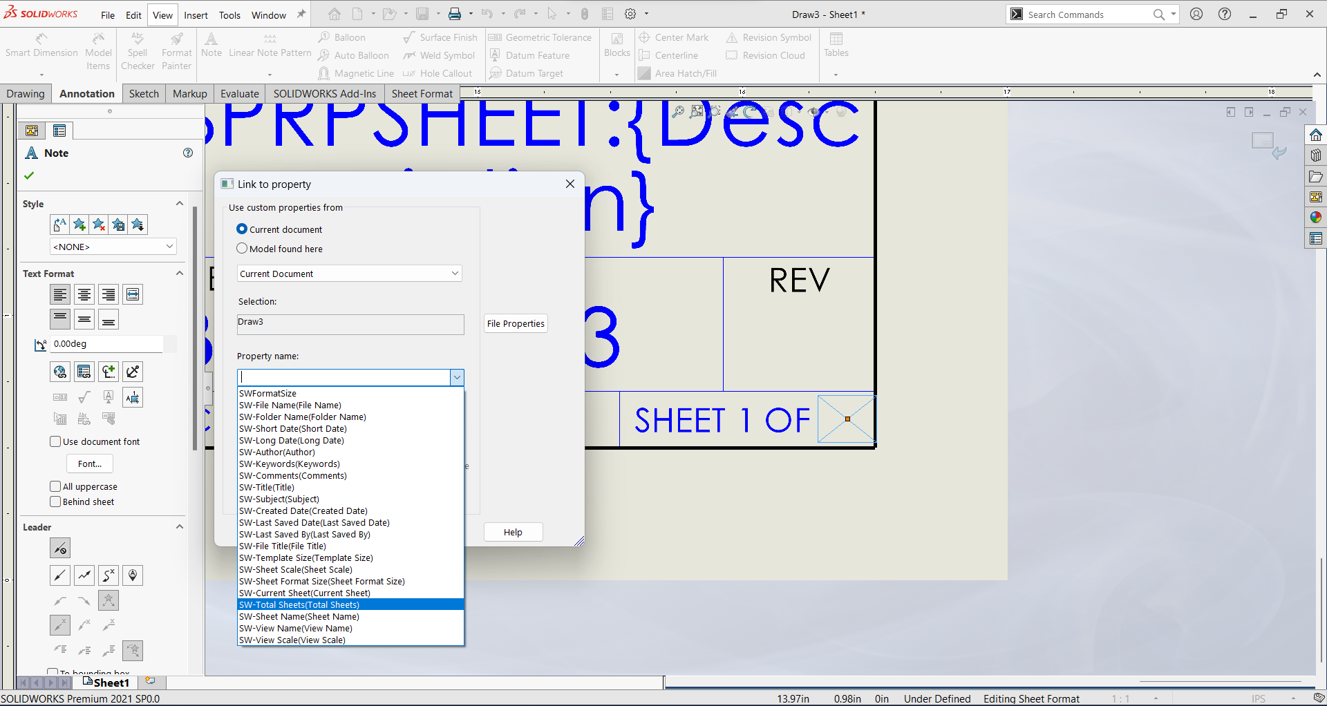

3) THEN CLICK ON THE NEWLY CREATED TEXT BOX AND THE SELECT LINK TO PROPERTY IN PROPERTY MANAGER, AS SHOWN IN IMAGE.
4) UNDER LINK TO PROPERTY SELECT "TOTAL SHEET" OPTION IN PROPERTY NAME TAB.
