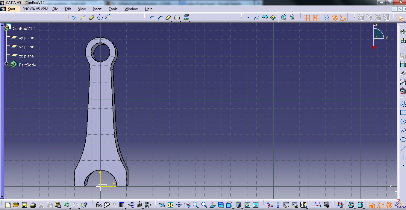

How to change "pan mode" in Catia V5? Grigorios Ermidis 24 Aug, 2012 06:45 PM When in Part modelling and sketch bench when i pan the sketch it opperates as having escaping lines etc giving me different views when moving it. It even changes when i zoom in and out so i guess it's not only a pan matter. So how do i change that? lokolo.jpg 3 Answers Grigorios Ermidis Answered on 24 Aug, 2012 07:28 PM problem solved just cant figure out how to remove the q yet :/ Sayan Dey Answered on 29 Apr, 2017 02:27 PM Im facing the same problem . Could u tell me how to fix it ? BIVIN K THIMOTHY Answered on 21 May, 2018 06:06 PM View-Render Style-Parallel Change the perspective to parallel in Render style in View.
