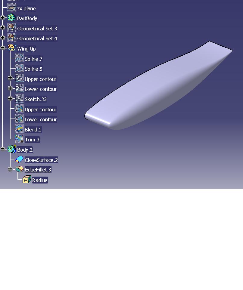

its me again, friend!!! BINGOOOO!!! to this issue!!
I attach you the image, to close your profile,
let me take me some minutes to writte the procedure, step by step to close your surface.
Have a good day,
best regards,
I think i found a solution. you have to split the curves, then use multi-section command and fill with tangency. Finally check the tangency continuity using a join with tangency
