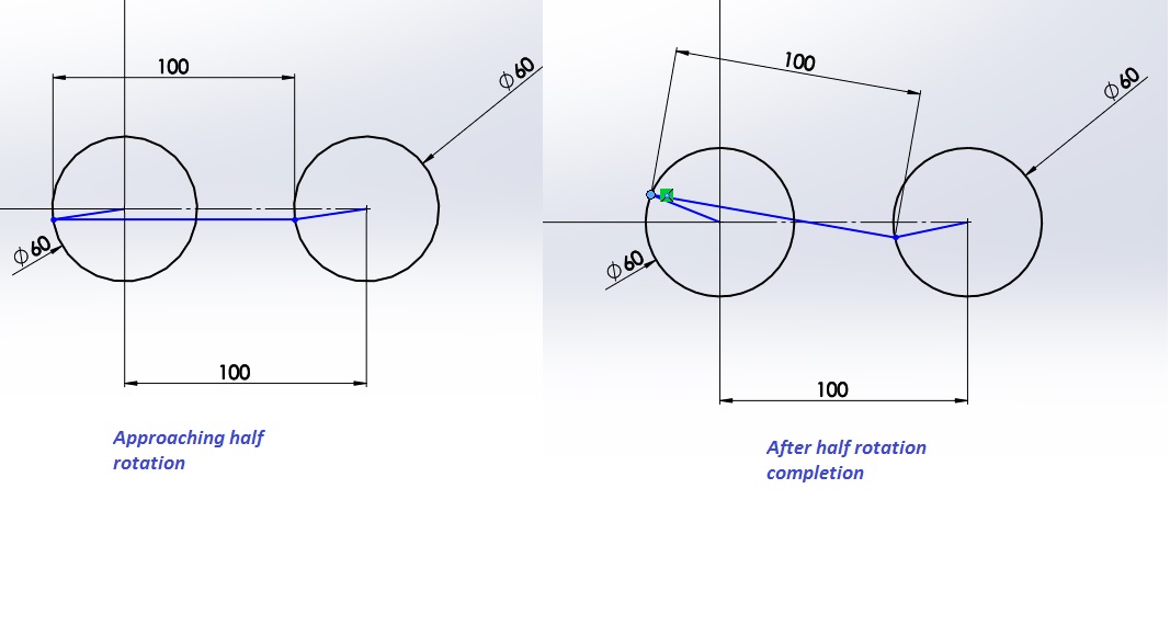

How to complete full rotation of connecting rod shown in the attached figure ? Mohamed Irfan 4 Dec, 2015 03:09 AM I want to transfer the complete rotation of the left crank to the right one with the help of connecting rod. I have made a representation of it in the attached pictures. cranks with connceting rod2.jpg cranks with connceting rod.jpg 1 Answer Roger Couture Answered on 21 Feb, 2016 06:40 PM Did you try to adTry adding a parallel constraint between two short segments or between two long segmentsd a parall
