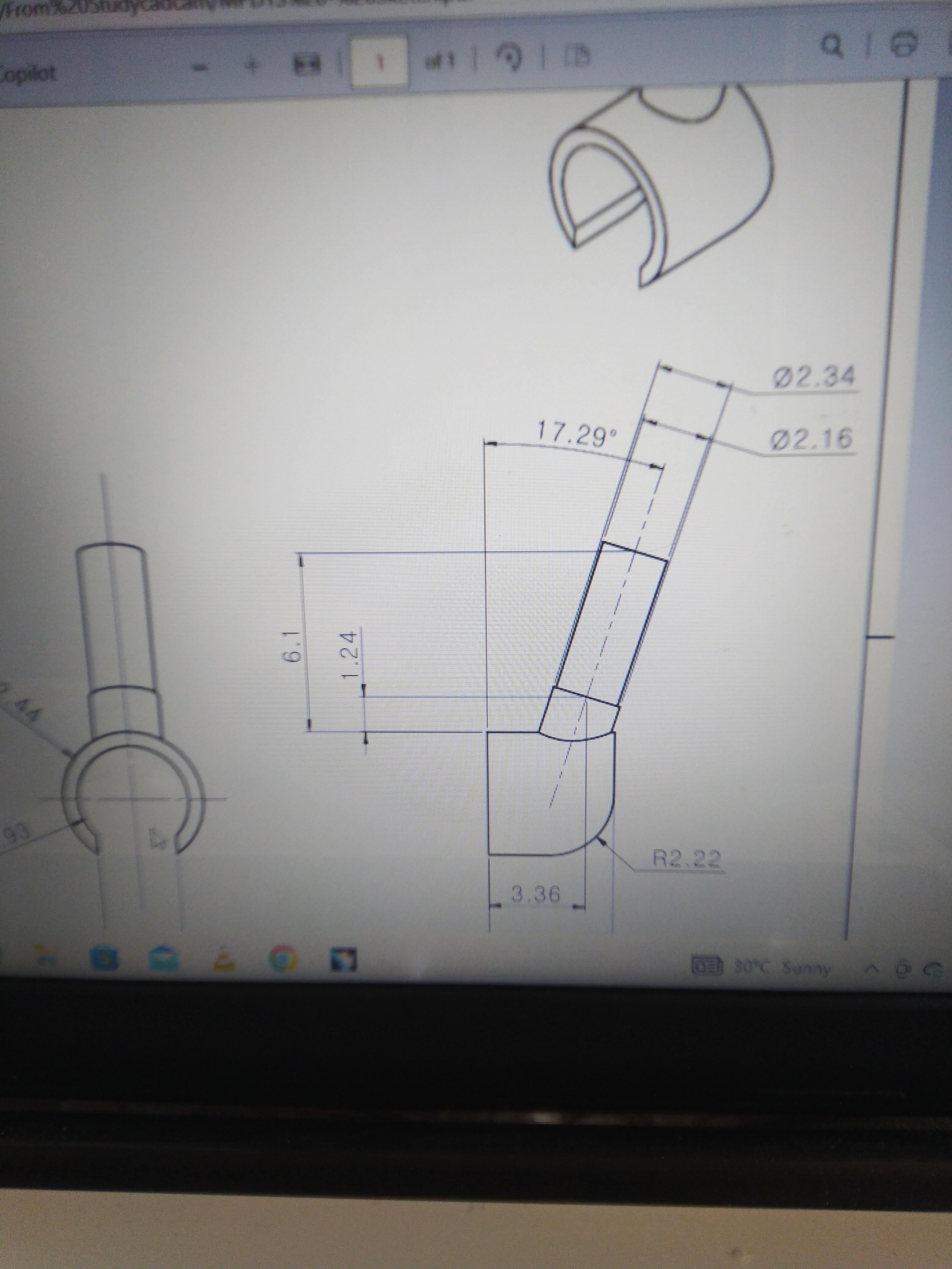

how to create angular 17.29 pad in catia Mukilan K 12 Aug, 2025 05:19 PM cant create the angular surface 17416760414416324615792445549923.jpg 2 Answer Jack K Answered on 12 Aug, 2025 11:17 PM After you make the bottom R44 piece, make a sketch in the vertical, center plane. There you can draw the 17.29° centerline based on the 3.36 and 1.24 dimensions. dheeraj reddy Answered on 26 Aug, 2025 07:04 AM use the sweep option, draw a circle with desired radius and draw the path perpendicular to cirlce in which the angle should be
