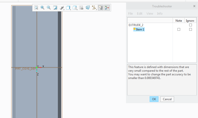

how to create tyre model on creo?
im sketch the rib pattern , its fully constrain but im going to do extrude that not to be working. see my attachment file. anybody do the answer shortly.
2 Answer
make one plane on the surface of your base extrude. apply extrude command on that new plane. if that doesn't work then make a distance plane from surface, put distance of your extrude grip on tire, start design from new plane and extrude till surface. one of this option will works perfectly. if you will try to do extrude directly from the surface, it might b fail because of tangent face of main body will not attach properly with your new extrude.
1. Click File > Prepare > Model Properties. The Model Properties dialog box opens.
2. Click change in the Accuracy line. The Accuracy dialog box opens.
3. Select Relative or Absolute from the list.
4. Select a Specify accuracy by option:
◦ Entering a value—Type a value or accept the default value.
◦ Copying value from model—Click Browse. The Open dialog box opens. Select a part from which to set the default value.
5. Click Regenerate Model.
