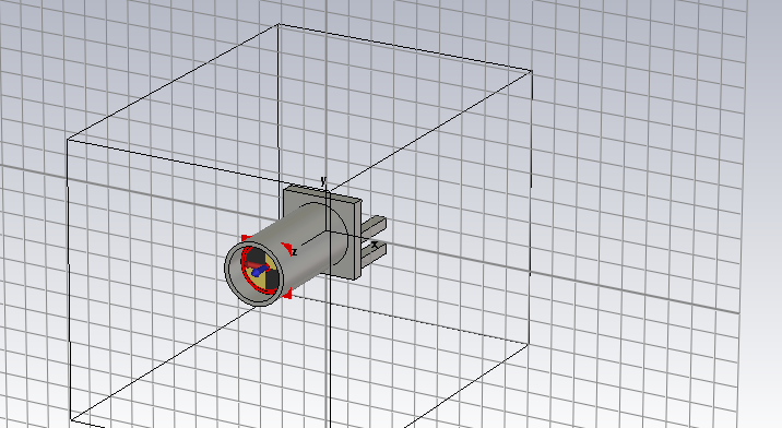

how to excite a SMA connector using waveguide port in CST for an imported CAD model SMA connector?
I have designed an 10Ghz Rectangular Patch Antenna. For that I have used an SMA connector which is imported as an STEP/IGES file. Now the problem is I couldn't achieve the S-Parameter due to the improper excitation of waveguide port. So kindly let know where the waveguide port should be placed in order to achieve the S-Parameter.

Well if you’re not de-embedding you want that port to be defined over the coaxial back of your sma, and normalized to 50 Ohms.

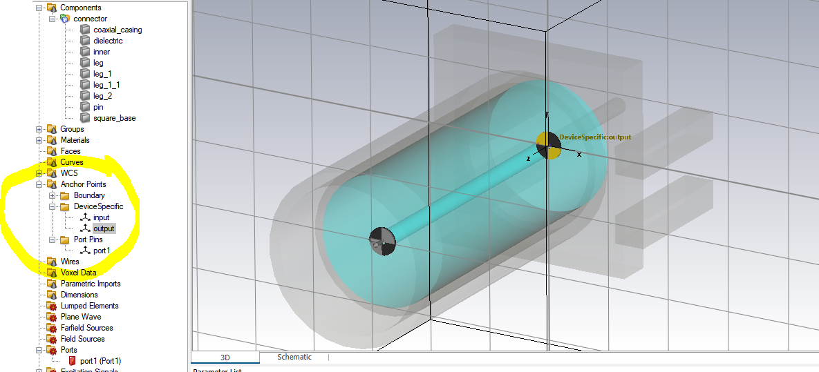

Exist in CST an app named Antenna magus that have sma models with the port placed like the picture that I attached.
