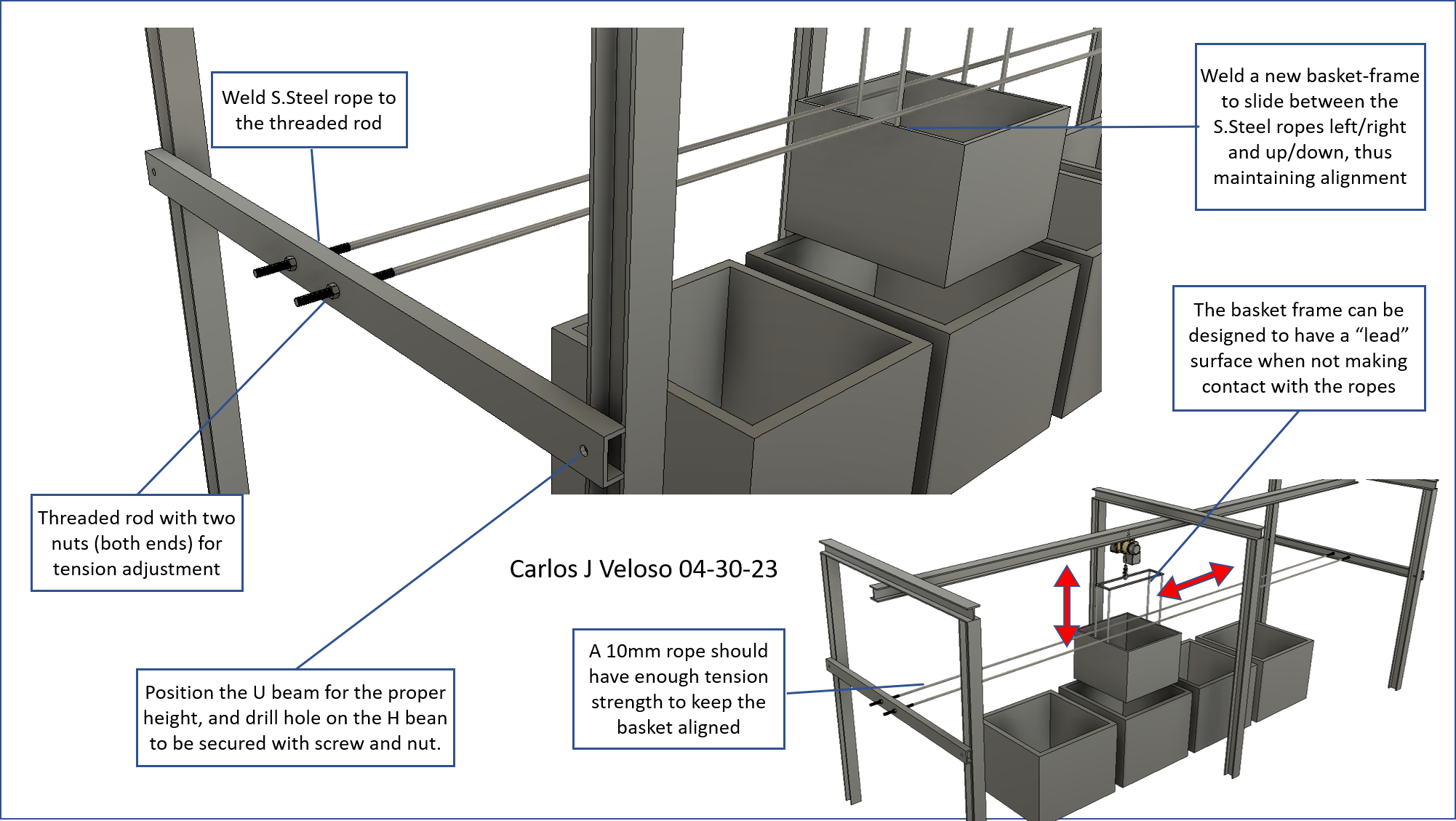

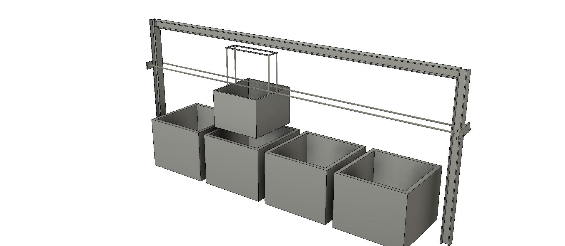

Here is simple and inexpensive method. Add two stiffed S. Steel cables from bean to bean, modify the handles of the basket. It is only a general idea, it requires work on the basket handles for guide on the up motion of the "Z" axis movement for alignment. You can attach sensors on the cables for your PLC Control system.
If you had plans to use a PLC Control, you should have implemented a motorized rack and pinion system on the "Z" axis, or a pneumatic system, or a screw system. Good Luck

See the image, the new drawing and the explanation should cover the original simplification. Good luck.
