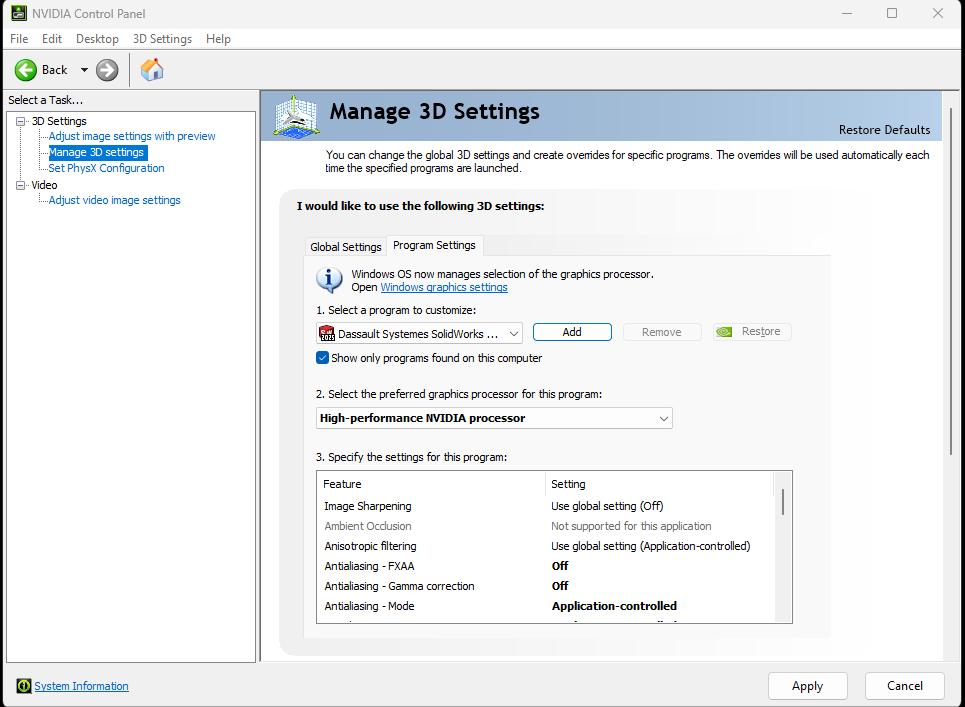

Do you also have a integrated Graphics card? in my laptop I have both. I had to go to the NVIDA Control Panel (right click on desktop, select more options, then select the NVIDA control Panel). in the left hand window select Manage 3D Settings. the primary window select Program settings tab, add in solidworks and then select High-performance. Attached is a screen shot.
One thing that helps is ensuring that “Use software OpenGL” is unchecked in the performance settings, as it can sometimes restrict GPU use. Also, make sure the RTX drivers are up to date and that your NVIDIA Control Panel has SolidWorks set to “High Performance NVIDIA Processor.”
