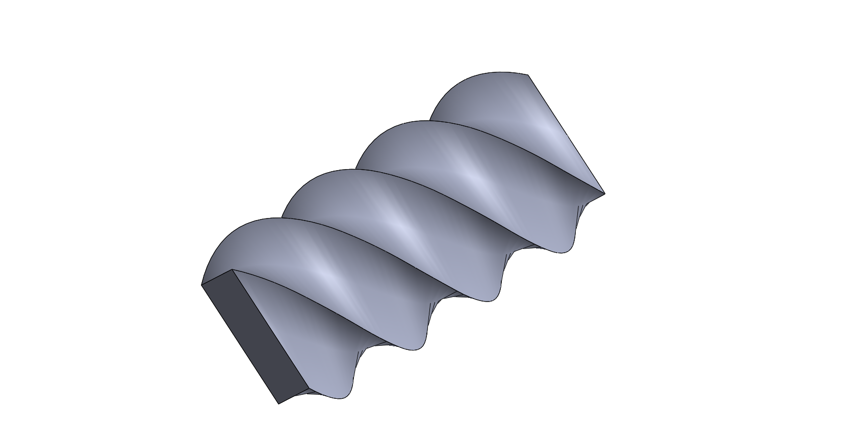

I think a better, quicker way is to make a Swept Surface that can be closed as a solid later.
- the 7x7 square is the profile
- use Explicit profile option
- With Reference Surface (use a plane)
- the Guide curve will be an 18mm long line normal to the profile
- for the Angle, click the Law button and enter 0° to start, 6*360° to end, and choose the S-type
- the spine will the 18mm long line

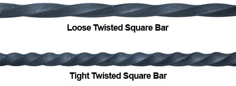

Can you better define "6 times"?
I read that as six revolutions (2160°) in the span of 18mm. The result looks more like a threaded bolt than the example you show.
A screenshot with 1 revolution in 18mm is shown
