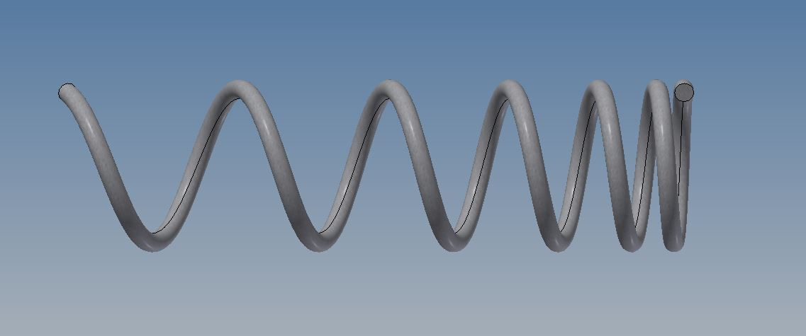

How to model a helical coil with different pitch nasir 25 May, 2020 06:40 PM How to model a helical coil with different pitch in inventor Thanks about your answers 2 Answers Danny Key Answered on 27 May, 2020 06:27 AM Hoi Nasir, I wil attach a file as example and a pdf printsreen. I think you mean somthing like that. Example is Inventor 2020 Greetings Danny HelicalCoilWithDifferentPitch.ipt helical coil with different pitch.pdf Bob Wiley Answered on 28 May, 2020 01:30 PM Or do you want it variable pitch like this? variable_pitch.png variable_pitch.ipt
