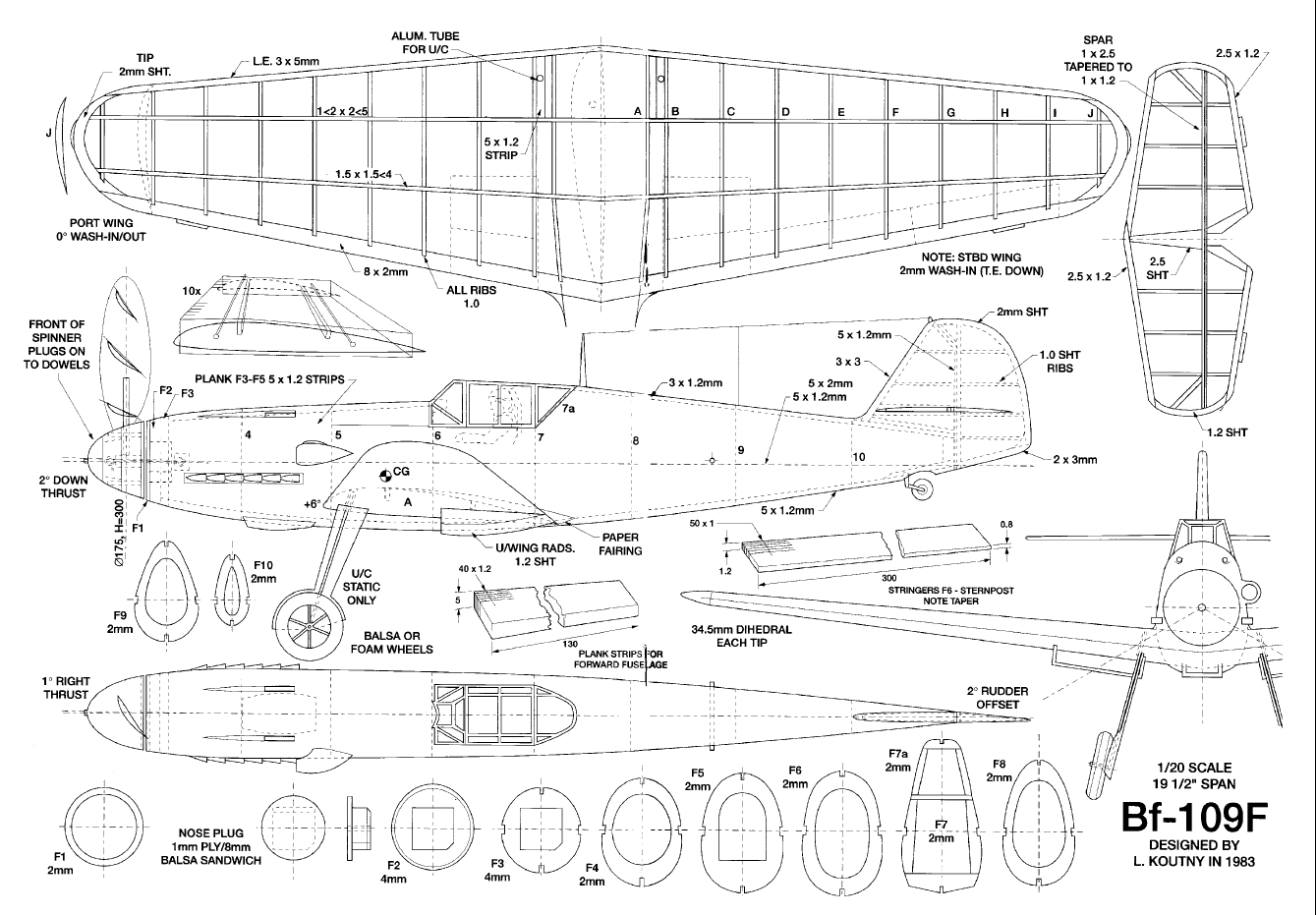

How to model a scale aircraft model in SolidWorks?
Using 3-views and sections? I mean other type af aircraft (like de Bf109, Extra 300), not airliners.
5 Answers
I'd insert the image, scale it, and trace over it for each of the fuselage bulkheads. (Start a new part, new sketch, Tools menu, Sketch tools, sketch picture). Extrude for form solids.
Use the Move/Copy command (Insert menu, Features) to position them correctly.

Thanks, I know this one. My problem is with the fuselage.
I'm working on this tutorial. Have a look
https://www.youtube.com/playlist?list=PL9HaQnX7ItVFirI5X5r4llTKctg5RXzjl
This will help you to know the approach.
Thank you! In the meantime, I've done some models using the same technique you are using, more or less.
