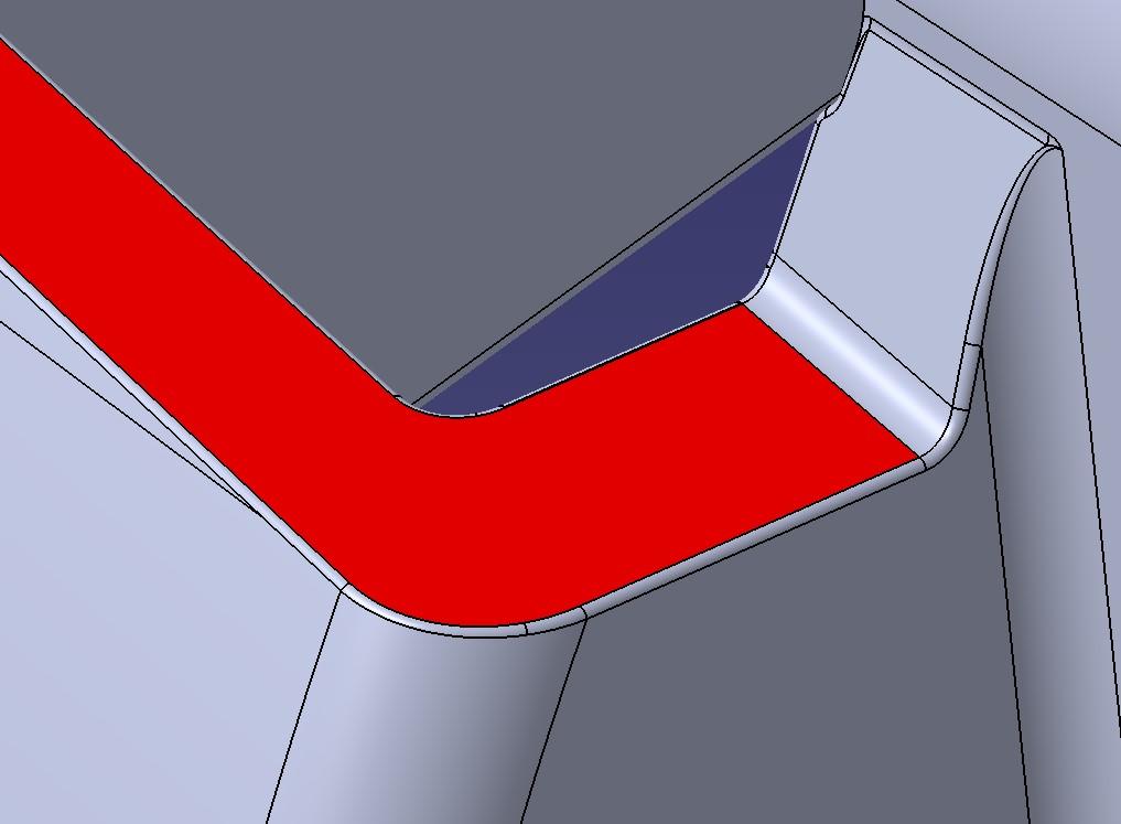

How to move a surface of a part that has fillets on its edges hoso okhovat 20 Apr, 2021 11:00 AM I want to machining the surfaces that are red in the part by 2 mm, but because it has fillets on the edges of the part, this cannot be done with the Thickness command in catia. please help me for do this Thanks Screenshot_2.jpg Screenshot_1.jpg 91106-rev2.STEP 2 Answer Jack K Answered on 20 Apr, 2021 12:02 PM There are so many ways you could do this. One way is to Deactivate the Fillets so you can do the Thickness. leandro nishimaru Answered on 20 Apr, 2021 04:39 PM is it a flat surface?if it is, make a pocket
