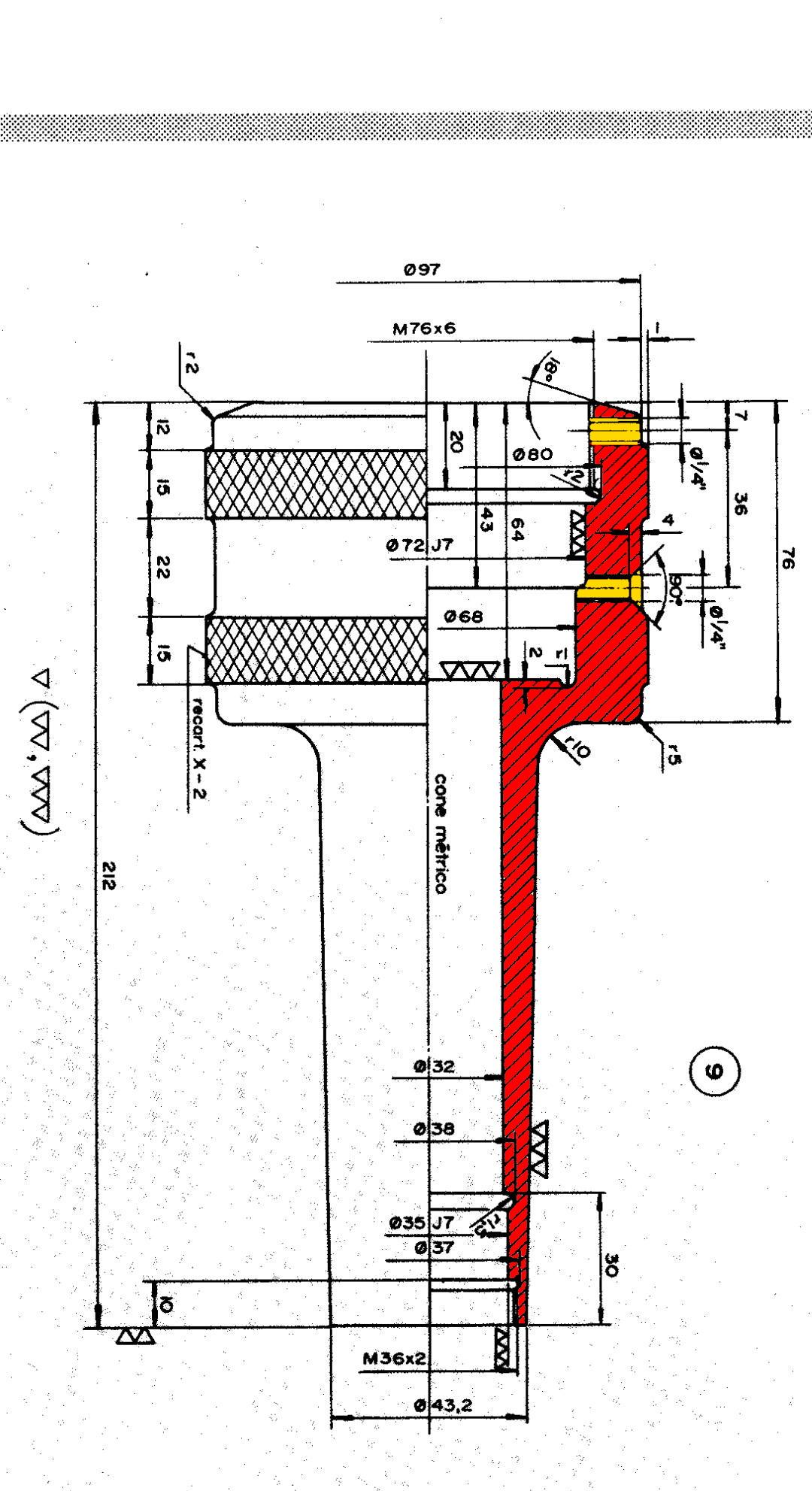

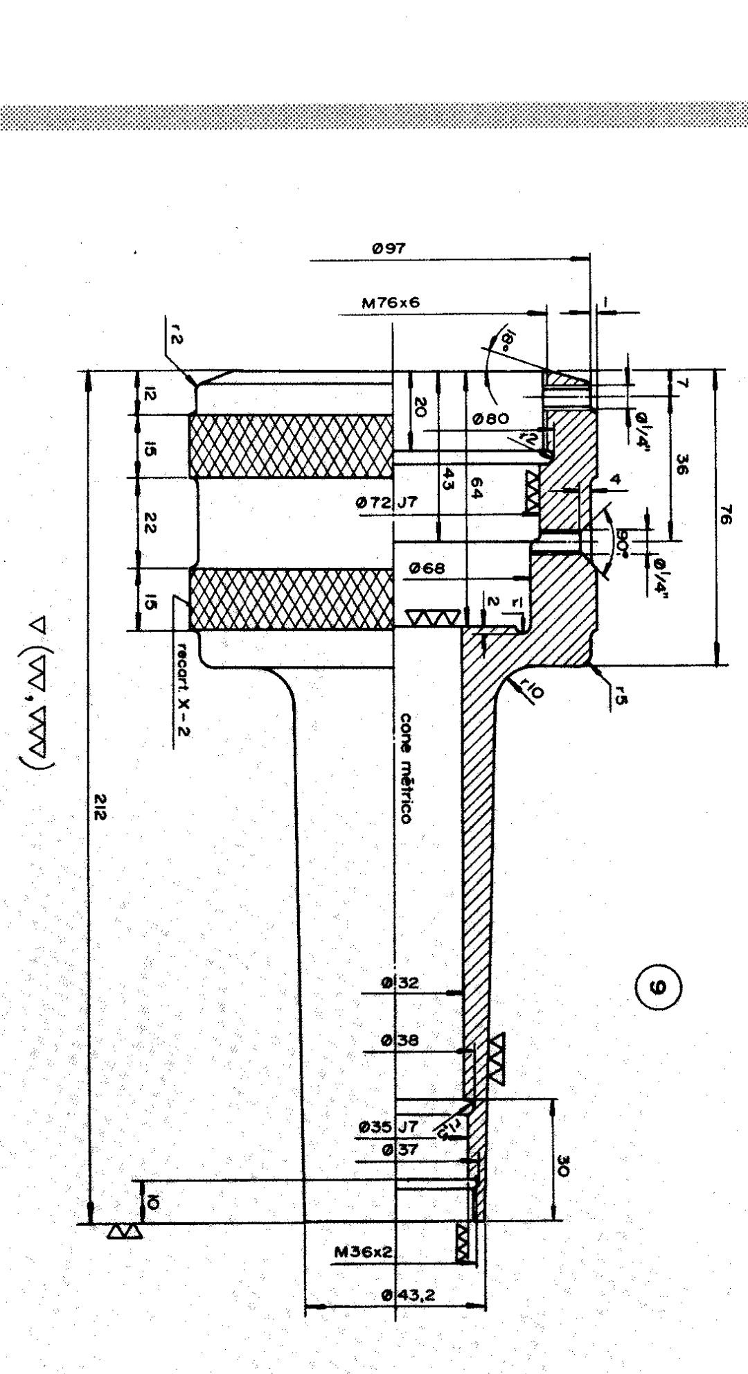

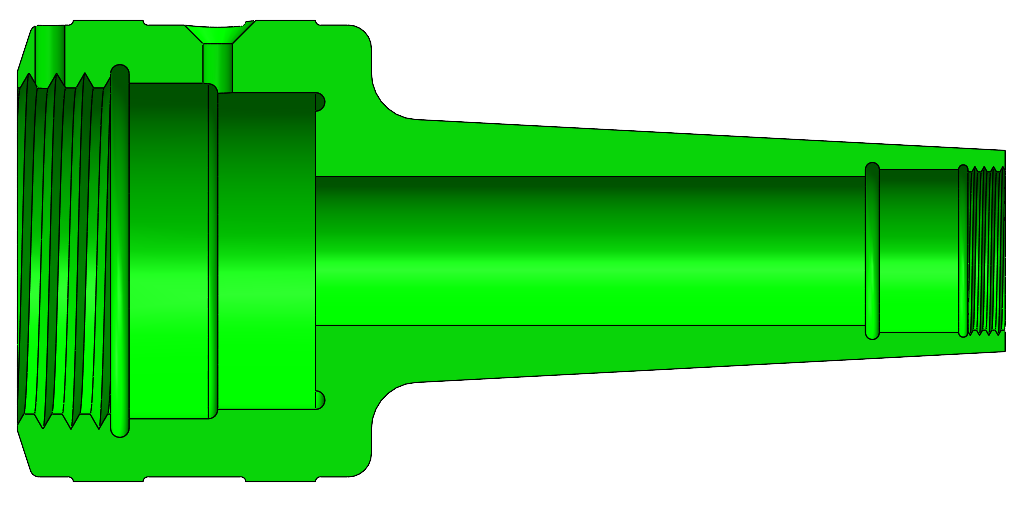

I couldn't do this exercise nanks da sensi 10 Nov, 2021 03:02 PM Can someone do and send the file here please? Screenshot_20211110-115923_Drive.jpg 2 Answers Steven Kiley Answered on 10 Nov, 2021 04:39 PM As stated, I'm not going to do the work for you, but the proper way to do this part is to draw the profile of the section view and revolve it around a centerline. See attached. original (1).jpg original.jpg FredSWUG Answered on 11 Nov, 2021 12:01 AM I don't see a dimension calling out the taper. Anyone see it? Tip.png
