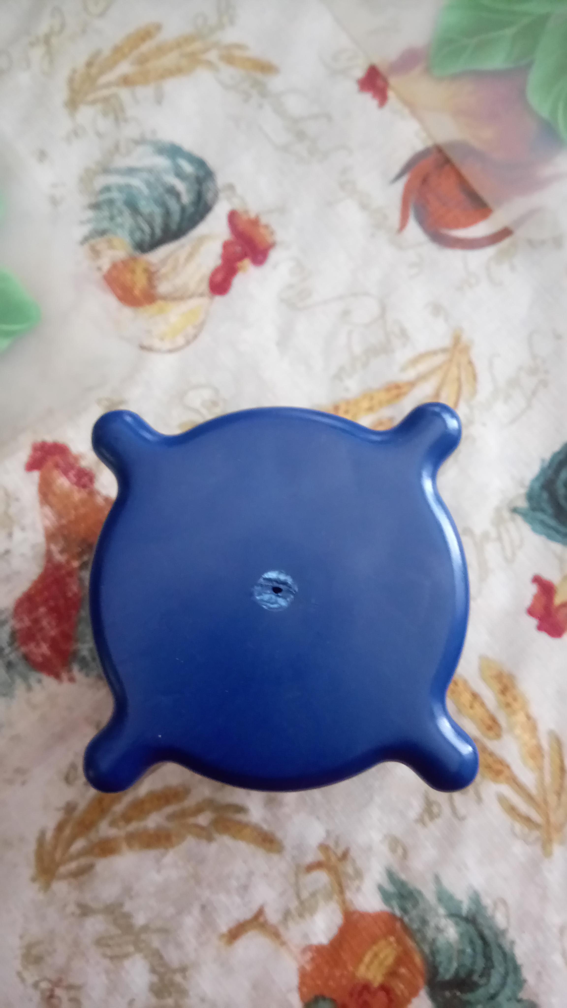

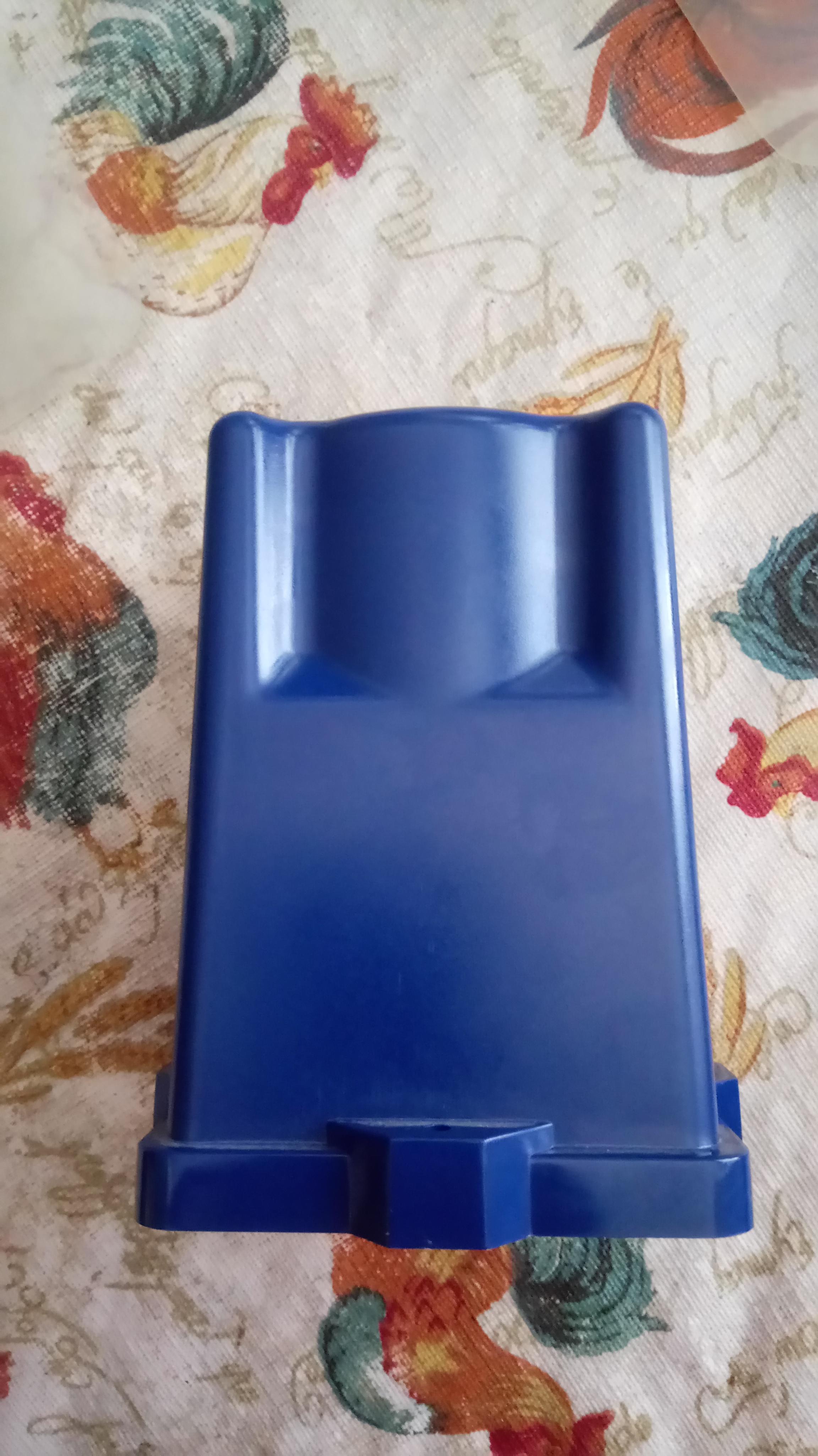

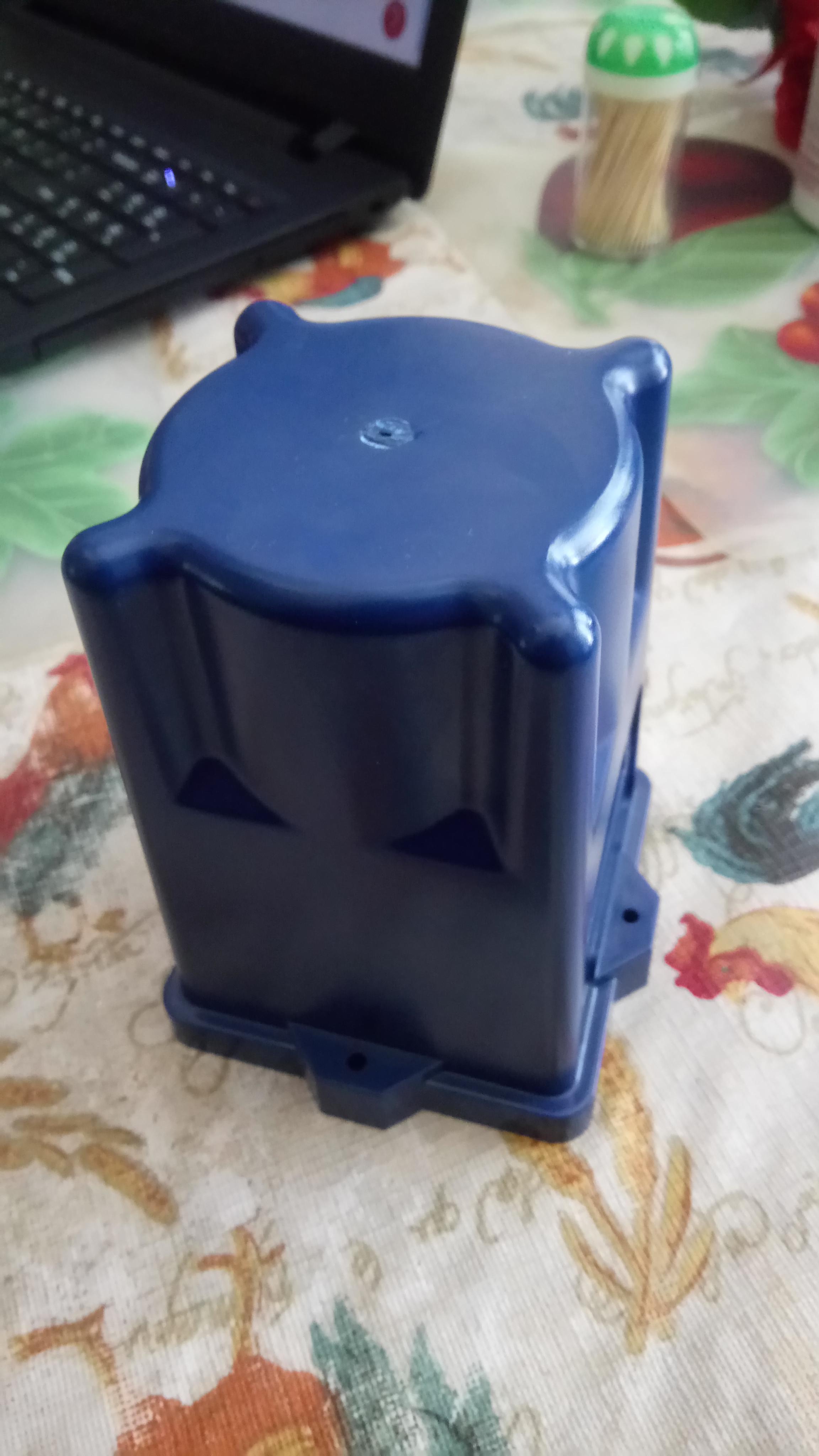

I need help making this shape.
I've run over it multiple times, but I still can't get it right so I gave up. I really need help with the top part, where there are intersections between what looks like two extrusions. That's the part I really need help with.
The extrusion angle being used is 2 degrees, don't care about size.

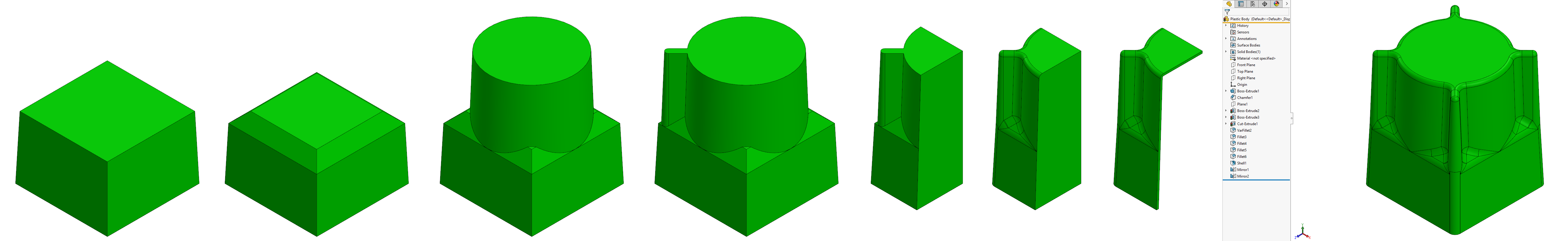

It looks like a square extrusion, a chamfer, a circle extrusion, then an "X" extrusion to make those little "wings". Finish it off with a fillet.
If you post your SOLIDWORKS model, it will be easier for someone to see how/where it isn't working. Otherwise we have to re-create everything at an unknown scale.
Help us to help you by uploading what you've already tried.
I'd make it something like this.
Some extra work may be needed to smooth the fillets, but this seems close.
